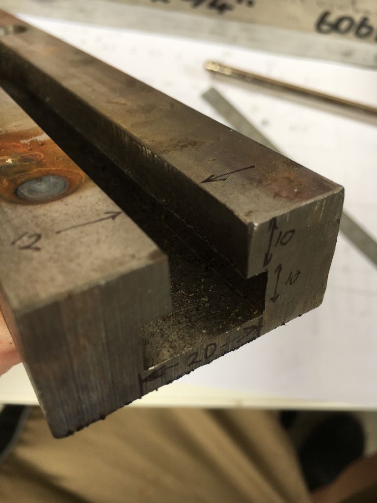

                      Hmm, I suspect you'd be surprised what you can actually manage if you do a few tests. The worst that could happen is you might break a cutter or two and / or soil your pants – and where's the harm in that?
                      I did a test cut in a piece of hot rolled steel with a 12mm 2 flute HSSCo end mill and a 20mm HSS tee slot cutter some time back. Given that the tee slotter was obviously going to have to cut full width in one pass, it seemed reasonable to expect the end mill to do similar or arguably better. This is on a Bridgeport clone, which is hardly a super rigid machine.
                      2 passes of the end mill (10mm per pass) followed by a single pass of the tee slotter. Power feed (to ensure a steady feed rate) and coolant (keep the tool cool).
                      Murray

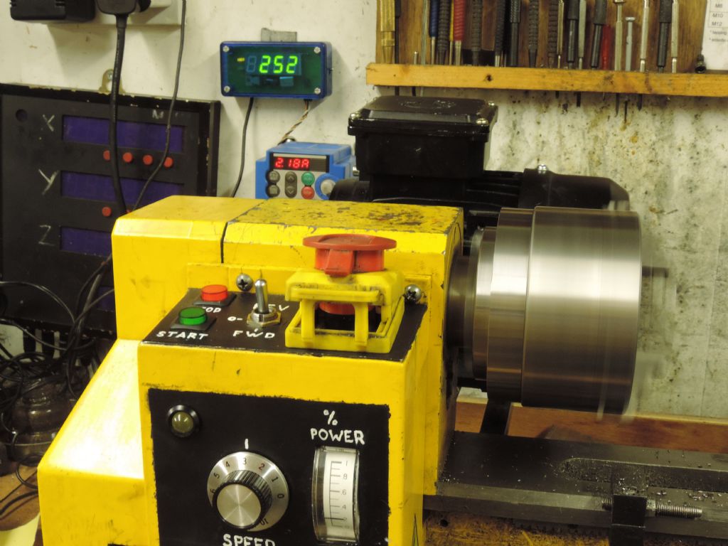

                                            Not quite 100hp, but the inverter on my mini-lathe can monitor power use, so I have an analogue meter on the front that shows percentage rated power (misleadingly I have it set so that 0-1 is 0-200%).
                                            <edit> as you can see spinning a 4" chuck, unloaded, at 242 rpm (on tacho) takes 2.18 amps (on inverter) and is about 40% of output power (on meter readout).
                                            Edited By Neil Wyatt on 21/02/2018 07:59:41
