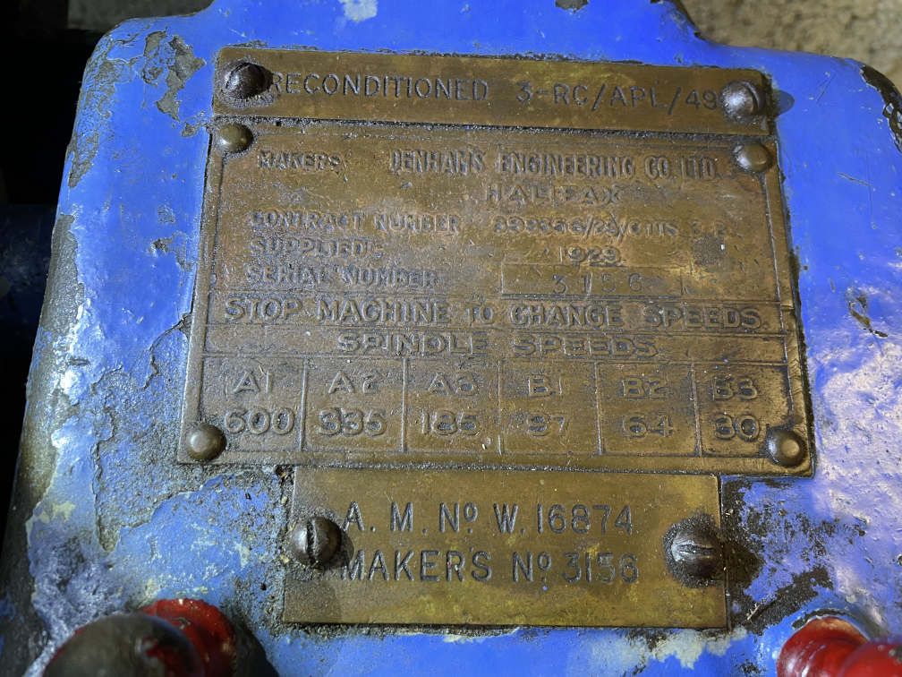

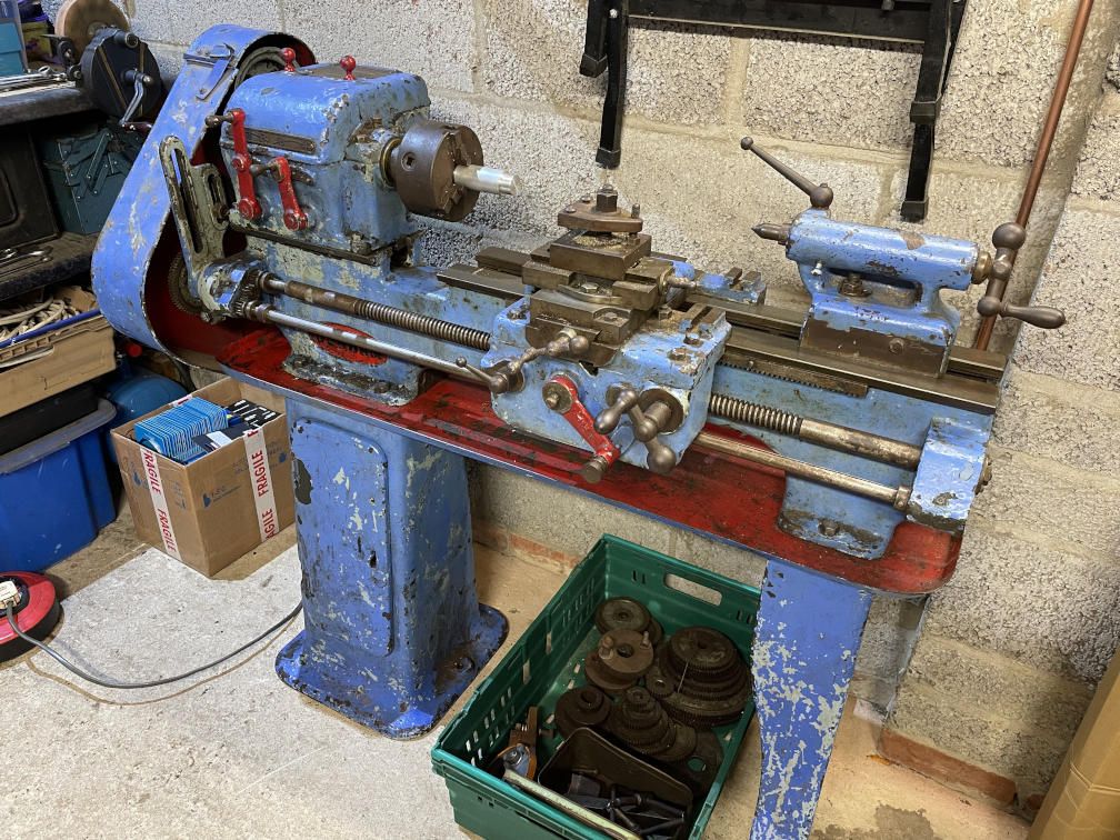

      Hi. A new lathe owner and first post on the forum.
      After a few years on the lookout for a lathe, I took a punt on a old Denham that was fairly local to me. The price seemed reasonable so bought it sight-unseen. From what little research I’ve done, it’s a Denham Junior Mk1 made in 1929 and according to the info plate, reconditioned in April 1949. It’s somewhat rough but overall it seems to work so the plan right now is to restore it into a good a working condition. Basically just go through it, clean and repair anything that needs it and give it a coat of paint.
      Is there any fellow Denham owners on this list who can share their knowledge on this model? I’m also looking for any documentation: Service manuals, operating manuals, parts list etc that will help with the process.

            I expect that "AM" is Air Ministry.. I have a Denham DL6 or 7 (I can't remember which. It is quite slow and TC insert tools are not supposed to work with it. They do! Productivity is significantly improved with 2 axis DRO.

              Likely it was thoroughly worn out during the war years when it would have given sterling service for the war effort.
              It may be due for another reconditioning, but likely still in fine fettle, the only drawback is the speed range – but keeping the speed down would have made it so long-lived.
              Modern lubricants may allow that range to be extended, but better left as it is. Some TC cutters will work very satisfactorily – the polished ones designed for cutting aluminium at high speed are good with other metals if care is taken with their use.
              That it has a separate power feed shaft (not using the lead screw for that duty) sort of demonstrates the quality of the machine.
              I would say that looks like a good starter machine, although some on the forum would always recommend a new (chinese) machine. It has clearly stood the test of time. Enjoy.

                It looks like it could clean up really well
                A DRO as mentioned makes life much easier with those old ladies

                  Posted by John ATTLEE on 10/11/2021 20:34:16:
                  Hi John,
                  The guy I bought it from did say it was likely from an air base up in Lincolnshire. I'm assuming it's the low speed that's the issue with using inserts? It didn't come with any tooling so I was going to purchase some 12mm holders (the height from the post to centre looks to be 1/2&quot. HHS would be nice but I don't have the skills yet to make them (or even a suitable grinder).

                    Posted by not done it yet on 11/11/2021 09:58:58:
                    The gear head is what drew me to it over some of the belt drive models, more like a mini Colchester student (the only lathe I've ever operated). It all looks original going by period photos I've found. It could look quite smart with new paint. It's missing an on/off control, you just plug it in to start it which seems a bit sketchy from a safety standpoint.
                    Do you know anyone on the forum that has a mk1? There's so much I don't know, like how much oil it takes, what taper fitting the tail stock is, etc.. I'm also worried about breaking something that cannot be replaced when stripping it down. Having some documentation would really help. There's a little history on lathes.co.uk but not much else.

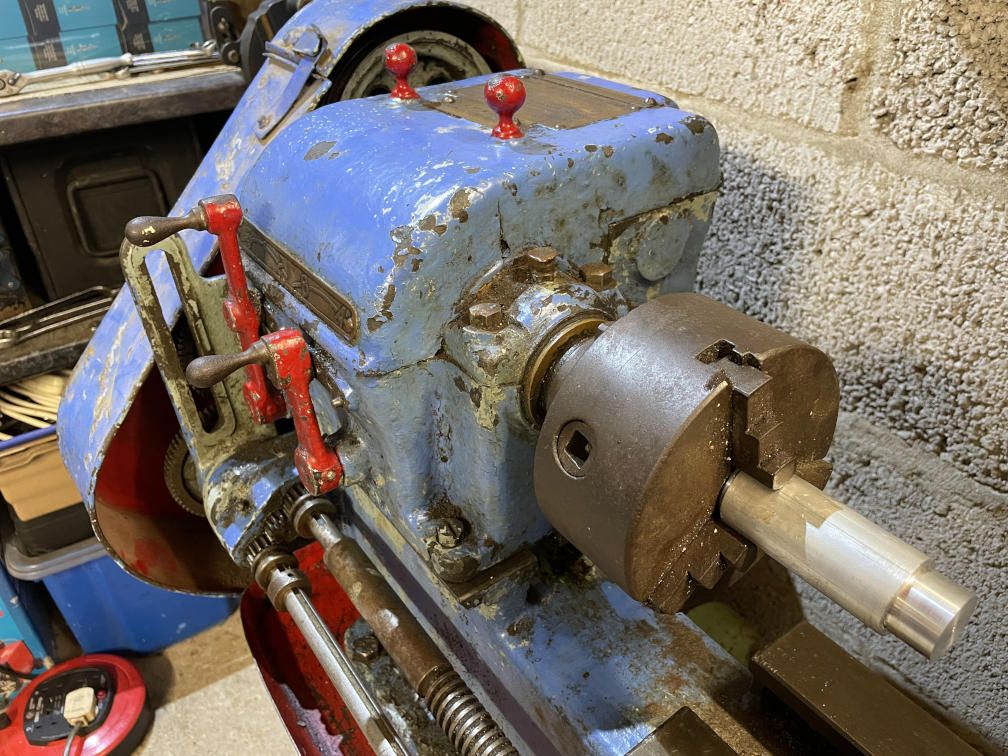

                        I suspect there will be an oil level plug in the side of the casing. Some old machines had a sight glass/tube or two taps – one for max level (allow oil to drain until at max level) and the oil level was OK if there was oil at the lower valve (when cracked open).
                        I suspect the level might be just above the teeth on the smallest gear on that intermediate shaft – to allow pick-up with all three gears on that shaft. It will also be below any potential leakage points – gear change levers and shaft bearings.
                        I expect the large gear will pick up, and splash, plenty of oil for the bearings or the oil will be picked up by the gear in the lower section of the box, at the left side in your pic. Unless there is a separate oil-slinger or pump (unlikely). Are there any oil channels in the top cover?

                            A kind member has emailed across a manual for the mk2 which from the look of it shares a few similarities with my mk1. There seems to be no fill-to mark on this version. I think it might just be trial an error. Shell-Mex R-1 no longer made so ISO 32 to 68 I guess, I use 32 for my compressor but seems a bit thin so might try the latter.
                            Lubrication is splash by the gears only, no pump. The cover has some channels but some oil holes seem to sit under sides that don't, very odd. Externally there are many oiling points, flat with a sprung ball bearing inside. Is there a special oil can that fits these? Not come across this type before.

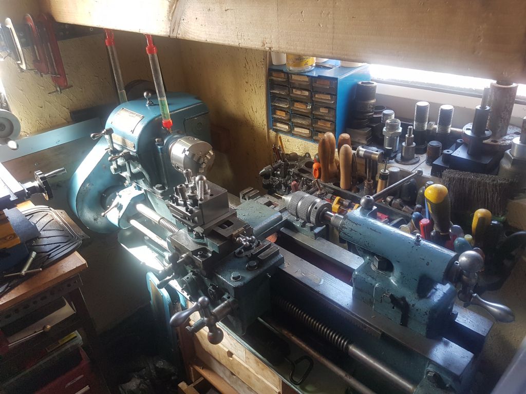

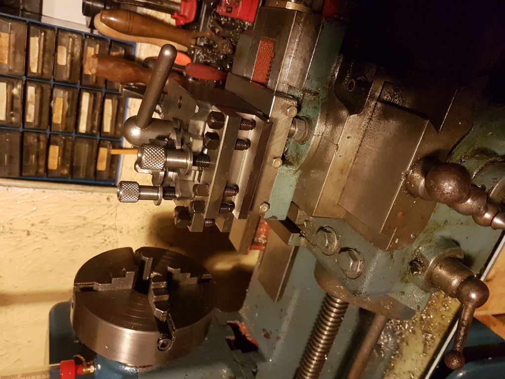

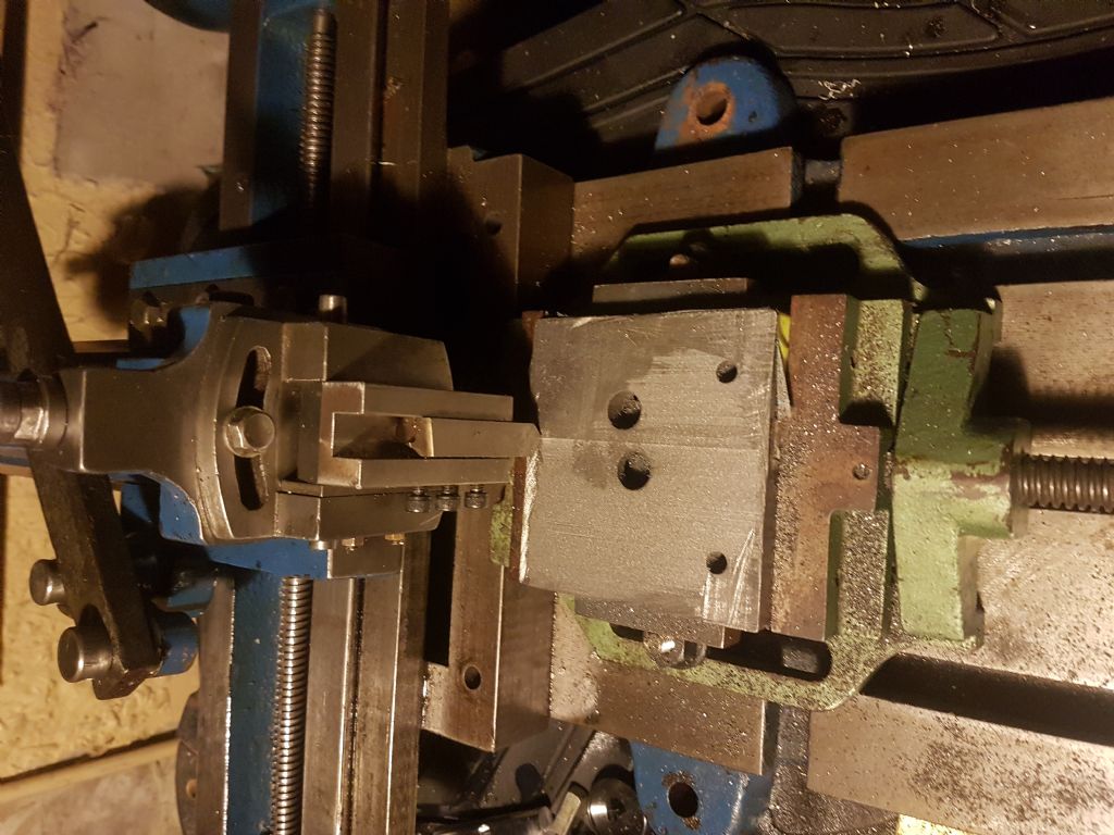

                              20180604_002228.jpgI also have an early Keighley lifts Mk1 lathe with the plain bearings.
                              Has been happy for some years now being fed ISO 68 oil. If a dial indicator is used to indicate a workpiece while turning the chuck by hand, you can see the small 20190521_112624.jpgdifference when the oil film is established & see the change as the spindle settles when rotation is stopped.
                              Although i did take approx 11mm off the topslide casting to allow larger tooling & fitted an adjustable height toolholder. Very happy with the lathe, but still need to add graduated handwheels at some point !20180529_222001.jpg

                                    Don't forget, it is a plain bearing lathe (like my Covmac), so it is essential to oil all the oilholes and cups before you use it, and don't forget the tailstock ends of the leadscrew and feed shaft! It looks like a lovely machine!

                                      Posted by Ady1 on 18/06/2022 10:11:49:
                                      Well done you, she looks much better now
                                      I'm afraid this is a different lathe than the one pictured by the original poster ! Mine was in quite good condition when i got it, so didn't need much work to get it working well. Other than having to use a 240v to 240v transformer to prevent tripping due to large inrush current on starting the motor.
                                      Maybe light blue was the original colour for the MK1 though.
