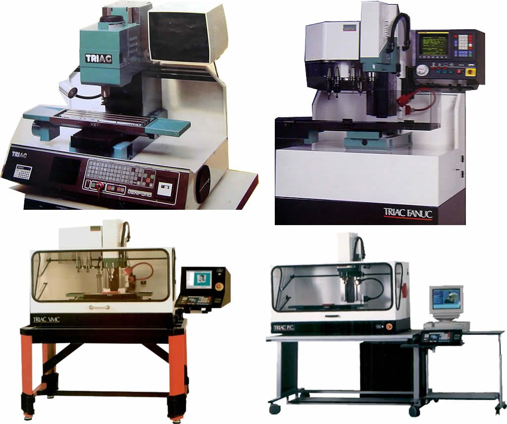

              triac range.jpgMark, check in my picture album where you can view some of the variants of the Triac, link below should take you there.
              http://www.model-engineer.co.uk/albums/member_album.asp?a=42512

                  Which of Emgees photos does it look like?

                        I have an ex-industrial Triac that is different to those shown above – it is on a twin pedestal base, with a removable swarf bin between the legs, with the gas strut balanced, full width lift up front guard. The electrical cabinet is full width across the rear on the pedestals. Control system was a Heidenhain TNC355 (operator station mounted on a swinging arm from the base), with brushless servo drives (can't recall the make, but not "main stream&quot to all axes. Spinde is BT30 with an Erickson locknut & no ATC. Spindle drive is a 2.2Kw squirrel cage motor directly connected to the spindle with a polyvee belt – it originally had an IMO inverter drive. The machine was bought in to scrap for the electronic parts where I used to work & I bought the carcass for £100.
                        The Fanuc Triac shown above would also have had servo drives – type dependant upon the exact model of Fanuc 0M fitted (the "A" models were analogue interface, "B" & " C" models were all digital & could only use Fanuc's own brushelss servos).

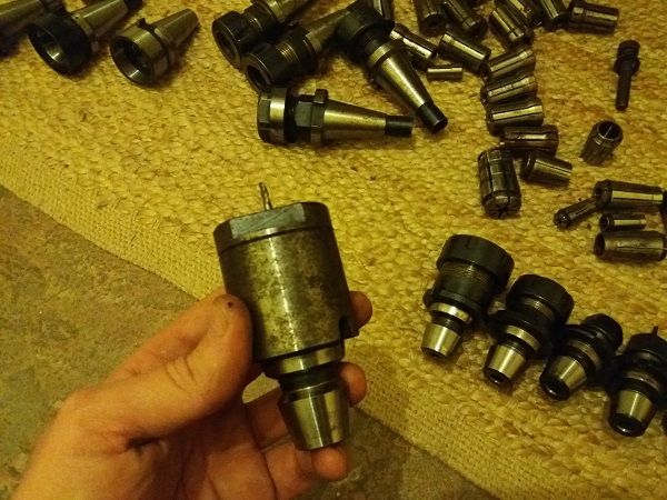

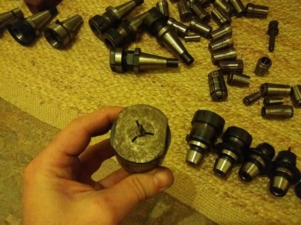

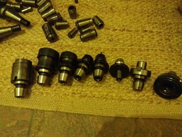

                                            Many thanks for the replies Nigel, David and Emgee, sorry for only acknowledging it now I've been a bit under the weather. Just as well Ive been lying in bed…those prices for the Easy Change toolholders are shocking!! I managed to get a few tooldholders with the mill however:
                                            It includes a ER32, ER25 and two ER16 collet holders, and a couple of other holders. A few hundred quids worth just in that lot! The owner was saying he might want something for the tooling…with those prices for extras I think I might consider selling them and making up some Tormach TTS style holders…it would work out cheaper in the long run I reckon.
                                            What do you think this is…I havnt had a chance to open it up and see what the collet looks like…but if its just a collet holder it seems a strange shape?

                                              Since I only had one easy change holder with my Novamill, I removed all the easy change stuff and instead substituted an ER collet chuck using the original manual drawbar.

                                                End nut style suggests that it could be a Clarkson or similar type holder for screws shank end mills.

                                                  The chuck you are holding is a Clarkson and the collets available in inch and metric sizes are for screwed shank cutters. Guessing size is for 6mm to 16mm collet range (6,8,10,12,16) or inch equivalent. Metric collets have a groove cut into the threaded head. Clarkson chucks provide a very secure method of holding the cutter, some may say the best.
                                                  The other tooling pictured is ISO type shanks but you said the spindle is R8 so will be surplus.
                                                  You seem to have a good array of Easychange chucks, at least enough to get started.
                                                  Collets pictured are DA type which makes me think your Easychange collet chucks could be for DA collets.
                                                  ER type collets are more universal as they have a gripping range of 1mm diameter.
                                                  I wouldn't bother with making tooling to suit Tormach holders if you have ER Easychange holders, you only need a few toolholders to allow multi toolchanges during a program.

                                                    I use easychange on my Bridgeport clone and have had no trouble at all. Mine has an allen screw that you can tighten if you are doing heavy cutting but I doubt you will be able to over work it with the Triac. It looks like you have a good selection of holders, So even if you decide it isn't for you, I'm sure it would make a handsome price on ebay (possibly enough to cover the refit. Personally I would keep it.
