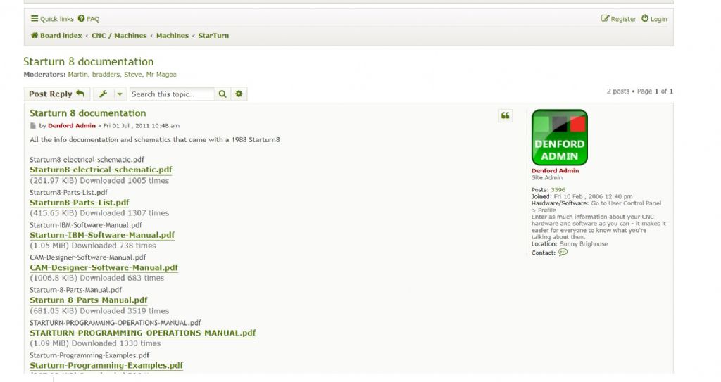

        Having drawn a blank with Denfords I am hoping that some one has a the documentation and software for a Starturn 8 CNC Lathe. 1987 year so is probably DOS based software. I would be grateful for a copy ( I will pay costs ) of the docs and software to get this machine operational. The Stepper drives are Digiplan SD3 and main motor is a Cheetah Anyspeed ASP~5 DC controller. The lathe is fitted with a tool changer.

              Have you been to this page ?
              **LINK**

                Just for curiosity’s sake, I tried your link … which [as posted] doesn’t work sad
                … somehow, an extra ‘http’ has crept into the address
                This should do the trick: **LINK**
                http://www.denfordata.com/bb/viewtopic.php?f=46&t=3376
                It looks an excellent find !!

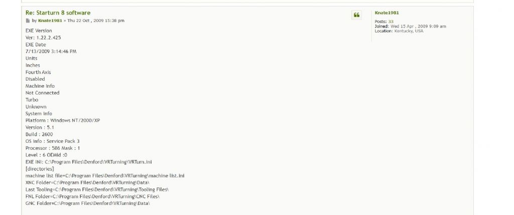

                      Michael, strange the link got corrupted, thanks for re-posting a working link. Same happened again when using the LINK menu, link when posted didn't work.
                      Andrew
                      Starturn 8 software on the forum at  http://www.denfordata.com/bb/viewtopic.php?f=46&t=2087

                        Emgee , your last link , amended by Michael G , http://www.denfordata.com/bb/viewtopic.php?f=46&t=2087 has a photo of boards in a machine that is only 6 months older than mine but they are all different from the boards in my machine. Denford MD , Steve , sent me that link as well but it was no help.
                        So far all the links that I have seen have not turned up anything that looks like my kit! My plan is to try and find the software that will run the lathe and then sell it , I would love to get stuck in and do a conversion to interface with Mach 3 but I have a loco that needs building and the Starturn is a distraction!

                              Just because the boards have a different appearance they can still use the same software, you won't know until you download and attempt to run the machine.
                              If you use the link it takes you to a copy of the software to run your machine, if you want an older version I can send that via email if you pm me your email address.
