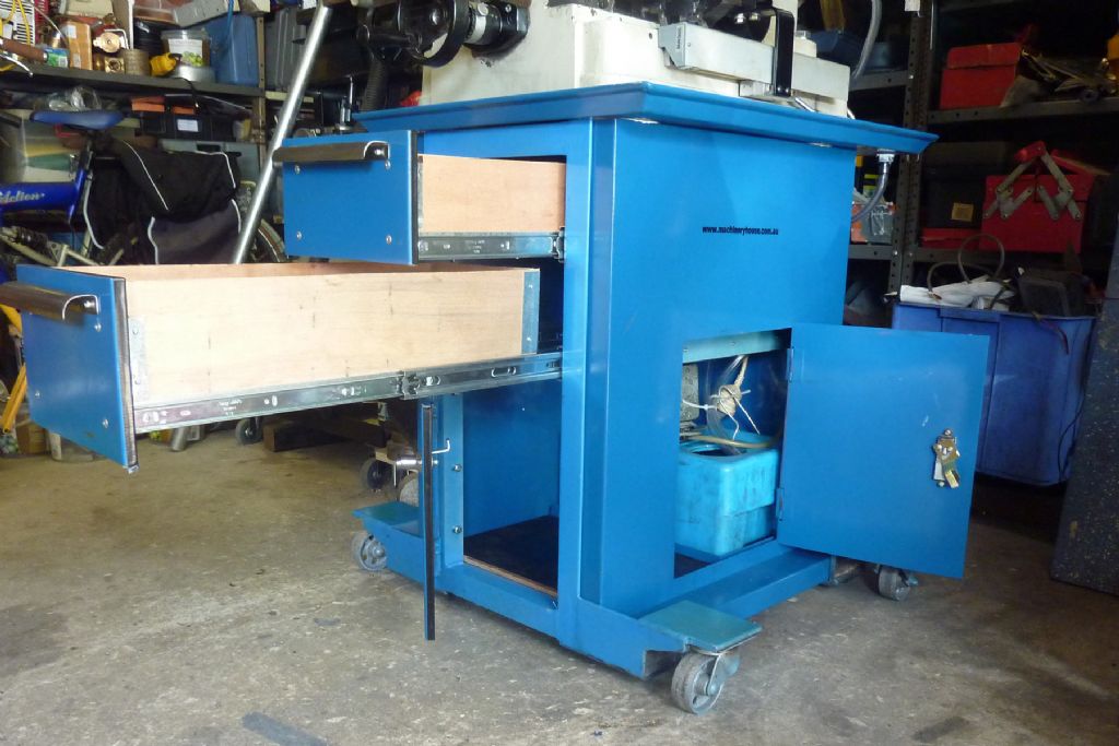

              The drawers that I used on the stand for my mill are a similar size to those that you want and use telescopic slides to allow full access to the back of the drawer.

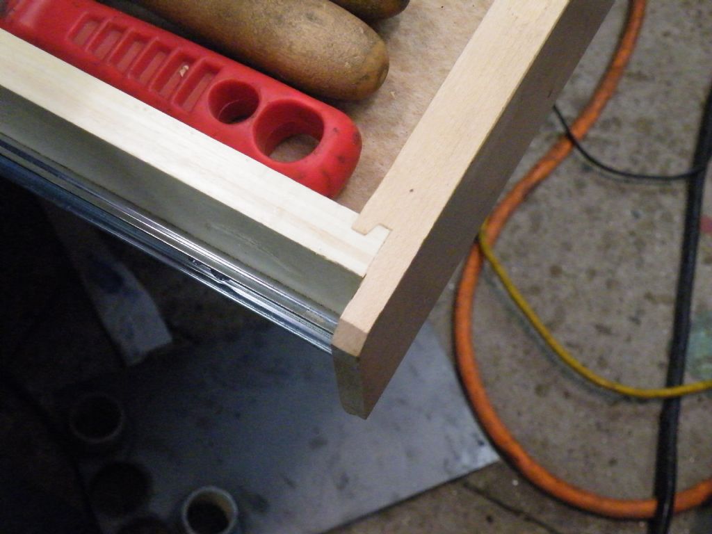

                I ended up making custom draws for my shed. Used 9mm ply for the bases, 15mm drawer-side ply for the sides (just because the wood yard had a load of it) and nice match cut maple for the fronts.
                The draws slide on ball slides, which are screwed to silver steel dowels. The dowels on one side are glued into side panels and on the other can slide in larger silver steel sockets that're glued in, to allow for differential expansion.
                All the joints were cut with a mitre lock router cutter:-

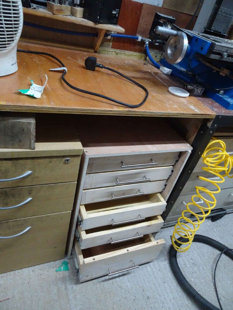

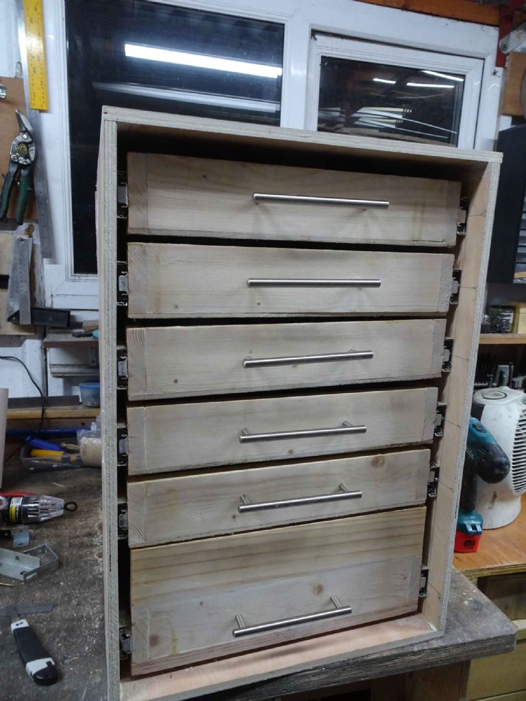

                                      Good news and bad news.
                                      Yes I did joinery up some drawers. Yes they do fit in the space as I expected. Yes the open and close without TOO much effort.
                                      (That was the good news).
                                      On the other side they're more than a bit wonky. I going to fallback to the second favourite excuse and blame the materials (though the author accepts that limited skill and experience hasn't helped.
                                      The ply for the carcass and planed timber for the drawer sides, carefully selected in B&Q for their relative straightness all turned into bananas when they got to my shed.and everything went all over the place. I ended up by putting it all together, loosening the top and letting the drawers find their own level.
                                      It's worked. I'm happy that it will do what I want, but I won't be putting it up for a show!
                                      And in their resting place…
                                      Yes there is a gap at the top and yes it is deliberate. Sort of.
                                      Tomorrow will be tidying up and then perhaps I can get back to messing things up with metal instead!
                                      Iain

                                                Iain, if you want to get your drawers more level next time, there are two things that will help:
                                                1. use spacers to set out the positions for the slides up the inside of the carcase.
                                                2. use drawer fronts that go over the basic drawers you have created. Screw these on (from the inside!) once you have got the drawers in situ, and even if you haven't got the slides perfectly level and evenly spaced the drawer fronts can compensate for this and completely disguise the discrepancies. Again, spacers (e.g. washers) will be needed to position the drawer fronts evenly. With a simple router, or just a block plane, and some sandpaper and varnish you can create very attractive drawer fronts that will give your cabinet a finished look.
