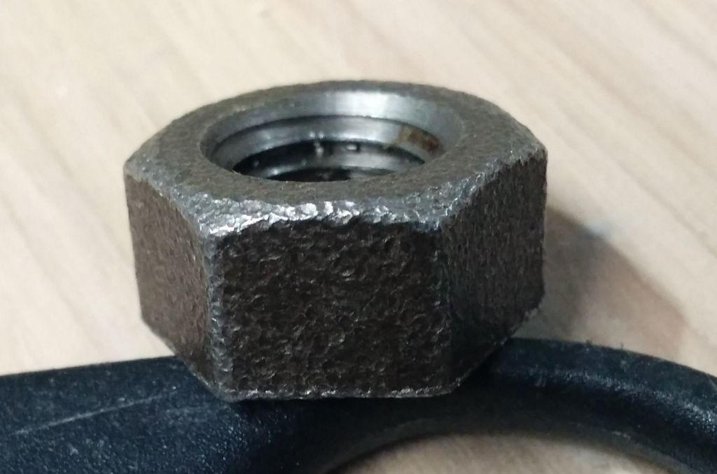

      Can't say I've seen this before, but doesn't anyone know how this decorative effect was created on this nut?
      Nut
      #25501
      mrbuilder
        @mrbuilder
        Does anyone know how this was created?

          Looks as if it's been shot peened,

            Or left in the bottom of a toolbox in a vehicle for years, and has bounced into everything hard in the box.

              If it is a decorative finish and not clened up after corrosion, it was likely tumbled in a mill with some hard, heavy, spiky tumbling media.

                  Without an idea of scale its hard to say if its is actually decoration. It looks like a well corroded part that has been cleaned and made shiny.
                  The nut seems a combination of processes. Has a tap been put through it after the surface was 'decorated'?

                    The top surface is smooth as if fitted to something, How about heavy corrosion followed by electrolysis de-rusting to get into all the crevices in a way that wire brushing doesn't.

                      It's a 3/8 BSF nut. Sorry should've chucked a rule next to it.
                      The look has kinda grown on me. My original thought was a clean up after corrosion but not really sure. Have five of them, all the same.

                          I used to make plastic tools for a plastic gas pipe fitting manufacturer and some had the same surface texture on the cavity done by chilled cast iron shot blasting on the moulding faces. We had to make a mask to protect the shut out faces as was likely done to the end and thread of the nut.

                            It seems to me that my favourite method of cleaning up rusty nuts and bolts – using a steel wire wheel on the buffer has been used here – witnessed by the rounding off of all sharp edges T. O..

                                When I replaced some missing nuts on some olf farm machinery the new nuts looled out of place. I have a bucket set up for electroliticly removing rust so I reversed the polarity and set it going for an hour or so, pulled the nuts out and wire brushed them and they looked just like the one in the photo, and just like the remaining old nuts on the machine.

                                    I think the likely scenario is that they've been tumbled with stainless steel shot, in a basket, maybe with a little bit of water to keep it cool and keep the dust down.
