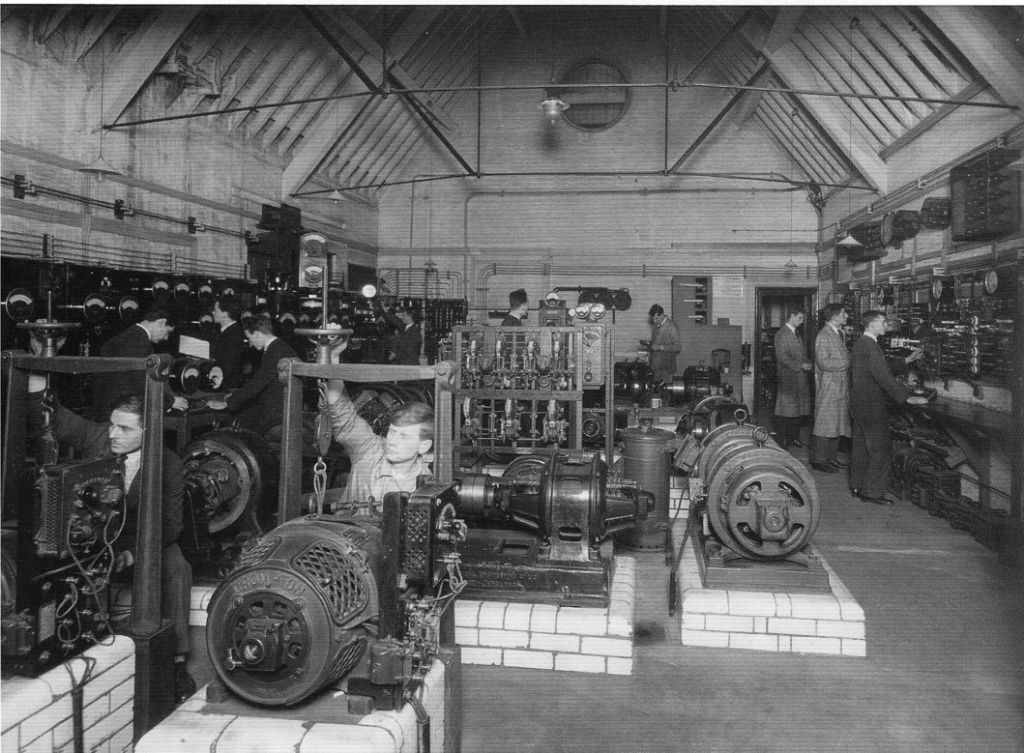

                                                  Posted by MICHAEL WILLIAMS on 14/09/2013 09:24:10:
                                                  Early power electrical systems are a fascinating subject to study .
                                                  You mean like this?
                                                  That's where I did my study of electrical machines. The only "electronics" was the mercury arc rectifier and inverter. There was three phase ac on open brass terminals at that bench on the right. The HSE would have a field day there now!
                                                  Russell.
                                                  #129618
                                                  Anonymous
                                                    When I was deciding which university to attend I saw an electrical machines lab like that during one visit. And the guide was very proud that some of the machines were made in the 1890s. Put me right off, at the time. It didn't help that it poured down all day and on the bus ride from the railway station to the campus all I could see were damp, drab concrete buildings.
                                                    Regards,
                                                    Andrew
                                                    PS: Note the bus journey; none of the modern trend where the university tours are as much for the parents as the prospective students. I think the most my parents did was give me a lift to the railway station in my home town. wink
                                                    Edited By Andrew Johnston on 14/09/2013 10:55:31
