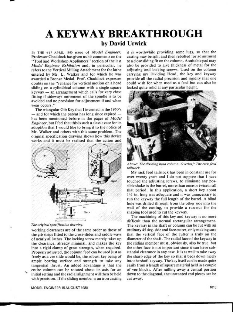

                              I had a dig in the ME stuff and his obituary states that the original MM went with him to Malta but there's no info on whether it ever came back when he returned
                              He built the machine in part to prove the efficiency of his triangular key gib
                              urwick-keyway.jpgedit:
                              He also used the same system in the tailstock
