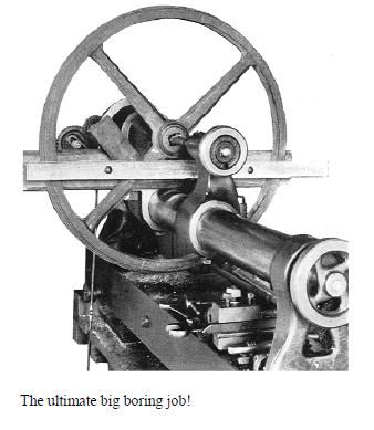

      Sirs
      Upon opening the latest copy of ME (#4386) I was appalled by 3 photos in Harold Halls “The Beginners Guide to Building a SteamEngine”
      Where oh! where is this great magazine of ours going when it can allow such a dangerous practice of workholding like this shown in photos #30-31-32 of Halls “Guide to “eginners. Publishing a “Top Tip” does not mitigate such a dangerous piece of advice.
      In my apprenticeship days if this method of workholding had ever been attempted, I would have been awarded with an immediate “Kick up the pants” followed by an equally quick visit to the Chief Engineers sanctum.
      If ME is going to continue publishing advice and help to new entrants into the hobby surely it DEMANDS that SAFE and only SAFE practices are photographed and shown.
      Shame on Harold Hall for his advise, and Shame on the Editor for publishing such a dangerous method

                I noticed this myself.
                Two of Harold’s drawings imply holding a long workpiece in just the tips of the jaws of the chuck, and does not show any tailstock support.The text makes it clear tailstock support is needed.
                I imagine this is oversight not deliberate, but yes I can see it leadinga beginner astray.
                #55514
                  Stick the work would have fitted into that 4 jaw with a jaw square to each face so don’t see why he held it diagonally, could understand if it were too larege for the chuck.
                  I’ve certaily used this method in the past and even the likes of Sparey shows it in his book
                  Ian if you are a subscriber then its in the digital issues

                    Hi There
                    I don’t see a problem with this method.
                    It has been used and photographed many times over the years.
                    Like any machining operation, you use common sense and make sure the component can’t move no matter how it is machined.
                    I have even seen this method photographed in a three jaw chuck.
                    I think it was holding a flycutter.
                    regards david

                      If you look closely, there are round shapes at each end of the casting towards one edge.
                      Photo 29 shows the 4 jaw used as Crewmech would no doubt advise. The problem comes when reversing the casting for machining of the opposite face.
                      I, a novice to all this, using common sense, would never mount a casting with a hemisperical face to a chuck jaw! I would certainly copy Mr. Hall’s method.
                      Like our esteemed Editor, I have also seen the same principle used on a 3 jaw and have used it myself, fly-cutting my home-made angle plates. It worked well, except for the fact that I was using too high a speed so chipped my first effort with an carbide tip.
                      I am using my great grandfather’s Drummond, and from what my father remembers, all sorts of weird contrivances were used to carry out work; necessity is the mother of invention.
                      This is the sort of thing the old boys used to do; from the Drummond book of work carried out on treadle Round Bed lathes;
