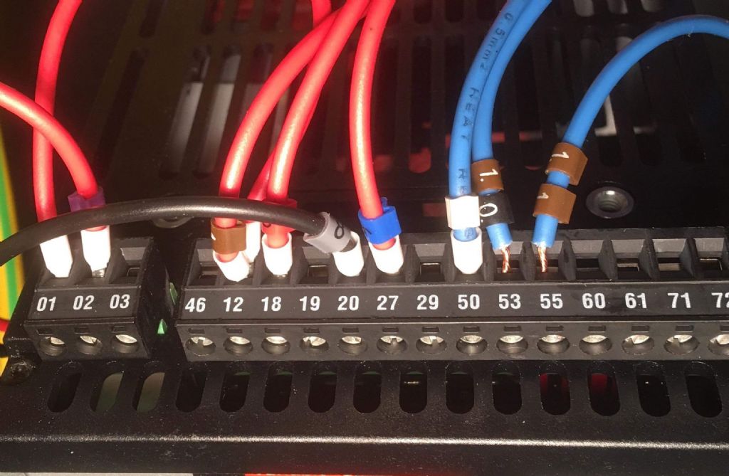

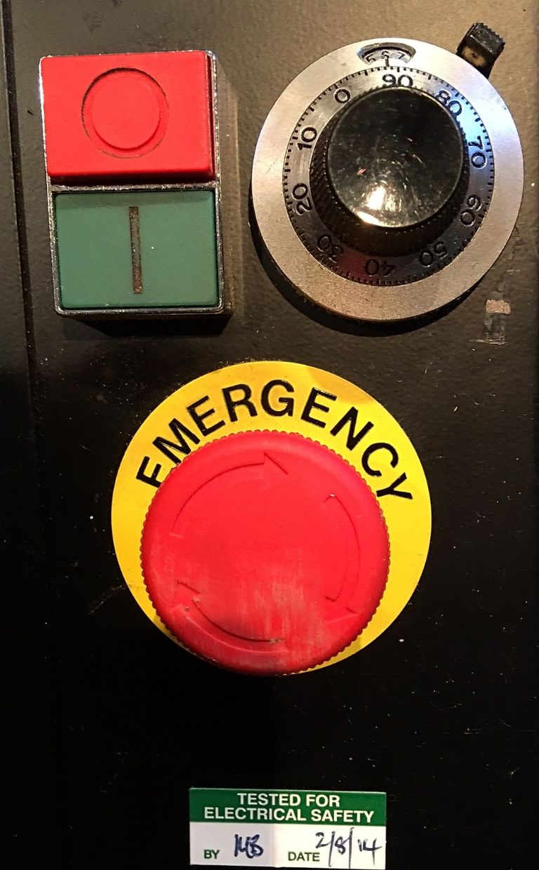

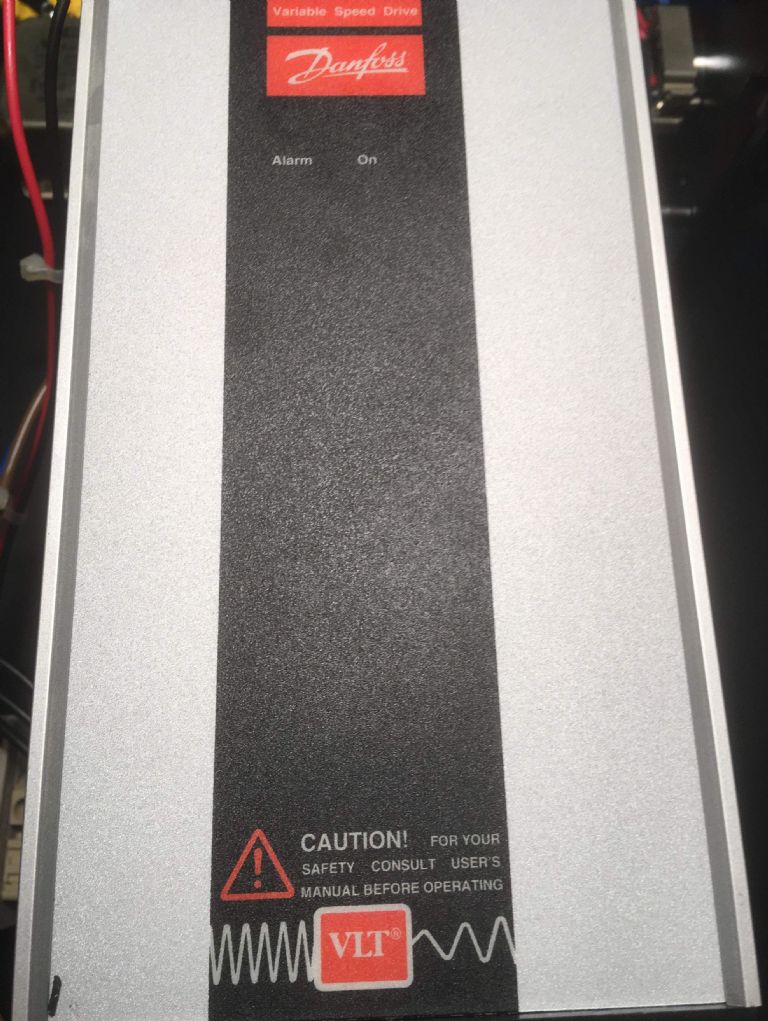

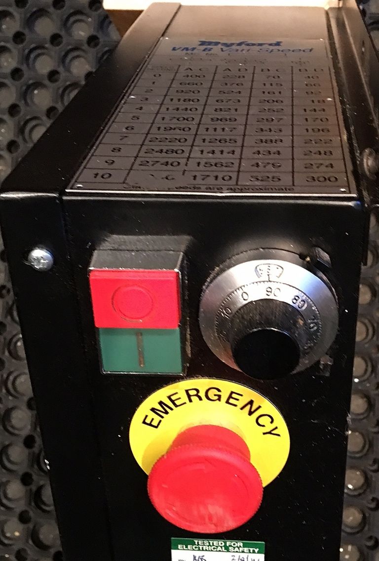

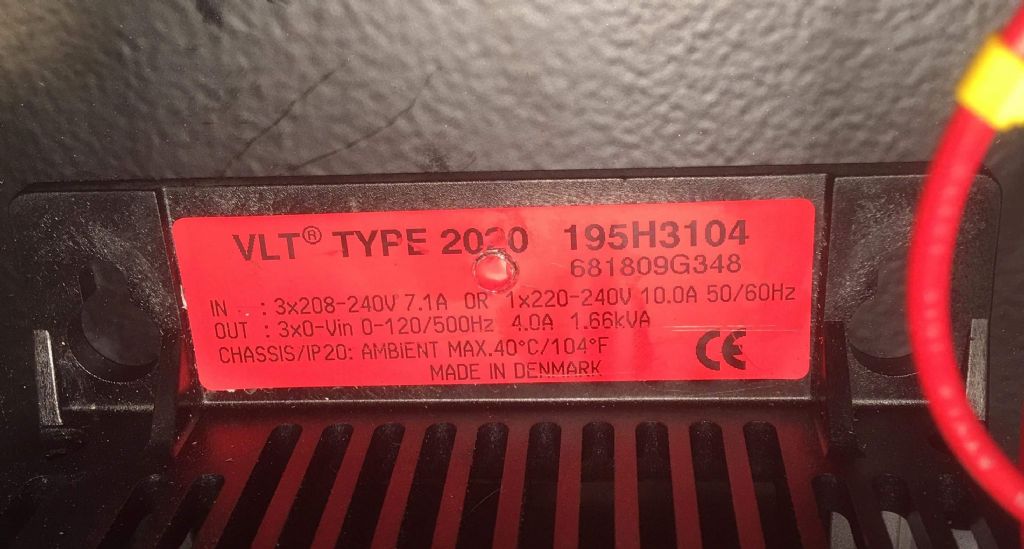

        I HAVE A DANFOSS VLT INVERTER ,
        240volt input 220 volt 3 phase variable frequency output
        I came off a Myford Vertical Mill and is
        installed in a large electrical housing box.
        It is TYPE DANFOSS VLT 2020 195H 3104 – Without a display.
        Unfortunately I do not have an Instruction Manual and cannot find one.
        Can anyone help locate a wiring instructions/ diagram please.
        I Need to change the rotation of the spindle, I know i can do it on the 3 phases,
        but i would like to add a switchable forward/ reverse unit to the inverter
        see photos below
        Thank you in advance

            Try **LINK**. The model without display seems to be a weirdo, see about p.33 et seq.
            #361860
              The way I read the diagram on page 10 of Dick's link, connecting Terminal 19 to 24v (output on Terminal 12) will reverse the motor. The diagram shows this done with a switch where ON is reverse and OFF is forward.

                HI Thank you for the information, exactly what i needed.
                I will report back ..many thanks
