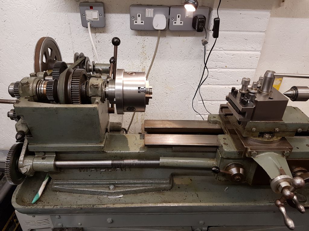

      Good afternoon all,
      I have a MALCAR 4 1/2" Lathe that I inherited from my Grandfather, it was built by the Wragg Brothers circa 1954. I have unfortunately damaged the driven backgear on the main spindle. Does anyone have knowledge of this lathe, an idea of where I may be able to get a replacement gear or possibly have a lathe for parts.
      Many thanks in anticipation

          Hello Andy,
          I can't be of direct help with spares but it is possible to braze in steel segments and form replacement teeth in them as a means of salvage. The gear has to be free of the lathe in that case of course.
          An alternative method is to drill into the broken teeth and insert silver steel pegs to reshape afterwards as teeth. They don't need hardening in case you are wondering. That method can be used for a fix where stripping down is not convenient or best avoided
          I have used both methods with success.
          Regards Brian

              I have a gear with a row of grubscrews shaped to the tooth profile. I would prefer to insert grub screws, shape to a bit less than the tooth profile, then fill with braze and recut the teeth.

                Hello again Andy,
                Thinking a little more about finding a gear for your lathe, be careful if you approach people like HPC in Chesterfield. to supply a new one
                New gears these days by HPC and others will almost certainly be made to the modern 20 degree pressure angle whereas your damaged gear is almost certainly made to the earlier 14.5 degree angle and while they will mesh, it will not be a happy mix. Whoever you approach would need to be made aware of that and will charge accordingly if they are prepared to make a 'special'
                There are some on this forum who could supply a custom made copy, myself included, if all else fails.
                Regards Brian

                      It might be worth measuring up the gear and determining the DP and number of teeth. It may be possible to find a more readily available gear off a Myford etc etc that can be machined to fit by boring out the centre etc.
                        Regards Brian
                        No experience of these myself, but Tony has a comment on his web site requesting any owners get in touch with him, presumably so he can add more machine details to his database.
                        Regarding the pressure angles etc. assuming the gears are say 20dp, they always run as a pair on a backgear, so if one were to replace both gears as a pair pair from HPC, then the pressure angle wouldn't be an issue.
                        If they have internal splines, then bore out the new gears to a larger ID, and turn the teeth off the old ones. Pin and Loctite the two parts together and re-fit.
