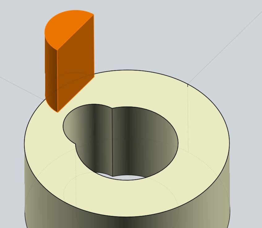

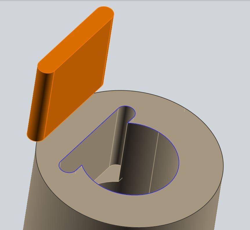

            Would you be able to machine the shaft and fit an insert like in either of these pictures?
