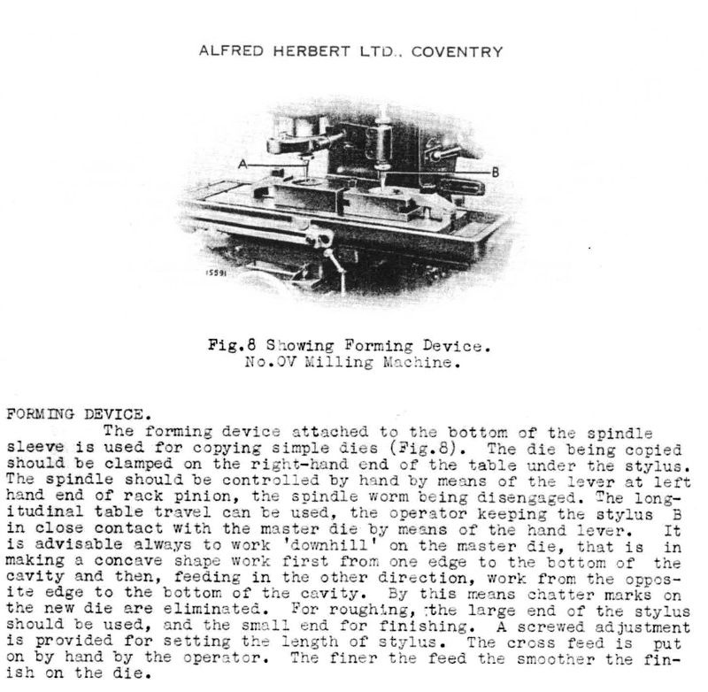

                              My Herbert 0V milling machine has a page in the manual for doing this very thing (actually for copying dies, but it's the same principle). It describes using a ball-ended cutter and an identical probe (just a metal rod with a round end the same diameter as the cutter) set over the pattern. It has a fast-travel x-axis screw too (2.5tpi) to facilitate the work. The cutter and probe are set up over their respective parts, the operator keeps weight on the quill handle and uses the traverse to run the proble over the die to be copied. The cutter follows the path of the probe and makes an identical pocket needing only minor finishing.
                              A bit like a lathe hydraulic copying attachment except fully manual and producing 3-dimensional copies rather than the lathe's 2-D.

                                Obviously the better ‘engineering’ approach, Pete yes

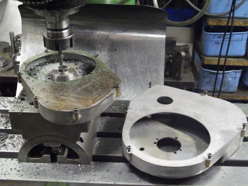

                                    I faced a similar problem in locating matching holes in a blind plate,
                                    although not the same as your situation the solution is much the same.
                                    Seen here in the photo the two halves of a belt housing ,the main
                                    part of the fabrication has some soldered in bosses to hold the cover
                                    plate ,as these were in fairly random locations the cover had to be drilled
                                    to line up with these threaded holes.Set up on the milling machine a
                                    clearance drill is dropped into a hole to set the position and then the
                                    cover plate which is oversize is held in place and just spotted ,the hole
                                    is then drilled ,with the first hole in place the same procedure is followed
                                    until all of the holes are drilled.The oversize plate is scribed around the
                                    profile and bandsawn and filed to match the body of the housing.
                                    The second part is much the same in the the centre hole has to line up
                                    with the location hole in the rear of the body ,the housing is bolted down
                                    and the centre of the location hole is located,the large washer and bolt
                                    fitted to secure ,the cover plate fitted and the opening milled away.
                                    It is useful to have a milling machine to do this sort of thing ,as you have
                                    a pillar drill much the same can be done ,i would think that it would be easier
                                    if you had a sheet metal template and by locating the valve guide with
                                    suitable size rod in the chuck and then using a small drill to spot the
                                    location with the template just held in position ,fixing then the template
                                    with a suitable fixture in the first hole use the same procedure
                                    to locate the second hole.

                                        Pete Rimmer
                                          @peterimmer30576
                                          Here's the page from the Herbert manual, if it's of any use.
                                          Regards
                                          Pete.
