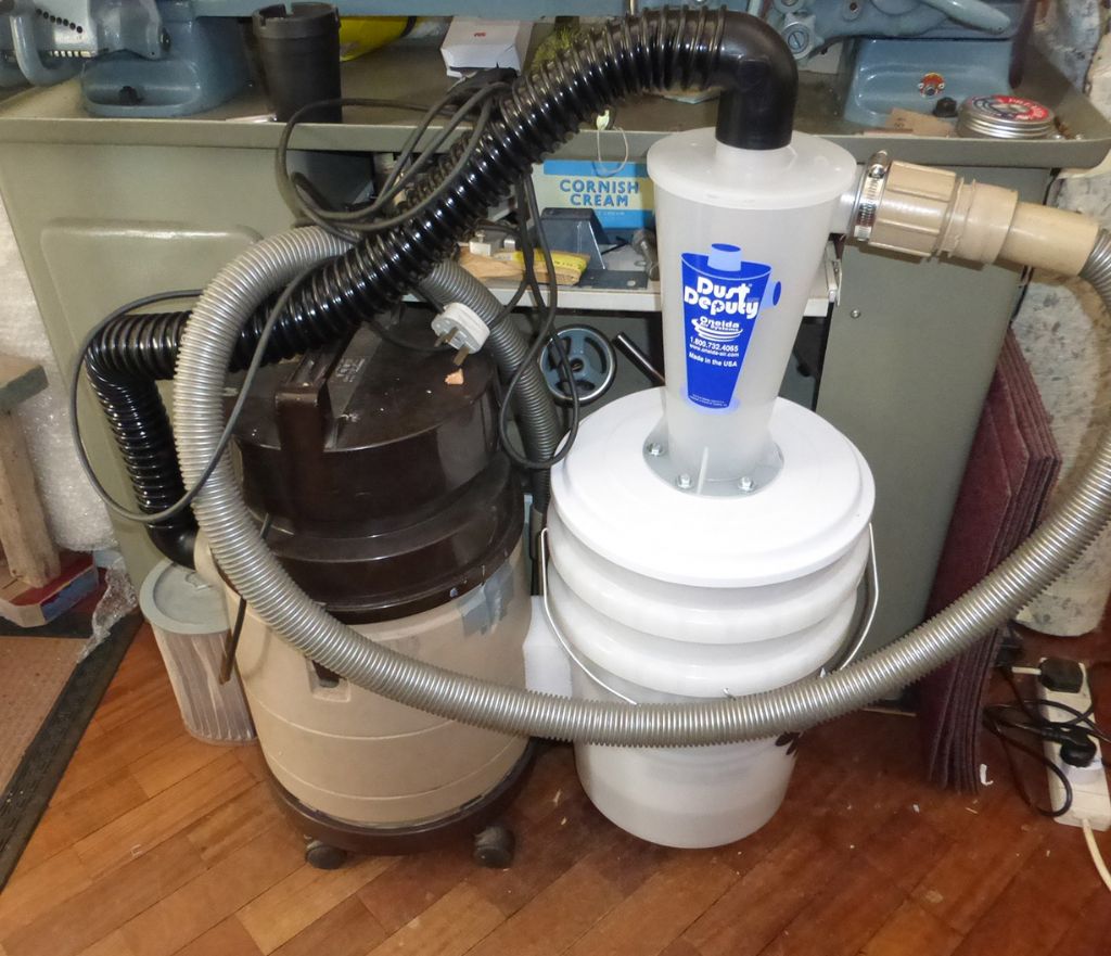

        mark smith 20
          @marksmith20
          I recently bought a dust deputy add on for my old Rowenta vacuum. I think its excellent ,collects wood dust plaster dust, swarf ,etc…..
          You get no noticiable drop in suction at all that ive noticed,like using a new vacuum all the time.
          You have to attach it to the side of the vacuum by drilling two holes but it wasnt a problem in my case . The vacuum you bought may be more difficult to attach one though as it doesnt look too high .
          I had been after one of these for ages but wasnt impressed with the price ,but finally succumbed when there was a sale on.
          I work with some tropical hardwoods and the less contact with dust the better for me.
          I bought a new filter for the rowenta before fitting the dust deputy and the filter has almost nothing on it after a few months use. I hated cleaning those pleated paper cylinder filters.

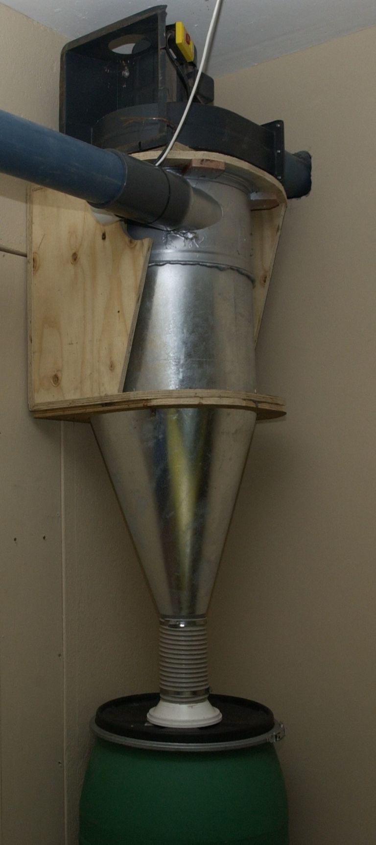

                        Made this one from a sheet of galvanised iron – 0.8mm. The Vac unit was originally a motor/centrifugal fan mounted on a trolley with a linen bag into which all the guff was dumped. Very inefficient and dusty, esp with wood work.
                        The fan unit just sits on top of the cone, with a door seal foam strip as seal. The large drum below collects all the stuff. Really only used for woodwork, as it is piped to all the wood machines, but I do cut a lot of aluminium sheet on the radial arm saw, so some 'metal' swarf goes in..
                        Very easy to make a small one from galv. sheet steel, more suited to metal work machinery.
                        There is a useful book:
                        Woodshop Dust Control, by Sandor Nagyszalanczy ( yes…) – the concepts are applicable to any cyclone type seperator, so ok for metal swarf too.
                        Folk have even made the cone section from one of those 'road works in progress' road marking plastic cones – maybe open you door as you drive past and loan one…(not really..)
                        The cone type separate using the change in velocity of particles from the top of the cyclone down to the bottom. A simpler separator, basically just a drum with the inlet of to the side ( the upper section in my photo) relies on centripetal force to push the particles to the outer part of the drum, where gravity does its job after a while.
                        Both types do really work well.

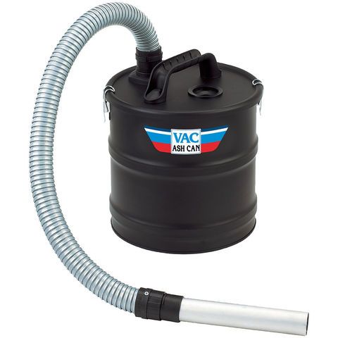

                                                  Anthony Knights
                                                    @anthonyknights16741
                                                    This from Machine Mart could be a possibility. Vac hose fits in 2nd hole in lid.ashcan.jpg
