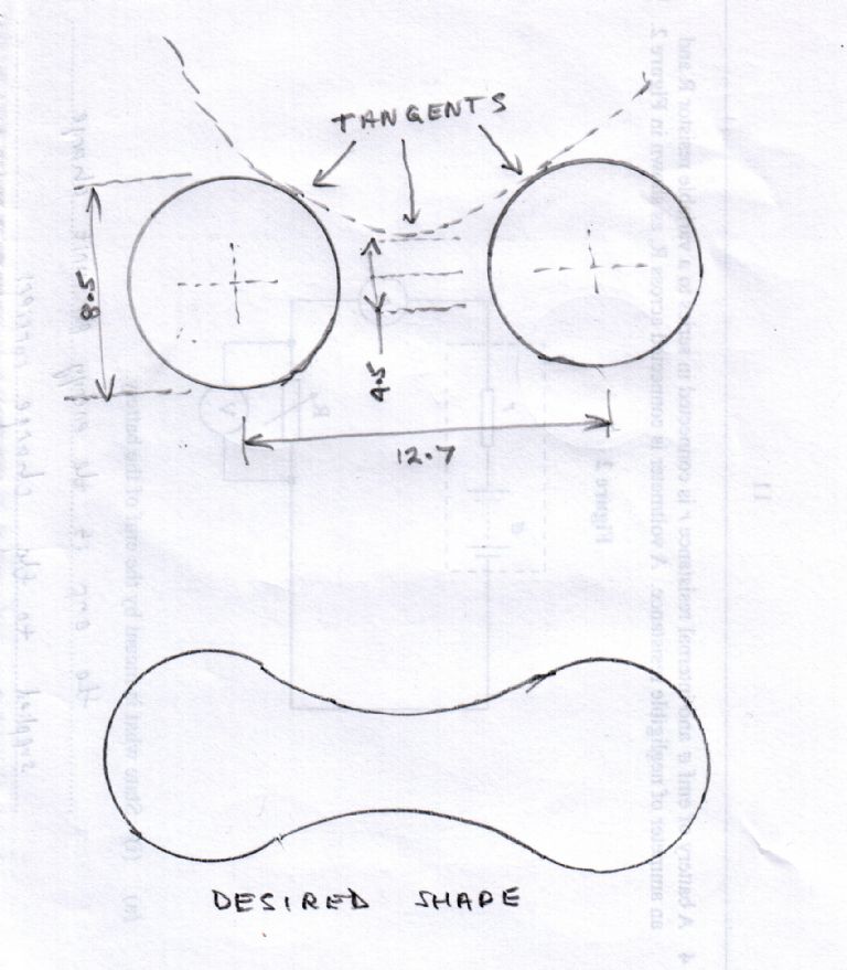

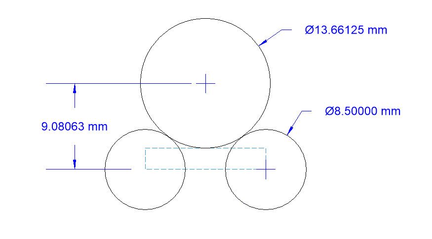

      I am in the process of drawing a modification which uses a cycle chain. For my purposes, all I need is the side view of one of the outside plates. I have managed to do it by trial and error, but remain convinced that there should be a method using geometry, but unfortunately my GCE & C&G Maths along with investigations on the internet have not revealed a way of doing it. So, any ideas?
      The sketch above shows at the bottom the desired shape, and above the basic method I have used along with the three known dimensions.
      It seems to me that in order to get a smooth transition from the convex curve of the two circles to the concave curve of the dotted arc, the junction of the curves must be tangential to each other. Similarly, the 4.5 dimension being the dimension across the narrowest part of the plate must also be a tangent. In other words, what I need is how to construct a larger diameter circle which is tangential to both of the two smaller circles and a straight line at the narrowest part of the plate.
      Over to you.
      Peter G. Shaw
      ps. As I said, I have done what I want by guesswork so this is now purely for interest.

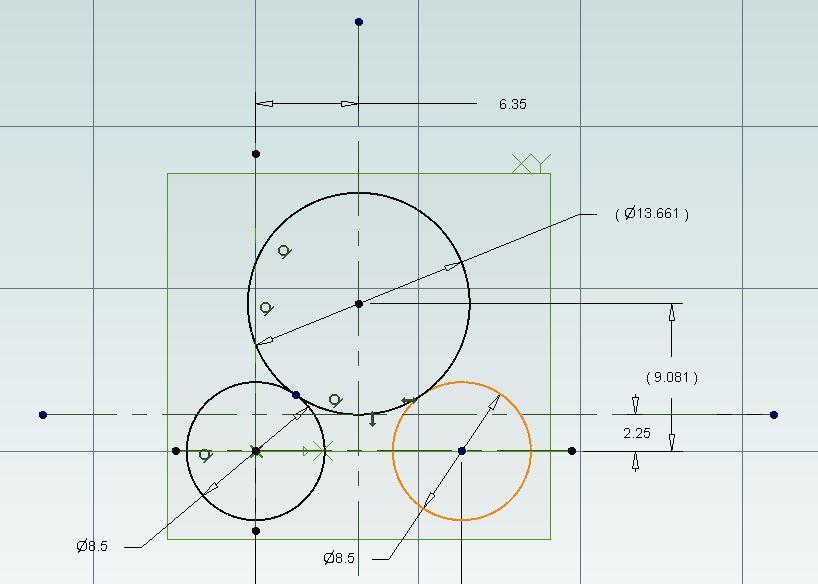

          The easy way is to use the ttt command in CAD. This gives a circle 13.66 diameter centred 9.08 from the centreline.
          Otherwise I think you are into Algebra rather than Geometry.
          call the radius ofyour big circle R. The distance from centre of big circle to chain pin is (R+4.25) From centre of big circle to centre line between pins is (R+2.25), so by Pythagorus (R+2.25)^2 + (12.7/2)^2 = (R+4.25)^2 which can be easily solved as te R^2 terms cancel out.
          #372238
            Easy with CAD

                  I think I have it by constructed geometry. The resulting diameter* matches JasonB's algebra. Creating a nice looking 'Points A B C D E etc.' drawing will take a bit longer,
                  * Using F360, but traditional methods.

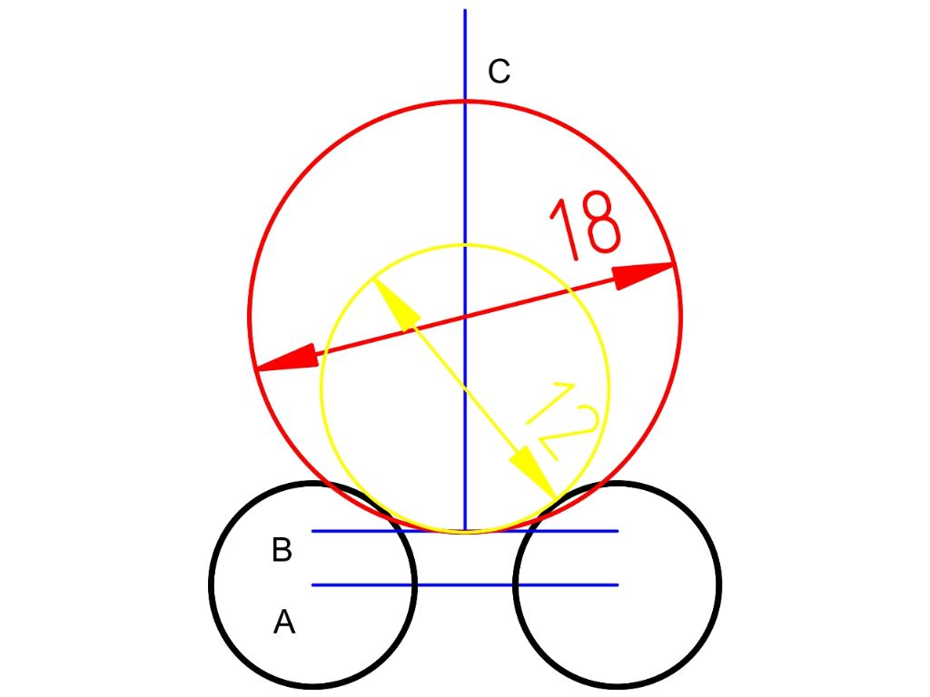

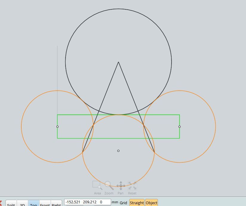

                      I don't have these TTT or TTR functions either and did not know the diameter of teh large circle.
                      What I did was draw the two 8.5mm circles 12.7mm apart, Then drew a guide line 2.25 (half the 4.5) above their ctr line and another guide line vertically between the two circles. Next I drew the third unknown circle starting with it's ctr on the vertical line and stopped when my mouse touched the left 8.5mm circle which set it at a tangent to this and the other one but it did not reach the 2.25mm line. So I then just used the tangent function to also make the large circle a tangent to teh 2.25 line.
                      As I did this the large circle altered it's own diameter and therefore it's ctr height this gave me the two unknowns. If you want a few screen shots of the various stages just ask

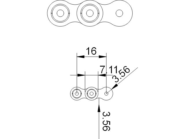

                          and download a ( free ) 2D/3D file of the part I need. For example, this chain link pair was used in one of my sadly now lost projects. It's a dxf file, but also available in a multitude of other formats, including stl, etc. :
                          This just happens to be a chain link with 8mm between centres. ( I've added the dimensions below for illustrative purposes ). I have no reason to re-invent the wheel for each standard component when I can get a professionally drawn one so easily. Need a different size? Just use the scale tool.

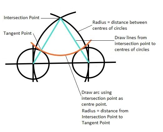

                            Old school geometry would probably solve this as follows:
                            Using the centres of your two circles, draw arcs having a radius equal to the distance between the centres of your circles so that they intersect.
                            The intersection point is the centre of your new arc which will link your two circles. Draw lines from the intersection point to the centres of each of your two circles. Where these lines cross the boundary of your two circles will be the tangent points.
                            Using the intersection point as the centre, draw the arc linking the two tangent points.
                            Probably easier to draw than describe, refer sketch below. The orange line will be your required arc.

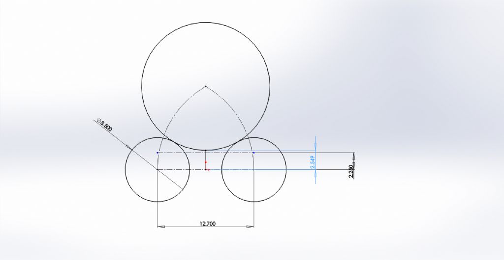

                                Unfortunately your method does not work out in practice, it sort of looks OK but it leaves the middle thickness at 5.098mm which is much thicker than the OP's desired 4.5mm.
                                I was curious to see if your method worked and plotted it out in Solidworks 3D CAD to test it.
                                Sorry to pull the rug.

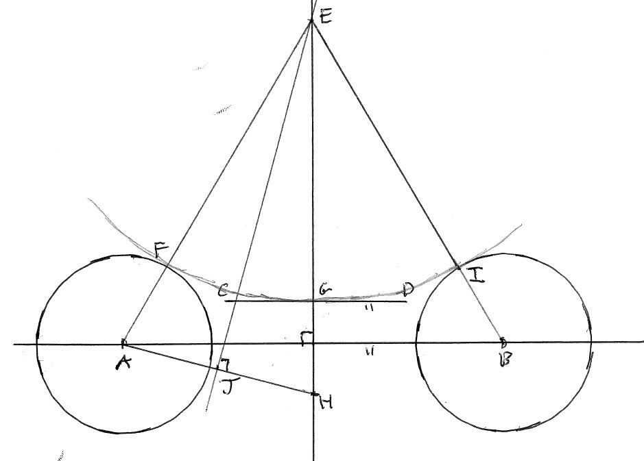

                                              I believe this works. The key is making GH equal to the radius of the two circles.
                                              AB is the line between the centres of the two circles
                                              CD is the defined line, parallel to AB
                                              E is the centre of the desired circle
                                              Construct the perpendicular bisector of AB, this intersects CD at G)
                                              Construct H such that GH=AF=BI
                                              Construct the perpendicular bisector of AH
                                              Those two perpendicular bisectors intersect at E
                                              The desired circle has radius EF=EG=EI
                                              As a check, construct the perpendicular bisector of BH, which should also pass through E.

                                                  Neat, making 2 equilateral triangles. Wish I'd thought of that
