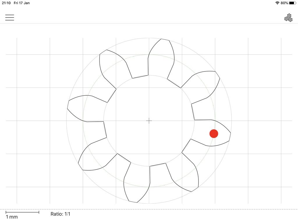

                Posted by JasonB on 17/01/2020 20:23:55:
                The problem is that with a small number of teeth such as your 0.5MOD gear is that the teeth need an undercut […]
                A quick check on ‘Easy Gear’ suggests that no perceptible undercut is needed for 10 teeth at 0.5MOD
                https://apps.apple.com/gb/app/easy-gear/id1197863906
                Edited By Michael Gilligan on 17/01/2020 21:06:18

                  Yes you're right Jason, I forgot the addendum. Still the undercut problem with 8 teeth. For Michael's 10 teeth the module would be 4.2 mm at the same shaft diameter, or if the shaft was made 6 mm diameter you could go for 10 teeth. But it depends on the tooth form and module of the mating gear which presumably exists.
                  #447230
                    Sorry, John … Brain-fade on my part
                    Must pay more attention !
                    I will check 8 teeth
                    Edited By Michael Gilligan on 17/01/2020 21:14:58
