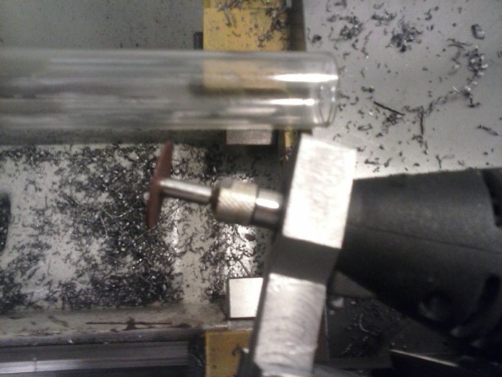

            Hi Tony
            I've been experimenting with cutting gauge glass tube to length for hydrostatic lubricator sight glasses that have to seal on the end cut face. These are 10mm dia so smaller than yours.
            As Baz suggests the most sucess so far has been diamond cut off wheel in a dremel mounted on the lathe toolpost, cutting very deeply into the tube wall until it's almost through and it will then break off easily. I've tried scoring the tube with a diamond file without much luck, the dremel has the best results although the cut ends still need a trim as in this application the tube needs to seal on its cut end face.
            To get the end faces flat I've been using a diamond sharpening stone with a guide to keep the end square, good job I bought lots of glass tube as initially the atrition rate was very high, I only spoil about one in four now!
            One tip you might find handy is once you have cut your first successful tube to the perfect length with nice smooth, square ends is not to let it roll off the bench and tread on it. Don't ask me how I know that!

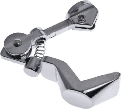

                      I use a special glass cutter for shortening the glass on the water column for my steam engine. It has a small hardened cutting wheel and clamps around the tube. It does not cut thru the glass but produces a scratch around the tube. The tube is snapped at the scratch by holding in both hands with your finger and bending. (have not cut myself yet). (Google glass tube cutters. The only cost about $15)
                      I have also used the corner of a file to score a scratch around the glass tube. Wrapping both sides of the cut with tape will help to stop it shattering.
                      The cut end of the tube should be smoothed to eliminate sharp edges and stress points that could start cracking. I use an oxy torch to melt the ends but could also be ground with wet & dry paper.
