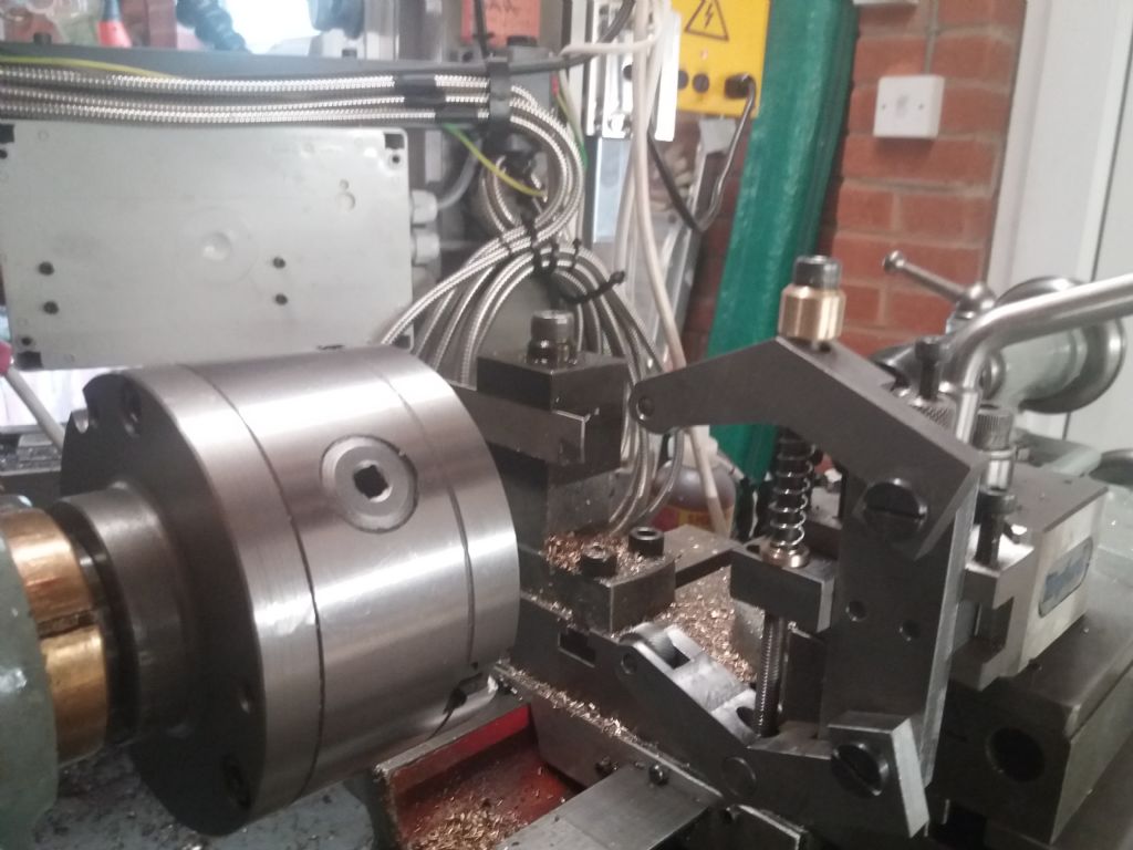

                          David George 1
                            @davidgeorge1
                            This is one i made a while ago a clamp style.
                            I have the drawings if you wish them. It knurls from 1/4 inch to 2 inch approx. I have a set of spare knurls for all three cuts to suit. Drop a message if you want them
                            David
