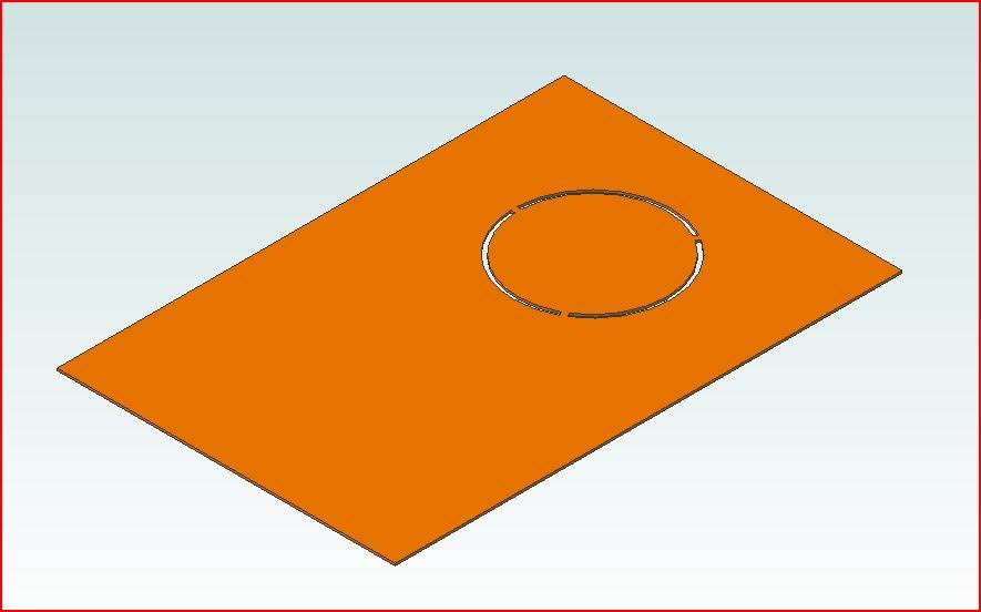

                                  Before anyone else suggests methods that won't work I'll clarrify whats wanted.
                                  The heat from the boiler burner in the left of these cylinders is being transfered to the liquid fuel in the one on the right. To isolate the fuel from the heat Brian wants to cut away some or all of the copper so the heat cannot get to the bit under the fuel container. So tinsnips won't work, a hole saw would do it if the bit was completely separate or piercing saw with a deep throat but Brian does not get on well with saws. Those a 2.5" dia cylinders
                                  Something along these lines
                                  Edited By JasonB on 06/02/2015 11:32:38

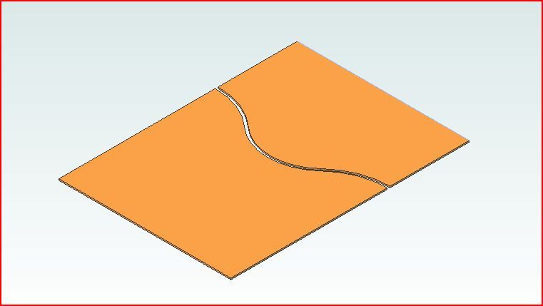

                                      You have the right idea but I was going to separate the section of copper that supports the spirit burner from that which supports the boiler firebox. I wish I could draw what I want ! I will try to sketch the wavy line I intend to cut in the copper.
                                      The fret saw is a good idea but surely it would take ages to cut through metal ?
                                      What about my initial idea of buying a jig saw with a metal cutting blade ? Wouldn't this do the job or are they no good with curves ?
                                      #178701
                                        If you are thinking more like this then yes a jigsaw will do it, 10mins with a handsaw will also do it even snips could be used but they will tend to distot the sheet which will need flattening. Sketch what you are thinking on a bit of paper and then photograph it and post here.

                                          Assuming that you can start a jig saw off from a pre-drilled hole, Place your copper sheet on top of a piece of foam insulation which is the thickess of the maximum travel of the blade plus a bit. Put masking tape onto the top surface of the copper sheet to protect it from scratches. draw your circle. Wear goggles (Copper swarf in your eye is not good – and I mean it). Now use your jig saw with the fine metal cutting blade. They do make narrow blades for cutting small curves.
                                          I used this method to cut out a weather vane of a man leading the plough.
