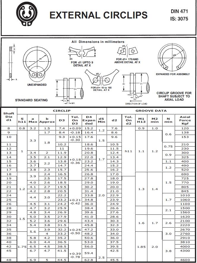

      I need to cut a groove for a circlip. It's external to suit a 10mm bar. I've bought a mixed box of clips. Are there any tips on selecting the correct size? And is it possible to grind a hss tool thin enough and have it survive the cutting operation?

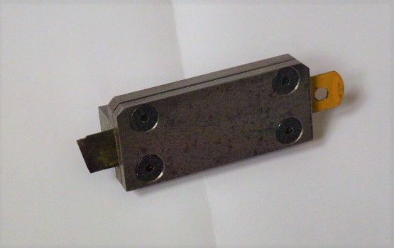

            It is possible to grind a hss tool, suggest you start with a smallish blank, say 5 – 6 mm square. Alternatively, I have a parting / grooving tool made from a broken section of "all-hard" hss hacksaw blade in a home-made holder. Works very wellpo holder.jpg

                Posted by colin hamilton on 11/04/2023 07:47:46:
                https://roymech.org/Useful_Tables/Circlips/Circlips_External.html
                Grooving tips are also available to suit standard laydown threading tools (the ones, for example, that take ER11 and ER16 inserts).
                #640873
                John Hinkley
                  @johnhinkley26699
                  I'll second what the Andrews and Clive have said. When I needed to make a groove for a circlip, I thinned an ordinary hss parting blade down to 0.8mm and used that. Going carefully, of course, because I didn't know any better, I achieved the desired result.
                  For the dimensions, I referred to the table below:

                      For a one off, I would favour Clive's hacksaw blade method. Have as little as possible of the blade overhanging.
