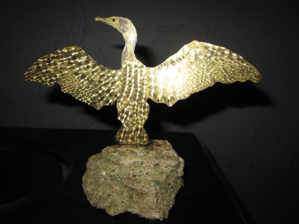

                                        This is the sort of thing you can make from 0,9 or 1mm brass/copper with a scrollsaw. If you're after accurate square or rectangular work you'll need to make a fence.cormorant1.jpg
