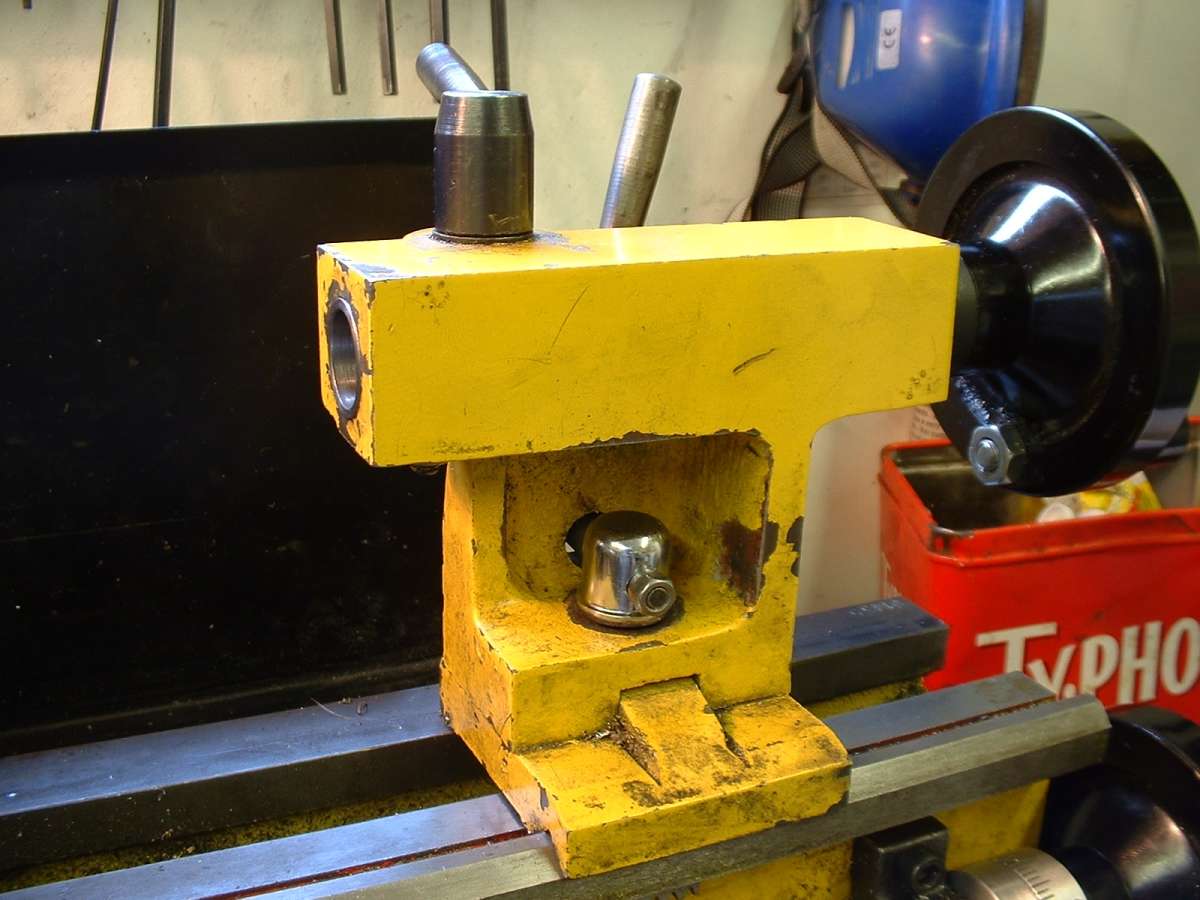

                        Beyond observing the situation on my Sieg where there is no chance of contact other than on the flanks I can also see that the machining on the bottom of the tailstock is significantly worse than on the bed, there are very small contact wear patches and lots of apparently untouched surfaces. If that were the only issue then perhaps scraping might be a better option, as it is I think a more radical answer, making a new tailstock base will work better.
                        Martin
                        IMG_2067-1
                        #711562
                        Martin Shaw 1
                          @martinshaw1
                          Howard
                          It’s an SC3 which has the horizontal locking screw visible in the pic above and the vertical screw that holds the body to the base and only tightenable by removing the whole thing from the lathe. It can be made to align but inevitably goes out after some time. Because of the slot and screw head recess in the base its range of adjustment is limited (fixed) and apart from a washer as suggested by Jason I felt a new base was the answer, I still do.
                          Martin

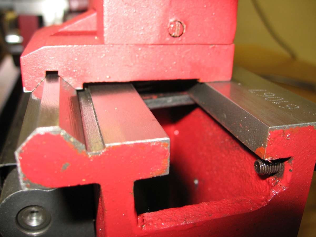

                              1. The sliding faces on the tailstock don’t appear to have much of an interference with the bed, the prismatic is       perhaps ok, the rear surface hardly at all.
                              2. The horizontal alignment screw doesn’t really adjust anything.
                              3. The vertical holding screw is tightened from underneath which requires removal of the tailstock and is limited by the recess for the screw head. This latter can be mitigated by a washer under the head but it is a bit sub optimal in my view.
                              4. The raised section of the base requires a pivot point for two opposing adjusting screws in the tailstock body to act against.
                              5. The vertical alignment needs sorted out.
                              6. Because it’s an interesting exercise that I feel like doing.
                              It is undoubtedly possible to fiddle about with the existing set up and make it work, I have done it oft enough to want a more permanent solution to the issue.
                              Martin

                                            That measured 88.9 degrees sounds fishy to me. I say this because when I made the first saddle (carriage) stop for the museum’s Smart & Brown model A, I measured the angle of the prismatic vee at 88 degrees. After making the stop, I found that it did not fit very well, and rechecked the angle at the unworn end of the bed. 90 degrees, a standard angle when you think about it and I would recon that yours is also 90 degrees. The bed of our S & B is very badly worn. It is very difficult to measure such a short sided vee with precision. That makes buying a reverse dovetail cutter an attractive alternative to other methods. The great advantage in investing in a tilting vise is the extra versatility that it brings to your mill, but your budget may be limited.
                                            This link to a new Sherwood cutter on ebay may help, it can be held in a standard collet as well as an Autolock type holder.
                                            https://www.ebay.co.uk/itm/404288573598?_trkparms=amclksrc%3DITM%26aid%3D777008%26algo%3DPERSONAL.TOPIC%26ao%3D1%26asc%3D20230823115209%26meid%3D7176e27fd9de491b9754bb4914a1ae2d%26pid%3D101800%26rk%3D1%26rkt%3D1%26itm%3D404288573598%26pmt%3D0%26noa%3D1%26pg%3D4375194%26algv%3DRecentlyViewedItemsV2SignedOut&_trksid=p4375194.c101800.m5481&_trkparms=parentrq%3A8026fcda18d0adbaedfcd495ffff2d46%7Cpageci%3A06867133-c530-11ee-beb8-b65f927858cc%7Ciid%3A1%7Cvlpname%3Avlp_homepage

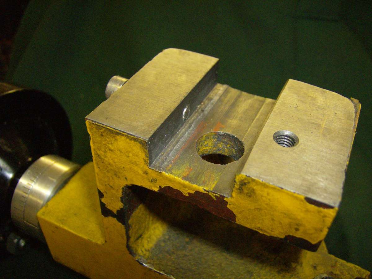

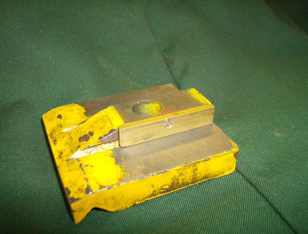

                                                I respect your wish to make a new item, but let me tell you what I did.
                                                I was able to obtain a lever lock tailstock someone else didn’t need -John Stevenson had converted a machine that didn’t need a tailstock (I think it was for making fishing floats!
                                                This was slightly taller than mine for some reason and I was able to machine the back and forth joint to get a much better fit and finish with perfect alignment with the lathe axis. Mods included a brass gib as well as sorting out the locking mechanism, so it could be moved and locked without going out of alignment.
                                                Tests with blue showed the vee and sliding face to be good fits. I may or may not have done a tiny bit of scraping, I don’t recall.
                                                If I was in your position I would either make or buy a single point cutter to make the groove and finish by scraping it to fit the bed – note this requires that the flat sliding surface at the rear is sorted too, or I would cut off the top of the  block, and make a new cross-motion arrangement and add a better locking arrangement (on my original tailstock I built a quick release, but it wasn’t as good as the stock one).
                                                LooseTailstock lever clampBase of tailstock
                                                Tailstock gib
                                                #712600

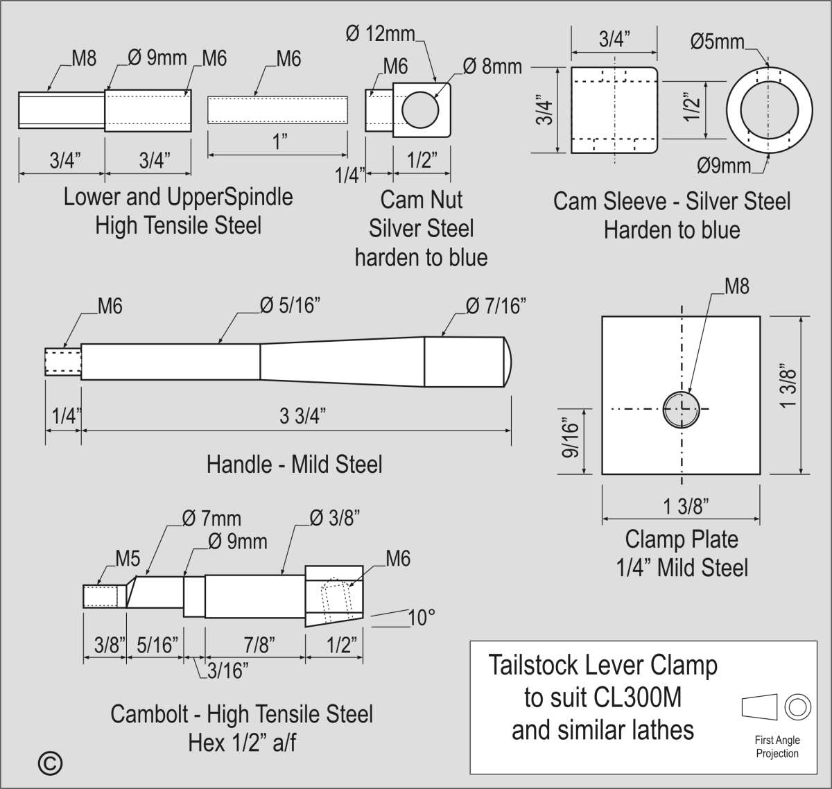

                                                  There may be some useful stuff in this which I wrote a long time ago:
                                                  The Tailstock
                                                  A Tailstock Lever Clamp
                                                  One of the most annoying and time-wasting features of mini-lathes is the reliance on a simple bolt clamp to fix the tailstock. Reliable, solid and very slow. Nothing would speed up repetitive tailstock operations more than a quick-release mechanism for the tailstock. I thought out several possible solutions, but never got “a round tuit”. While idly sifting through one of my ‘bits boxes’, I turned up a redundant cycle quick release. If this can hold a cycle wheel solid as its (terrified) 190lb rider plunges down a steep, bumpy track at 40 mph, then surely it can clamp my tailstock, methought. After prising out a circlip, a simple eccentric cam arrangement was revealed.
                                                  The lazy solution would have been to shorten the quick release spindle, re-thread the end and run it through a plate beneath the bedways, but I wanted a longer clamp lever that would also be out of the way behind the tailstock. I decided to follow the principle of the clamp, but making it rather more robust. The device consists of a ‘cambolt’ which a lever turns in a ‘camnut’ drawing it into an outer sleeve. The cambolt pulls on a spindle threaded into a replacement baseplate, clamping the tailstock to the bed between the baseplate and the sleeve. To place the lever at the back of the tailstock, the cambolt is extended through a ½” hole in the tailstock web. This design has advantages over some other designs as all the clamping force is directly on the base of the tailstock casting.
                                                  The dimensions in the drawing will give a lift of 4mm if the cam is turned a full 180º. In practice, 90-100º can be achieved, giving about 2mm lift. This is sufficient to allow for variations in the thickness of the webs on the lathe bed casting along its length and gives adequate grip.
                                                  I can honestly say that this single adaptation has made a huge difference to the pleasure I get from my lathe. Any sequence of repeated tailstock operations becomes quick and easy. Most usefully, when drilling a deep hole one can release the tailstock and pull the drill out to clear swarf faster than one can wind it in and out with the handwheel.
                                                  Camnut
                                                  The size of this component is critical. The 8mm hole, together with the play of the head of the nut in the sleeve, is just enough to ensure that the cambolt will not jam it in the sleeve.
                                                  The camnut must be made from hardened and tempered silver steel or high tensile alloy. It will be under considerable tension, and it needs to be tough. The lever for clamping a cycle wheel is only half the length of the one I made for my tailstock, yet it clamps with sufficient force to withstand some really large shock loads. You should only need modest force on the tailstock lever to lock the tailstock solid.
                                                  I tempered my original camnut to dark straw, thinking this would be sufficient. This appeared to work, but the day after I fitted it I heard a sudden crack from the tailstock, and it had fractured. I was not even using the lathe at the time. A salutary reminder that hardness alone is no substitute for toughness. I made a replacement, but instead tempered it to a blue ‘spring’ temper. The new version has served for nearly a year without incident, so I recommend using this temper.
                                                  Spindle
                                                  Depending on exactly how you set it up, the lever clamp has about 2mm of travel for a 90° movement of the lever. This is not a lot, so adjustment is critical, and is provided by the combination of an M6 and M8 thread on the pillar. These have pitches of 1mm and 1.25mm respectively. By turning both ends of the assembly by one turn, the overall length will change by 0.25mm. Alternative and simpler arrangements would be to have a one-piece pillar, but this would only allow adjustment in steps of 0.5mm. A spindle passed through an unthreaded hole in the clamp plate could be used, but this would require locked pairs of nuts on both sides of the plate.
                                                  Cambolt
                                                  I made the cambolt from high tensile steel hexagon stock. Mild steel would probably wear too quickly in this application. You could use silver steel but, if you do, temper it to a different hardness to the camnut.
                                                  It doesn’t matter if you make the cambolt from hex or bar stock, though the latter will be a little harder to hold and drill for the handle. Start by turning down the 3/8” diameter (this section passes through the hole in the tailstock). Now turn the 9mm section over length, to provide the material for the cam, and the 5mm section at the same setting, so they are concentric. Thread the end of the latter M5. You now need to turn the cam, which requires offsetting the work by 2mm. This is most easily done using a four-jaw chuck, but you may also do this by packing one jaw of a three-jaw chuck. Align a suitable mounted point as a gauge (or even the tip of a tool), close to the joint between the 9mm and 5mm sections. Adjust the work so that the extremes of eccentricity are alternately at the 5mm and 9mm diameters. Now turn down a section of the 9mm diameter to 7mm, taking fine cuts to ensure the work does not slip.
                                                  Mill or file a flat for mounting the handle. This should be opposite the ‘high spot’ of the cam, so that pressing the lever down will raise the cam and tighten the clamp and that the maximum movement will occur as the lever passes the horizontal. The dimensions given for the lever handle are intended to give a good match for the existing tailstock and toolholder levers.
                                                  On final assembly the cambolt should be retained in place by a washer and two locknuts, or a single nylock nut.
                                                  Sleeve
                                                  I admit it, I have never got around to replacing the original cycle clamp sleeve, it works fine, though it does look a little out of place. The item in the drawing will do the same job, but take care to ensure that the two holes are exactly in line with each other and the centreline of the sleeve. As the clamp locks the camnut will move from side to side within the sleeve, not just up and down. Significant clearance is needed, more than just a sloppy fit, or the clamp will appear to lock without gripping the lathe bed.
                                                  Lever Handle
                                                  This is a simple design, it could be even simpler, but this shape blends nicely with the other screw levers on the machine, and I have copied it on other devices I have made. It isn’t as pretty as Quorn-style ball handles, but they are neat, quick to make and possible more comfortable to use.
                                                  You could argue that the lever is too long, as it allows tremendous force to be applied, and can foul the tailstock barrel locking lever. In practice I only turn the latter lever when the tailstock is locked, so that isn’t a problem. As to the mechanical advantage of along lever, only a few pounds of pressure will lock the tailstock securely. This is part of the pleasure of using the clamp, but one must take care not to over do it.
                                                  I made an attempt to black the lever by heating it and dropping it in clean oil. I don’t think it was clean enough, as the result was rather patchy, but even so it is not showing any signs of corrosion from my sweaty palms!
                                                  Baseplate
                                                  I made a plate that was rather thicker than the original, as that showed signs of distortion. It also meant I had the original as a spare, should the replacement fail! Note that it is offset in order to clear webs in the lathe bed, I suspect the offset will vary between machines, so check your dimensions from the original plate.
                                                  Tailstock Modification
                                                  In order to mount the handle at the back of the tailstock, it is necessary to make a hole in its web. The exact location for the hole should be marked on the web with the other components in position; take care to ensure there will be space around the cambolt to so it can move up and down. I opened the hole up in two stages, drilling the initial hole, then plunging in a slot drill to open it to full diameter. After carrying out this operation it is important to check that the tailstock is still properly aligned.
                                                  Assembly
                                                  It can be tricky to put the whole thing together, especially as you may need to make fine adjustments to get the clamp to lock along the whole length of the lathe bed. An added complication may result if the holes in the upper and lower parts of your tailstock do not align well. In this case you may need to thread the upper spindle in from above, as the camnut may not fit through the holes. Once you have the correct length I suggest using threadlock to keep the two parts of the spindle together, the rest of the assembly will be kept aligned as they cannot rotate once the cambolt is in position. Don’t forget to put a little grease on the cam on final assembly.
                                                  #712619
