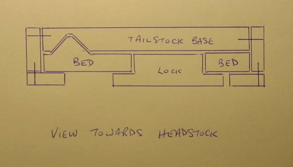

      After an extended period recovering from a fractured hip and the ME website turning itself inside out I am at long last allowed back into the workshop. One of the many tasks is to sort out the lathe tailstock and whilst the general plan is clear in my head I have a slight problem, how do I replicate the V groove as in the bottom of the existing tailstock base. My mill is a fixed head type and I don’t possess a tilting vice so without spending a fortune, any suggestions please?
      Thanks
      Martin

                          First job might be to measure the included angle of the prismatic section of the lathe bed.
                          I assume there must be an issue with the underneath of the tailstock mounting, so measuring the bed might be better than measuring the tailstock groove.
                          Bill

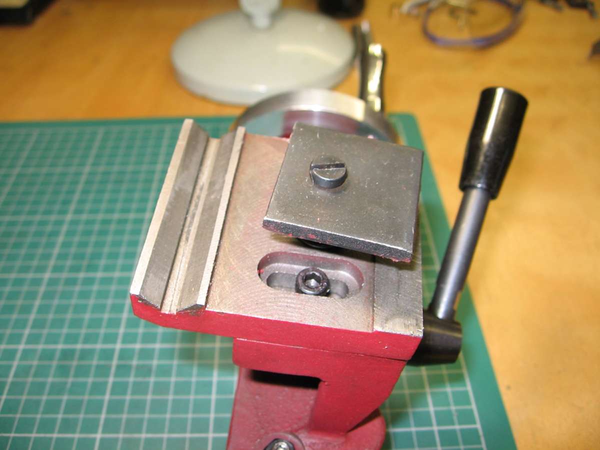

                                  Thanks very much for the useful suggestions, it does I suppose come down to how much I wish to spend on what is essentially a one off job, and availability. I don’t have access to a suitable sized shaper, nor do I know how to make a single flute cutter, which in honesty will take longer than the actual job and will I suspect be frustrating.
                                  The problem is with how the existing base is held to the main body, a screw through a slot with a recess for a cap screw head that isnt quite lined up, so forcing the horizontal alignment out. This becomes apparent when using a small centre drill that sometimes describes an eccentric circle rather than a centre, fortunately this hasn’t happened on anything complex and it can usually be pulled back.
                                  It is possible to see from the wear patterns that the base doesn’t sit down on the bed fully flat, especially at the rear and only uses less than half of the rear bed for support, for no good reason I can fathom. I cannot justify the cost of a sine bar and slip gauge set for a one off, so its probably going to be an angled parallel and an ordinary cutter or a 90deg chamfer cutter, the latter is perhaps the most convenient and indeed it will be in cast iron, I’ll take some measurements later and post the results.
                                  Martin
                                  #711093
                                    The slot for the can head screw can be corrected with a standard cutter or even filing, suggest a washer under the cap head would help too.
                                    As it sounds like there is little to come off the Vee and flat surfaces blueing up and scraping/filing is likely to be all that is needed. Milling could take off more than is needed and then you have to deal with a low tailstock.
                                    Also check that the flat  top of the Vee way is not touching the middle of the Vee slot as it looks a bit brighter in the middle

                                        The typical tailstock is slightly loose on its base and is clamped down onto it when the clamping lever is used. There are however two features that make sure the tailstock stays on centre. One is a keyway and key to keep the top parallel to the ways and the other is a horizontal screw or two and a point on the base for them to press onto for adjustment. I would not be using that inaccessible screw underneath for clamping, I would assume it should be loose and if there is no current adjustment on top then I would look to modifying it so that there was. This link has a picture showing these features, a key and adjusting screw just above it.

                                          I have measured the lathe bed, the angle of the raised v is as best I can measure it 44.2 deg on one side and 44.7 on the other, so 88.9 in total and possibly not symmetrical. THe original reasoning behind this was to both sort out the fit of the tailstock to the bed and also the arrangement for holding the body to the base and horizontal adjustment thereof. I decided a new base was easier than trying to make the existing one fit, I don’t believe I ever suggested machining the existing base, nor would I try. If in the extremes the centre was too low I can at least shim it to height. The other ideal was to use the tailstock lock to do that alone and retaining the unit on the bed was a separate fixing. The bit I didn’t know how to do beyond a vague understanding was cutting the V groove. I’ll do a wee sketch of my idea.
                                          Martin

                                            If the clamp screw is misaligned in some way and forcing the two halves of the tailstock out of alignment, I fully agree with Jason that the easier option would be to solve the problem with the setscrew., rather than trying to re engineer the base.
                                            As he says, probably all it needs is a little machining to provide clearance so that the foul, apparently causing the problem is removed.
                                            Fix the root cause, and life will be much simpler.

                                                  Similar thinking to Howard, but from a different perspective:
                                                  Your opening post referenced the difficulty of replicating the groove, and we now understand that the existing groove is imperfect as-is … That adds an order of magnitude to the difficulty of replicating it [which would be a futile exercise anyway].
                                                  To my simple mind the the Cart and the Horse need to be put back in their proper relationship !!
                                                  You already have a ‘nearly right’ groove in a lump of Iron … So spend some time on the manual fitting-work, and get that groove as near-perfect as you can … ignoring, for the moment,  all that surrounds it.
                                                  When you finally have a good slider … treasure it … because that is your reference for all the relatively simple machining that you will be doing to improve the tailstock arrangement.
