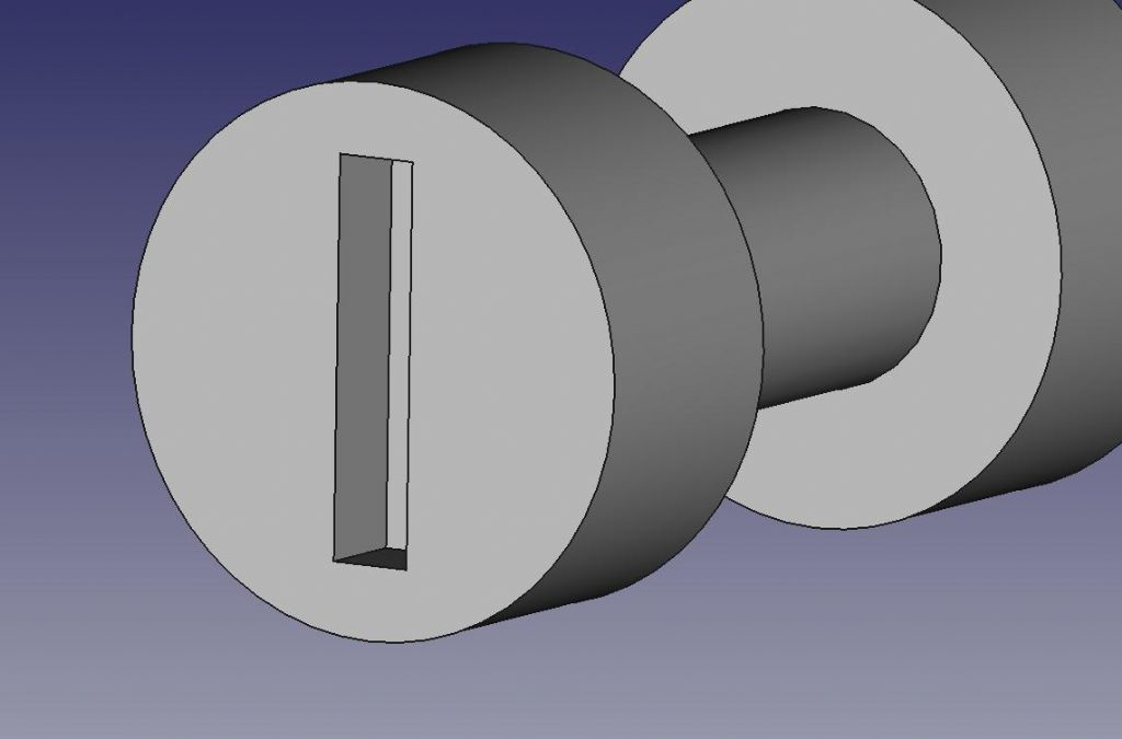

      I'm building a model engine that uses a dumb-bell shaped piston in the steam valve.
      It's occurred to me that the valve linkages would be easier to assemble if there was a slot cut in the end of the dumb-bell to take the end of a small screwdriver. I could then screw the end of the valve rod into the connection to the eccentric by twirling the piston.
      I can't cut a slot clean across the dumb-bell because the ends might align with the port and mess up the valve timing. How can I cut a slot like that shown in the picture that doesn't cross the full width of the piston? The piston is only 6mm in diameter, making the slot approximately 4mm by 1.5mm by 2mm deep.

          If you don't need the slot to have square ends then easy enough with a 1.5mm dia milling cutter, could even come down to 1mm.
          Other option would be a small dia slitting saw or single point tool and make a cut the goes almost all the way across with a concave bottom
          J
          PS that slot looks a lot less than 1.5mm wide if the end is 6.0mm dia
          Edited By JasonB on 08/12/2017 18:28:21

            Easy if you have a mill, just use a 1.5mm slot drill and leave the cutter radius in the ends. If you have the speed on a mill carbide cutters are cheap enough, some on this months MSC offer sheet.

                                  Wow I'm impressed. There I am completely stuck and the team come up with no less than eight suggestions!
                                  1. Mill the slot with a small cutter
                                  2. Cut a semicircular slot with a small slitting saw or a Woodruff cutter, or a Dremel cutting blade might do the job.
                                  3. Use an existing bolt or shoulder screw to make the dumb-bell
                                  4. Drill a pair of holes and make a peg screwdriver
                                  5. Buy or make a Rotary Broach
                                  6. Glue a nut on the end
                                  7. Find a friend with EDM.
                                  8. Do the slot in reverse by leaving a tab or tang sticking out the end
                                  I'm entertaining the family today and will be able to ponder possibilities for tomorrow. At the moment I'm favouring #2 over #6 because steam might melt the glue. Even so I think I'll invest in some small milling cutters and the Hemmingway Broaching Kit as well. My only objection to #4 and #8 is the need to make a simple tool as well. Easy enough to do, but it's the sort of special I can't find when I need it.

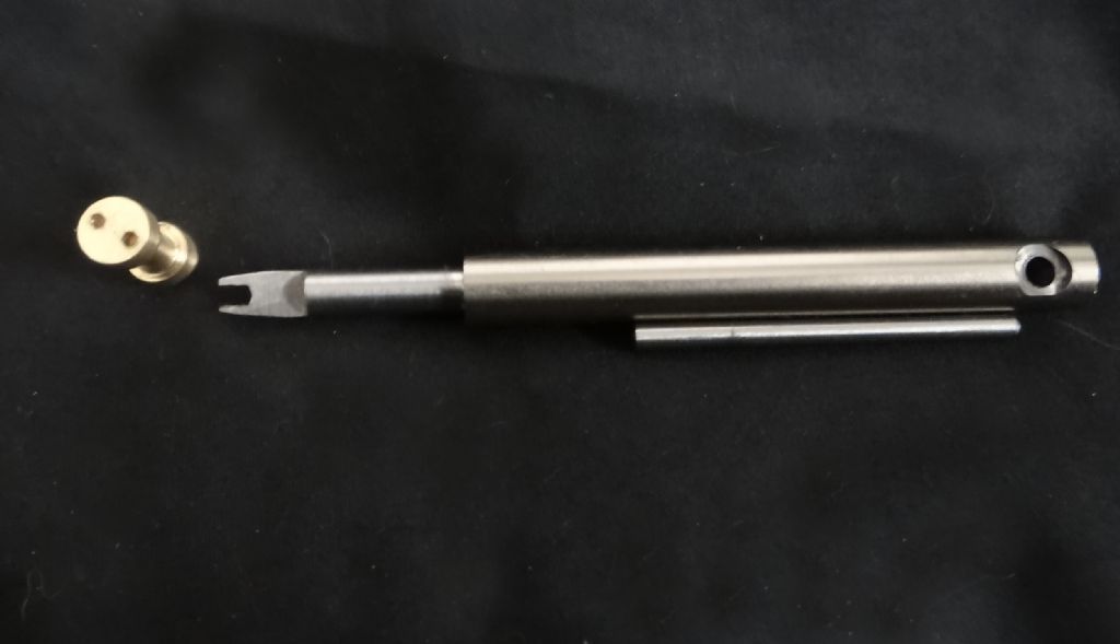

                                                    Just in case anyone's interested I set to, drilled holes in the piston head and made a pin spanner to fit. Works very well.
                                                    Much to my amazement the engine ran first time I connected air. That's a first! Still looks a mess though; I'm having real trouble getting parts to look good as well as function properly. Looks like there's still more learning to do. Gawd knows what will happen if I try painting it.
                                                    Thanks again for all the advice. I'm going to try some of the other methods later.
