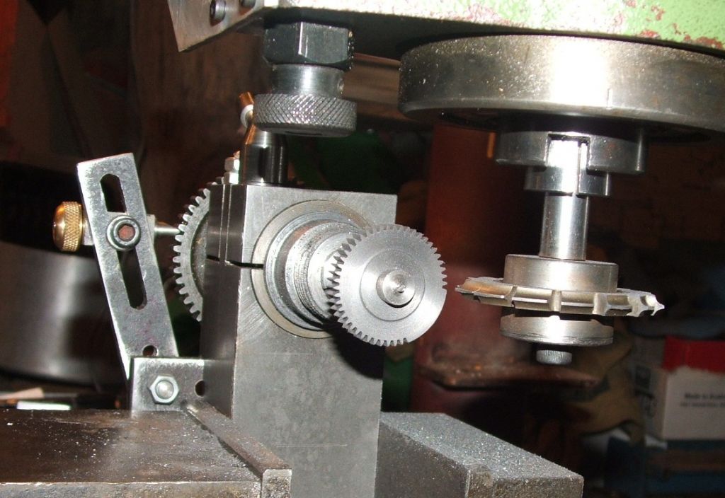

            Indeed he do Wolfie – look here   http://www.homews.co.uk/index.html, be warned tho’, you will spend a bit of time there.
            Yes Harold, the advanced one it is – I’ll contact you, as you suggest. Thanks!

              If though you get into making workshop equipment it is likely that there will be occasions where this is not appropriate. For example, in the case of the milling cutter chuck, chapter 13, concentricity of the taper and the working end (the cutter chuck) is vital, and is best made as one piece.
              At some time you may like to make an item with an internal Morse taper, such as Tel’s dividing head. In this case, unless you purchase an expensive Morse taper reamer, machining your own taper is the only way.
