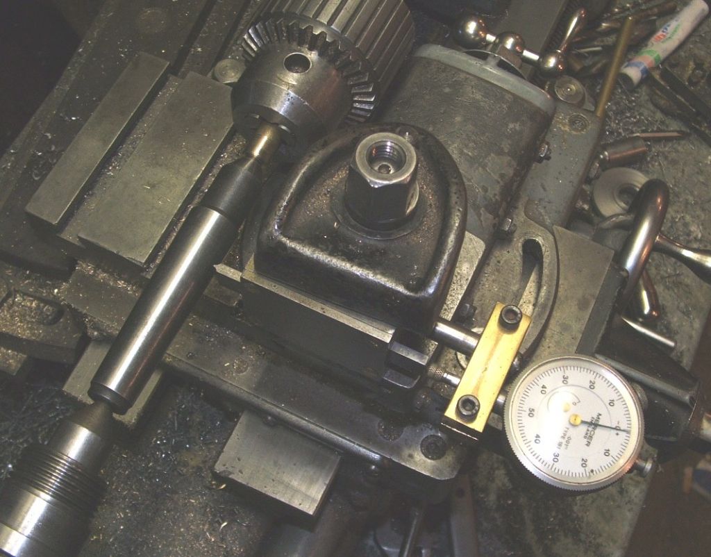

                    The set up looks like this – please note, however, that in this shot the centre is in the wrong way around for what you want to do – I was setting up to cut a 2MT socket at the time!
                    Edited By Tel on 30/11/2011 09:21:53

                                Don’t get lost in the numbers Wolfie – just get hold of a known, good, MT2 centre and work from that.

                                    I do like Tel your method of extending the reach of you dial indicator.
                                    Harold

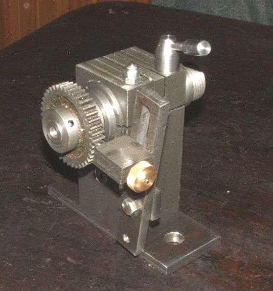

                                        Please take a look at my tailstock die holder here:
                                        My starting point was a MT2 taper I bought from Chronos (?).
                                        Please note the rod glued (and pressed) into the MT2 is hollow allowing me to do longer work.
                                        Rehgards
                                        Dias Costa

                                            Thanks Harold – that gadget has the added advantage, not really obvious in the pic, of the blade being about 3/8″ wide, set vertically, so that, within reasonable limits, you are not concerned with setting it on centre height – one more little simplification to the process!
                                            AND I was working on one of your projects at the time!

                                                  With that explanation Tel, I like it
                                                  even more!
                                                  Pleased to see you have made the
                                                  dividing head, looks good, the design appears to have become quite
                                                  popular.
