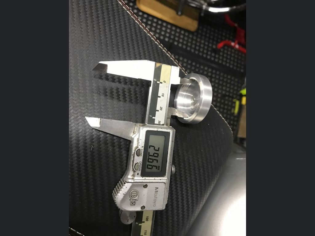

      Hi guys – son is using a warco 240 lathe to make motorcycle fork nut caps – is there a quicker way to make a large internal rather than using the boring tool and taking 0.3 mm cuts from the centre – not sure how else to describe this – one is a 47 mm internal and the other a 30mm wide and around 10mm deep
