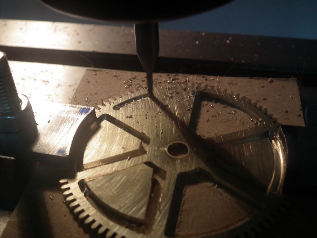

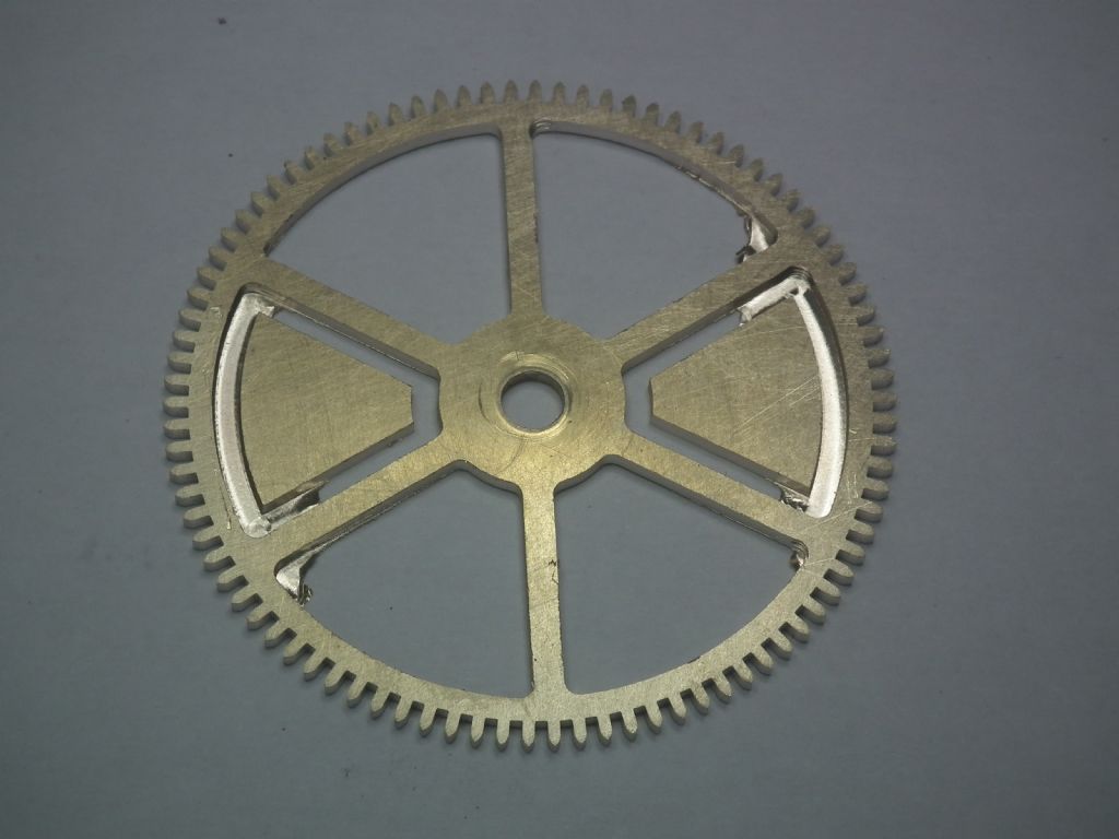

      Having spent hours with the piercing saw on my last clock I thought I would try cnc profiling for crossing out the wheels on my English Regulator. I drew up the cutting path using Draftsight, exported a DXF file, and used DXF2GCODE to generate the gcode file. That took about ten minutes. Then to the mill.
      I used a dowel in the chuck to centre the wheel in the zero position before clamping, changed to a 2 mm end mill and off we go:
      The machining of a 2 1/2 inch diameter wheel took 24 min. Taking it very slowly and making the cut in 3 stages with a 2 mm slot drill. The result wasn't quite what I had hoped for:
      I had clamped it to a thin MDF board and didn't allow for the fact that the wheel would bend by a few thou due to the resilience of the MDF. Still a few minutes with the saw and needle files soon fixed it.
      The next one came out better with a deeper final cut.

          Tapered 'spokes' would look so very much more elegant.

              Yes, tapered spokes would look more elegant but I don't think you could get enough taper for it to look good without either weakening it or increasing the weight. For the lower wheels in the train it's most important to minimise weight in order to reduce the pivot friction, for the escape wheel the moment of inertia is probably more important due to the intermittent motion. I'm not clever enough to calculate the exact requirements though. My clock will be driven by a 15 or 16 lb weight so the strength is important.

                Can I ask what make/size of mill you used? Also what level of 'repeatable' precision/tolerance you achieve?
                I have a project that requires a quantity of small brass CNC components but they need to fit together to quite a high tolerance, Is +/-0.01 doable?
                The wheel you show looks really good, you going to remove the cutter radii in the corners by filing? It would make a big difference to the appearance

                  The mill I used was a Seig SX2 Plus which I converted for cnc. See this thread on another forum. The convererted mill has about 1 thou backlash on the X and Y axes and I've just done some measurements on one of my wheels and the biggest error I get is 3 thou which sounds about right.
                  I expect John will come back with some advice but I would guess that you will need a much more rigid machine if you want 0.01 mm tolerance. If I put a dial gauge on the side of the spindle and lean on the head I get about 0.06 mm movement due to the column flexing.
                  Yes, sharp corners are traditional but a radius is a better engineering solution. I will of course file and polish the edges but I might leave the radius. I'm trying to build a precision clock rather than an exhibition winner!
