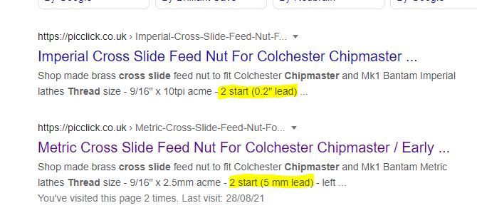

                              The original poster has said that one turn of the wheel moves the cross-slide 5mm. I have measured the same thing on my own machine this morning. Are we both mistaken? Are we both lying?
                              In effect, you are trying to claim the cross-slide pitches of imperial and metric Chipmasters differ by a factor of two. This is not sustainable. Even without detailed knowledge of the machine, consider what would have to change in the power cross-feed gearbox mechanism were this to be so and its linked effect on the longitudinal feeds.
                              The Chipmaster was made in both imperial and metric versions and it is more economic for the manufacturer to make as many parts of the two machines as close to each other as possible: all leadscrews same diameter and thread form, just different pitches, apron gears, handwheel and rack similar, gearbox layout, size and shape the same just with different internals.
                              The two machines need to offer a comparable range of speeds, thread pitches and feed rates. Changing something like a leadscrew pitch by a factor of two makes doing this difficult and expensive.

                                Be careful with a quick google search, reading further the couple of refs are 9/16" x 2.5mm then if you click the link it says double start 5mm lead, I made that mistake this morning.
                                Edited By JasonB on 29/08/2021 10:05:50

                                  So, if the Leadscrew has a 5 mm LEAD, 50 divisions on the handwheel will give a 0.1 mm increment per division.
                                  If this is DIAMETER, the tool will actually advance by 0.05 mm which seems reasonable distance, since smaller increments can be estimated between the marked divisions.
                                  The real check is to measure before and after.taking cuts.
