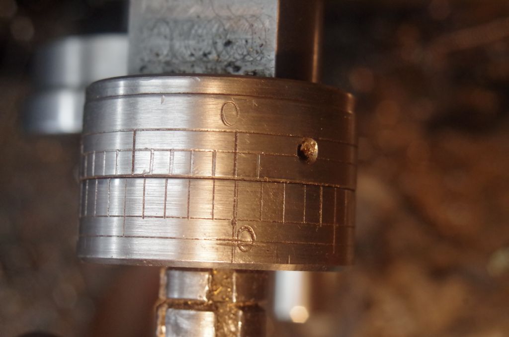

      #472051
      oldvelo
        @oldvelo
        Possibly of use to someone reading this thread 2 mm pitch crossfeed screw with vernier scale on the static dial
        to read in 0.01 mm increments with the Static Dial on the top.
        Rotary dial has 40 divisions. Static dial has 44 divisions. Readings are on the work diameter trom right to left.imgp3352.jpg

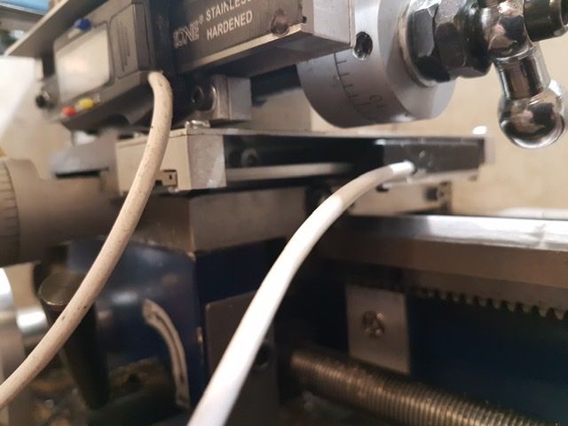

        Stuart Smith 5
          @stuartsmith5
          Andy
          My lathe is a cj18a mini lathe from amadeal – I think the same as yours.
          Here is another photo of the way I mounted the caliper for the crosslide. It stops access to the carriage lock, but other than that I haven’t found it a problem. The caliper for the top slide is ok apart from when you want to set it at an angle – I have to unscrew it then.
          Crosslide caliper
          I found a couple of issues with the cheap calipers which I managed to fix in the software/ interface. Because I am powering the calipers from the interface PSU, when I switch it on it always starts in inches mode and after a while, the output from the calipers stops (they go to sleep). I have used extra outputs from the Arduino to automatically change to mm mode and to detect if the output stops and switch it back on.
          The touch DRO app has the facility to add 2 readings so I have mine add the top slide and carriage caliper outputs and display as one.
          If you decide to have a go with these calipers, let me know and I can send you the code and interface details.
          Stuart
