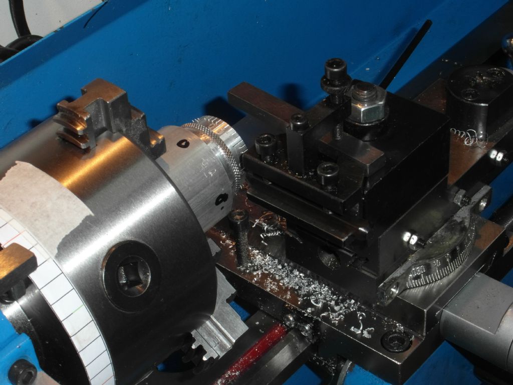

      I bought a CJ18A mini-lathe a few months back. It's not at all bad for the price, but there are aspects where there is room for improvement.
      One of these is the maddening 0.025 mm divisions on the dials, presumably a 'close enough' approximation for those who would rather work in thousandths of an inch. I prefer to work in metric and being rubbish at mental arithmetic, they do my head in – I have to constantly refer to a cheat sheet or use an increasingly oily calculator to work out what cut to put on.
      So, fine, I'll make some new dials with proper 0.02 divisions, but whilst I'm about it, how about doubling them up for the cross slide so that the dial shows the reduction in diameter rather than radius, and save myself even more mental arithmetic.
      I know some lathes have this arrangement but I've never used one, and wondered if anyone has any opinions on whether this is a good idea?

              Thanks Pete. I'm using this method to stamp the numbers:
              It's a bit hard to see in the photo, but the number stamp is laid in the toolholder with the clamping screws just touching it and pushed by finger up against the rear face, then a tap with a hammer and it looks acceptably neat.
              OK, I confess the taps with the hammer weren't as hard as they should have been, so after a clean-up skim they're a bit faint, so this one is going on the top slide. Which is good, because it gave me time to think of posting this thread.
              And yes, that really is a dodgy amount of jaw to be protruding from the chuck…

                What is the actual pitch of the leadscrew? 0.025mm divs would suit a 2.5mm pitch but you would be left with an equally hard to keep track of 125 divisions if changing to 0.02mm.
                Changing to 0.05 off dia sounds like the best option provided it's not actually an imperial 10tpi leadscrew that has just had metric handwheels added.
                #471808
                Andy Stopford
                  @andystopford50521
                  No, it's genuine 1mm pitch metric fortunately
