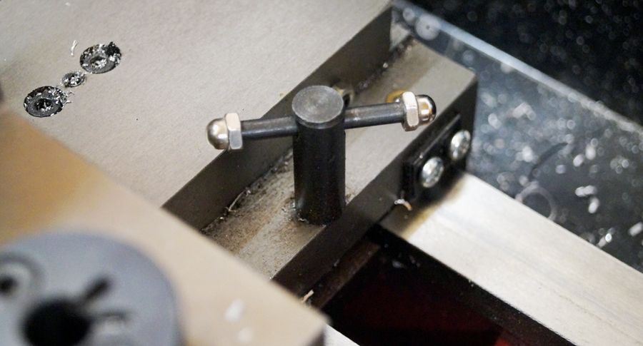

                                          I used a flat piece of aluminium bar bolted to the saddle, with a thru bolt to a clamping plate running underneath the slideways…
                                          I'll take a picture tomorrow and post here

                                          Ron Laden
                                            @ronladen17547
                                            Andrew, as mentioned previously my CJ18a and your Warco Super Mini look to be almost identical machines so I am surprised yours doesnt have a saddle lock as mine does. I dont like the naff little handle on mine and intend to change it but the lathe does have the means of locking the saddle to the bed.

                                              Ron. Both sides / ends of the saddle are clear of features except for a single tapped blind hole on the chuck side that's in the position of your T wrench. There appear to me more variations on that basic lathe than I've had hot dinners which makes for interesting conversations and also quite a lot of confusion.
                                              The cheapest conversion that I've found on a Google Images search has been a chunky T which would fit between the two tracks. I imagine that's the sort of thing yours has.

                                                Hi Andrew,
                                                Yes the clamp plate is an inverted T, you can just see it in the picture. It would be dead easy to make something up and by the way mine is not on the chuck side but the tailstock side.
