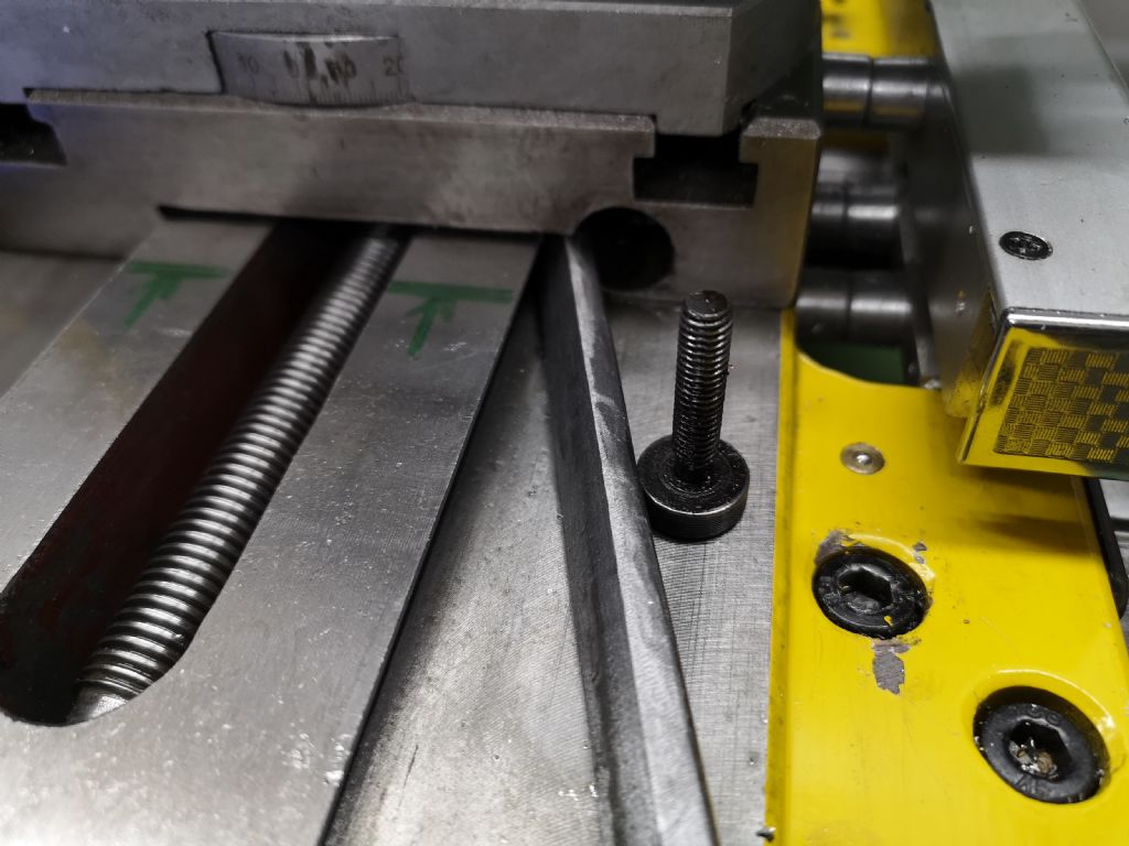

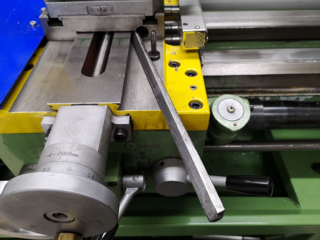

                      Hi All, and I hope a Happy New Year becomes a reality for all of us.
                      I've just taken out most of the backlash on my 290V cross slide, the brass nut has two tiny hex grub screws on its rear end for a 1mm hex key to allow the 1mm or so slot cut across the nut to be closed around the screw threads, and is easy to get to on this model. That was the easy part.
                      However, can any of you much more knowledgable gentlemen please enlighten me on how the cross slide gib is supposed to be retained and adjusted? There are no gib screws along the side of the slide (unless they used them for the DRO scale mounts!), only this flat headed screw in the front which I thought would have locked the gib in place on tightening. Today, however, after stripping it to clean and re-lube the ways, I find that no matter how much I tighten the screw, when I wind the slide back towards me (front of the lathe) the gib gets pulled in and locks the whole thing up! Any help greatly appreciated, as always.

                          Looks suspiciously as if that's exactly what they've done – the gib adjusters are behind the DRO, which has to be removed to adjust them. Can you get a better look behind the DRO? Allan head screws with lock-nuts?
                          May not matter provided the scale is fairly easy to remove – once set up gibs don't need frequent adjustment. Can't remember when I last tweaked mine.
                          #516835
                          Dave Halford
                            @davehalford22513
                            Isn't that a wedge type Gib?
                            That screw pushes the tapered gib in, same at the other end of the slide. adjust them equally or something like that.

                              That tapered gib doesn't seem to have the cutout for a single screw to adjust it, so there is probably another screw at the other end. It takes careful and delicate adjustment to remove the backlash and not have the lot get too tight. The front screw tightens and when things get tight, then back it off about 10 degrees and tighten the rear one. You will then be close and very small ammounts of adjustment will finish the job.

                                There should be 4 gib screws…if you can’t see them, then they have used the threaded holes to mount the dro, which. Is quite odd..you need to remove the dro to see what’s been done..you may need to re Mount the dro by making additional threaded holes

                                    Hi Terry, looks like a tapered gib to me and as old mart has said, there should be another screw the other end, just back that one off a little and screw the front one in. repeat until you are satisfied with the adjustment. If the cross slide goes too tight, just reverse the process.

                                          Some gib strips of this type have a slot into which the Adjusting screw fits. In this way the gib is pushed in as the screw is tightened, or withdrawn as the screw is slackened. They can change their setting with vibration from milling or turning.

                                            The below quote is from a Wm290 thread on this forum.
                                            It would appear they have gone to a tapered gib to accommodate the DRO fitment.
                                            "What it definitely doesn't have is a cross slide lock – I know some of them do, but the new ones with the tapered Gib don't".
