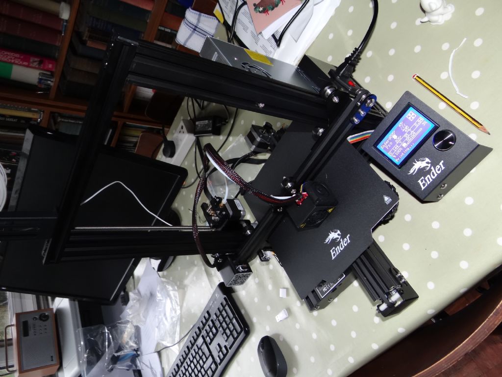

        Bought myself a Creality Ender 3-Pro printer for xmas and thought I'd report progress. I chose the model based on good reports – it's the go to choice at the moment for a low cost starter. Arrives as a part built-kit, fairly basic, but allegedly produces reasonable results. (Sorry about orientation!)
        I want the printer to produce small plastic components for other projects. For example, I'm crawling towards building a small horizontal steam engine with Arduino controlled electric valve gear. I'm interested to see what the engine will do with four independent valves providing total flexibility over valve events, allowing experimentation with lead, lag, expansion and timing etc without having to rebuild mechanical valve gear. I intend making 4 solenoid steam valves myself, mostly brass, but with a purpose made plastic coil former.
        Also interested in the practicalities – strength of 3D objects, overhangs, dimensional accuracy, software, and how long it takes to make something for real. (5 minutes or 10 days!)
        Anyway, the printer took about an hour to assemble and another two to debug due to some spanner mixing a pair of plugs & sockets up.

          Although assembly isn't complicated, I found the instructions to be a shade too minimal. There's a single sheet self-build furniture style picture sequence showing how the parts join together. Then the new owner has to find the Operating Manual and Troubleshooting Guide. The Troubleshooting Guide looks quite good, but the Operating Manual is also a shade too terse for me. Nonetheless, I got the printer to power up without having to seek advice on the Internet.

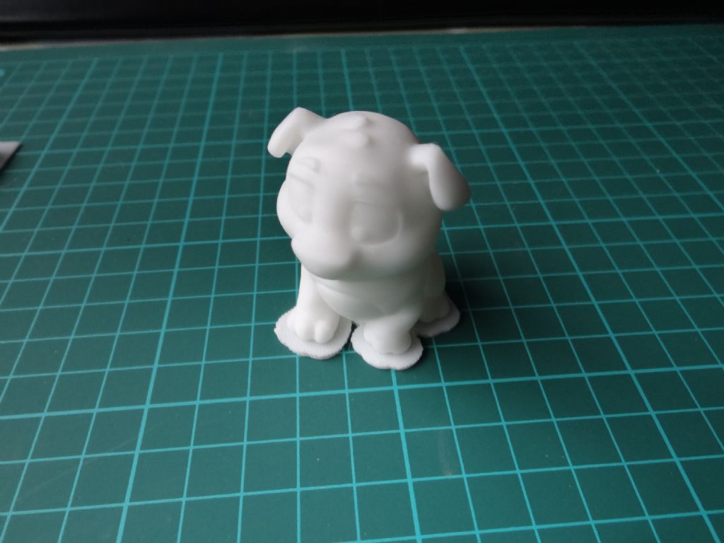

          First model is the dog supplied by Creality to test the printer. Although I don't want a dog, I printed one to see how well the printer would behave with a model supplied by the seller. It should be good, and it was.
          Apart from taking 3 hours to print!

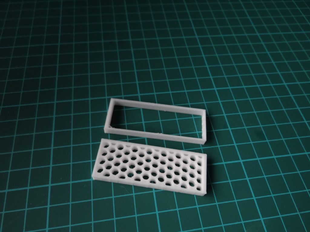

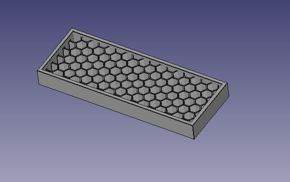

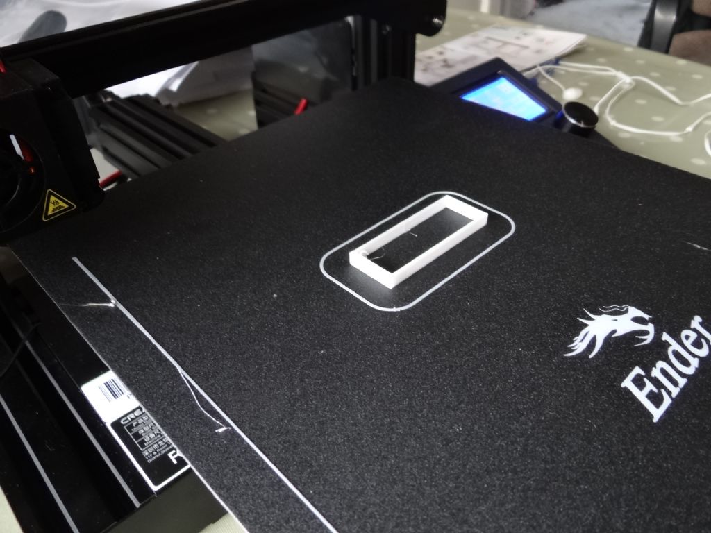

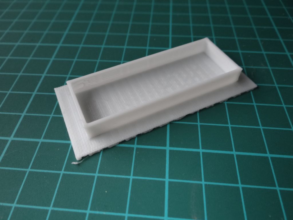

          Next, I tried a home-designed honey-comb structure intended to see how well the printer would cope with a fine internal structure.
          Didn't work properly, checking back there's an error in the honey-comb section of my FreeCAD model. However, the outer frame printed OK. Specified to be 58.38mm x 21.75mm, it printed as 58.2 x 21.7mm.

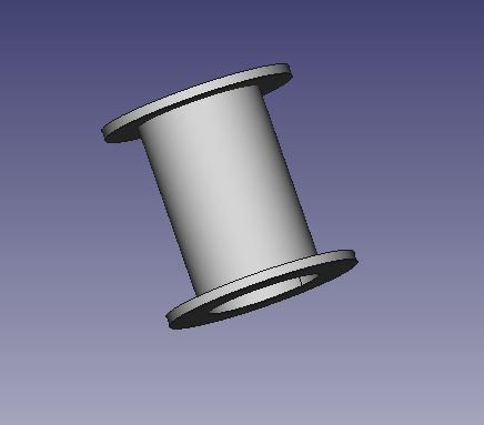

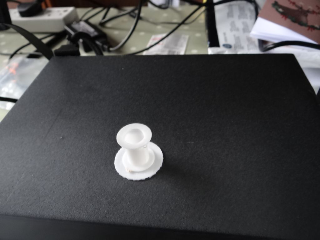

          Next was the coil bobbin needed for my solenoid valves. This is 20mm diameter, 20mm high, with a 12mm diameter hole. All surfaces are 1mm thick.
          This printed well in 21 minutes, and I was particularly pleased to see a reasonable top-plate – I expected it to sag, but the software was intelligent enough to build the overhang in sensible stages. Dimensionally quite good; 20.00mm base diameter, 20.03 top diameter. The centre hole is most faulty, a rim formed narrowing the 12mm interior to 11.52mm at the very top.
          The dog is near perfect The most obvious problem with the honeycomb and bobbin are the solid raft laid down first, which will have to be removed. The raft must be a software feature. The bobbin has a minor flaw due to a blob of plastic building up on the print nozzle. The underside of the top-plate is slightly untidy, but the bobbin is perfectly serviceable.
          Conclusions: Pretty impressed for the money. Not ultra-accurate and printing takes ages. No problems on the software side that can't be blamed on me. Objects are likely to come off the printer needing some remedial work. There's a lot more to learn.

                I drew a test cube for mine 20mm cubed with a 12mm hole through it. The cube came out 20.15 at it's worst and 20.05 best. The hole was 11.75 or so.
                I think your honeycomb didn't print because the edges were too thin to be 'recognised', What thickness did you draw the walls of the cells?

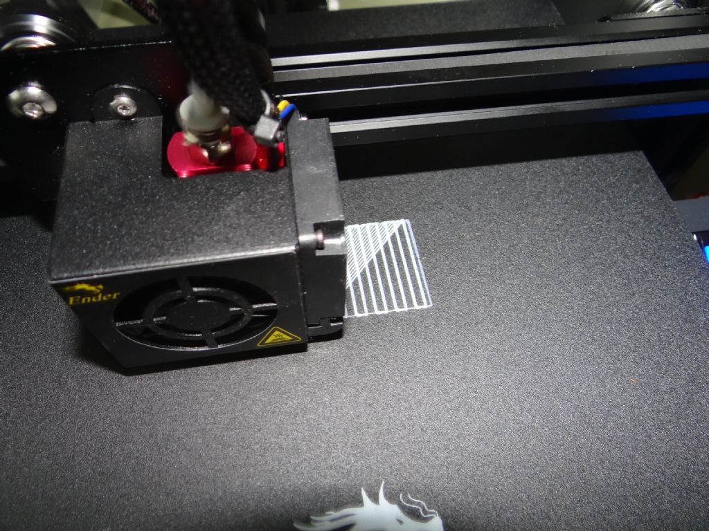

                          Not being very methodical this morning; I'm watching another attempt to print my honeycomb object fail. The original object was drawn (with an error) and sliced on Window10 with FreeCAD and Creality Slicer. Now testing with FreeCAD (drawn with no errors) and Cura on Ubuntu 19.10 All working apart from the fine honeycomb centre.
                          As the walls are only 0.25mm thick, Pete's suggestion that they are too thin to be recognised seems highly likely.
                          Back to the drawing board!
                          Observations:
                          Works equally well on Linux and Windows. Might steal daughter's Apple for testing later…
                          Creality's Slicer and Cura are remarkably similar, except Cura has more control making it slightly harder to drive. At the moment I'm using both out-of-the-box without playing with any of the settings. I got both slicers to work without reading the manual! By default Creality's slicer lays down a solid bed as shown developing below:
                          In contrast, Cura starts by clearing the nozzle by drawing a long line along one side of the bed, then draws an oval, and then prints the object directly on the table. The gcode that squirts start-up plastic is accessible if I decide to change it.
                          Having read it's more forgiving than other filament plastics, I'm printing with PLA.

                            I quickly knocked up a honeycomb and printed it. The cell walls that were wider than 0.4mm printed fine but the walls that were 0.4mm exactly didn't print.

                                The problems you are having printing the honeycomb will be down to settings. You probably have wall thickness set at a value greater than the wall itself making it theoretically impossible to print.
                                Think using a 6mm slot drill to mill a 4mm slot.
                                But it can be less obvious than that too. Your slicer might be trying to produce the wall in multiple passes. You cant produce a .4mm wall with two walls at .4mm (2×0.4=0.8) if you see what I mean.
                                You can view a test in cura before printing. It should show any parts unlikely to print properly.

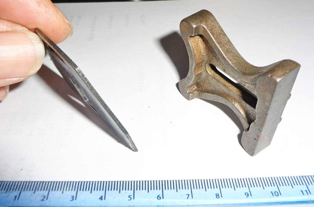

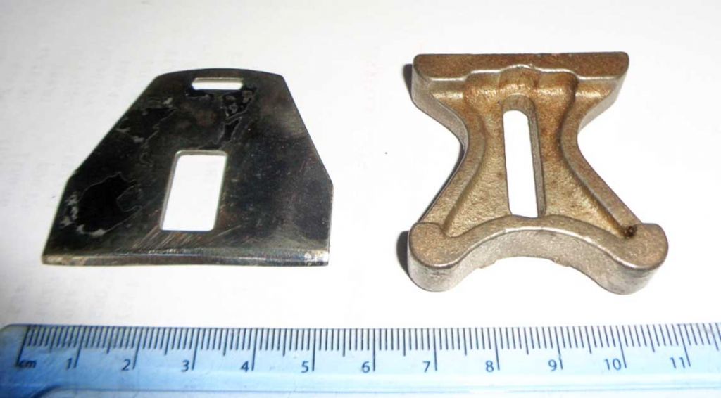

                                  Here is an original hard to find cast iron plane fence and the 3D print taken from its measurements:
                                  Dimensions were all good within acceptable limits.
                                  Cheers, Martin

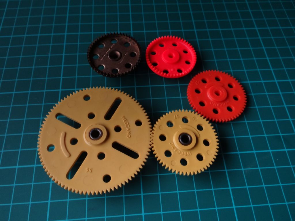

                                    Inspired by SOD's list of steps making it look easy and another thread on Hobbymat change wheels I have drawn up a small gear with the hope of getting it printed at work while people are still feeling the helpful Christmas spirit.
                                    However I'm wondering about the strength of teeth and whether there is an easy way of making the outer 3mm solid while reducing infill.
                                    Or would it be better to just thin the body to 3mm but grow out to 10mm at teeth and boss and do it all at 100%. I might do one like that as an exercise in Freecad anyway.
                                      The right choice of filament should allay any strength fears? Carbon loaded? Perhaps reinforcing, afterwards, with dowels in printed holes would provide extra rigidity? I’m thinking of getting a printer shortly, but have to wait for the too-popular Sovol to become available again…. and looking forward to IanT’s reports which hopefully will come along shortly.

                                        Whilst I'm a million miles away from knowing the answer, 3D has many possibilities. As NDIY says, some plastics are stronger/harder/ less brittle than others. That might be 'good enough'. Also possible to use the printer to make a mould, opening the door to casting iron, brass or Mazak.
                                        Very straightforward to put holes or add rims & other extra thickness on the printed gear by design. Looking at Meccano gears, they've not changed much. Note the slightly beefed up plastic centres compared with the riveted brass boss, otherwise Meccano plastic gears are almost identical to Meccano metal gears:
                                        (The orange gears are modern French Meccano; instead of a brass boss and set-screw, they slide on to triangular oblate rods rather than round axles. Interesting example of value engineering: rolling triangular rod must be much cheaper than making gears fitted with brass bosses.)

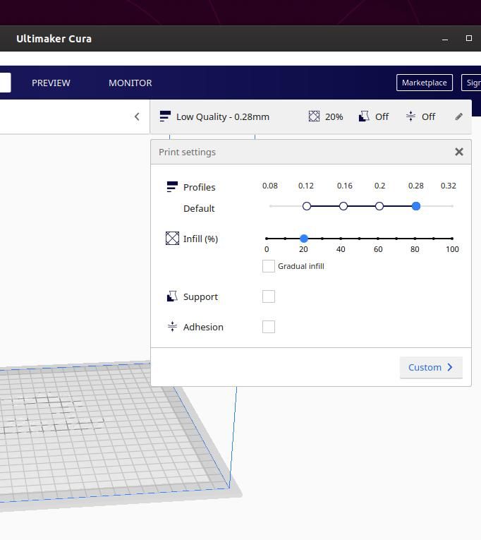

                                        In addition to adding material to weak areas during design, the Slicer may also allow control over what the printer considers 'solid plastic'. This screenshot shows Cura's settings:
                                        One of the print settings controls 'Infill', shown set to 20%, which means the object will be printed quickly but light and weak compared with a 100% setting. Not clear to me exactly how the software identifies 'infill', looks to me as if outer edges and thin structures are always 100% solid.
                                        Meanwhile, I successfully printed my honeycomb object, as Pete said I'd made the hexagon walls too thin for the printer.
                                        Encouragingly, the print with honeycomb is the same outer size and shape as the failed print, showing that my printer is precise (repeatable) within about 0.1 mm.
                                        I'll try printing a Meccano compatible gear later: be interesting to see how it fares in a metal gear train. Or not…

                                          I’m almost certain that the Meccano gears are injection moulding, which of course can be more homogeneous than something built from extruded filament.

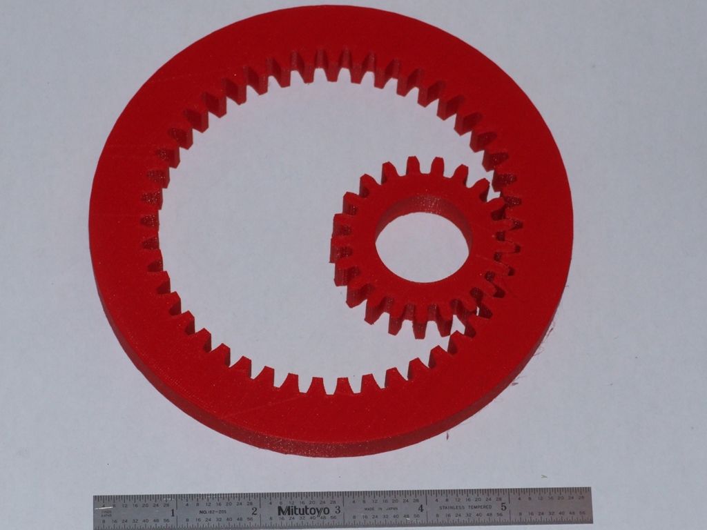

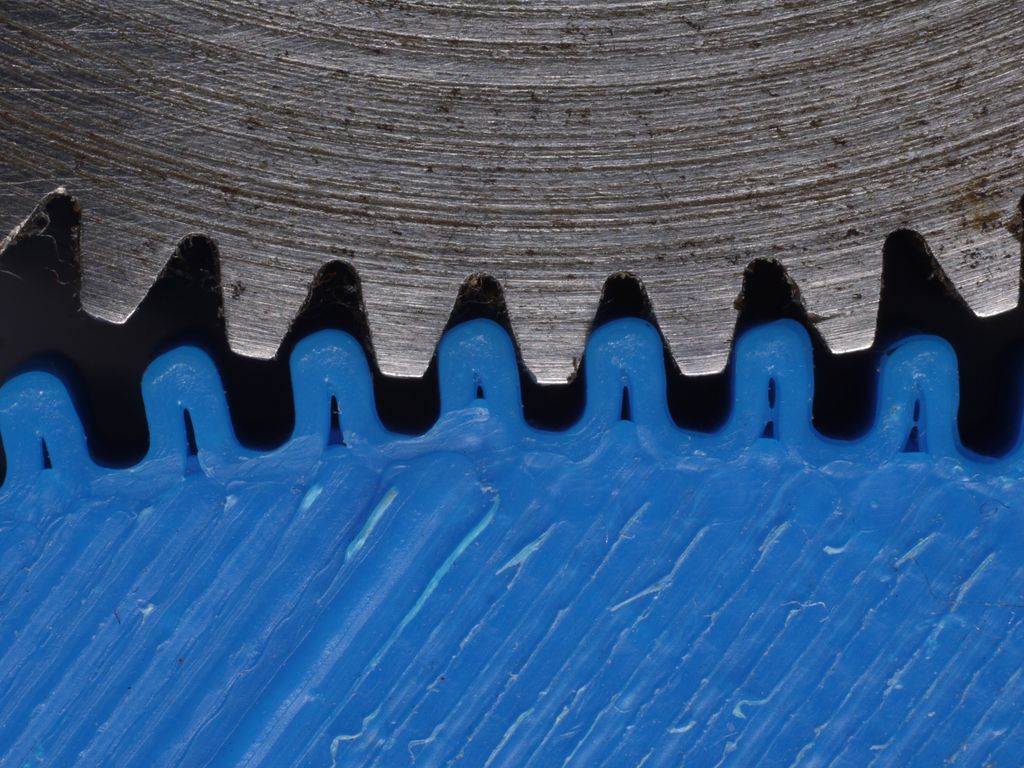

                                            No idea about tooth strength, but I'd be more worried about wear. If you can draw the gear then you can 3D print it:
                                            To get solid teeth I just increased the wall thickness to make the teeth solid, while leaving the body with infill. The gear tooth shapes as shown were accurate enough to exhibit trimming interference. Changing the pressure angle solved the interference issue.

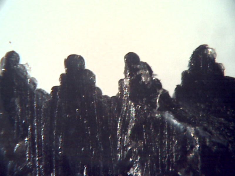

                                                These date back to 2017 … so things may have improved:
                                                Section of 0.75mm screw thread:
                                                32 DP Spur Gear:
                                                At the time, I decided it was too soon for me to buy

                                                    The rectangle with the honeycomb has failed because it's a solid. The honeycomb is drawn and will have 2 permeter walls and an infill between them. Every hole will have a perimeter and the slicer will be quite busy with all those
                                                    If you just draw a solid rectangle and tell the slicer you want a 0.8mm wall/perimeter and what infill pattern you want this would give you what you wanted. The creality slicer doesnt do honeycomb pattern only a straight line. Cura does a large list of infill patterns but no honeycombe. This is probably because of the extra movements needed that will reduce the speed. Most of the infill patterns (there are 13) use a combination of straight lines.
