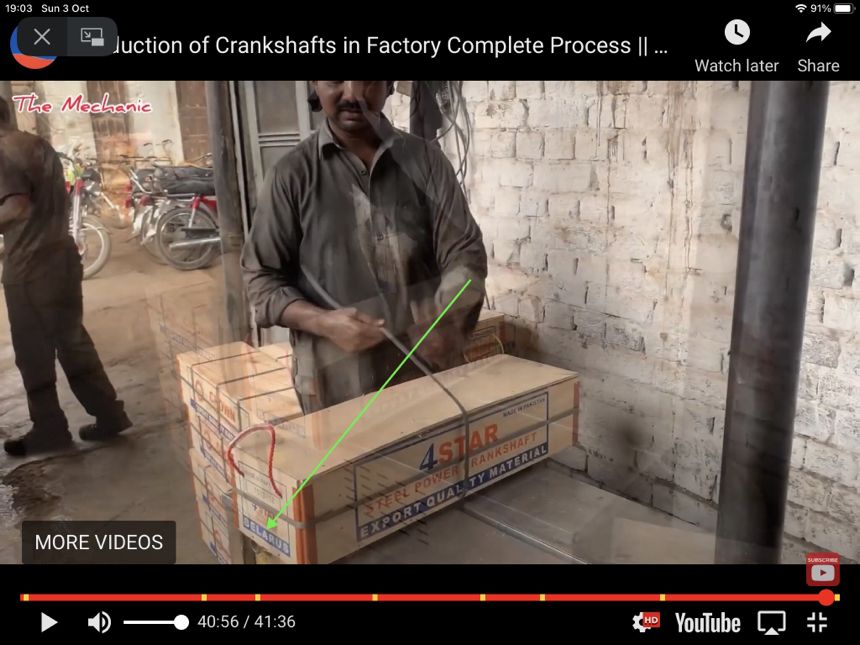

              Am I right in thinking that the ‘Final Check’ is done without any lubricant ?
              #565241

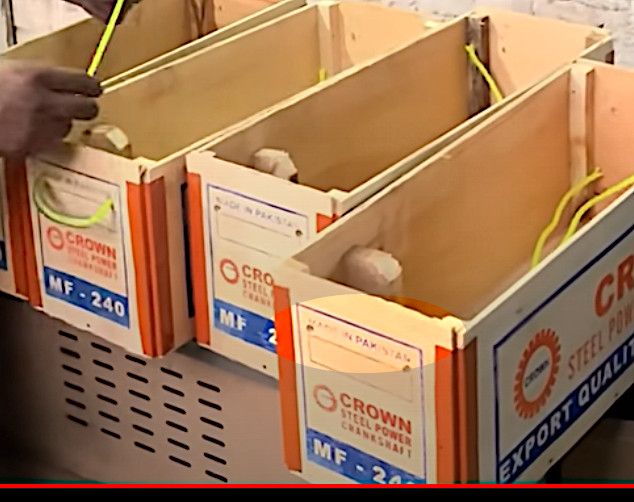

                Aha … ‘Export Quality’ Tractor Parts from Belarus
                Search for: crown mf-240 crankshaft

                                          Andy Stopford
                                            @andystopford50521
                                            Judging by the uploader's other videos, its in Pakistan. Most of the others seem to show (heavy) vehicle repairs rather than manufacturing.
                                            There's one which shows a truck front axle being overhauled. To us it seems strange to see people belting kingpins, etc. out with sledgehammers when they have a large-ish hydraulic press in the background (later used to straighten the axle beam), but it may be that given a surplus of labour and little or no form of social security, its socially desirable to employ relatives and friends in what appears to be pointlessly labour-intensive work (I remember seeing the same sort of thing in Portugal in the '80s and '90s where every job would have one person actually doing it, and two or three hangers on chatting and passing the occasional spanner).
                                            Despite this, the truck repairers seem impressively skilled at making do with very limited resources – not even a workbench or vice (at one point they use the chuck of a lathe to hold the stub-axle carrier), and of course, no safety boots, or indeed boots at all.

                                                I believe there is a factory in Pakistan making MF240 clones for Africa and the Far East, and these would have 3 cylinder diesel, likely a Perkins copy. The quantity being made would indicate mass production. Not sure what the Belarus connection is, though there is a very large tractor factory in Minsk.
                                                #565407
                                                Paul Kemp
                                                  @paulkemp46892
                                                  As stated, shot peening, common in crankshafts, normally at the fillet radius or other areas of high stress reversal. Idea is to introduce a compressive stress into the surface such that as stress becomes tensile the tensile magnitude is limited. Helps prevent fatigue cracks propogating in the surface of the material. Very important on cranks this process has been used on that the important areas like fillet radius are not machined when undersizing the journal or the benefit is lost.
                                                  Paul.
                                                  #565420
                                                    Posted by john halfpenny on 03/10/2021 14:37:28:
                                                    Not sure what the Belarus connection is …

                                                    Andy Stopford
                                                      @andystopford50521
                                                      MF-240 knock-offs, made in Pakistan:
                                                      Somewhere during the film you get a brief closeup of the word "Perkins" cheekily cast into the crankshaft blanks.
