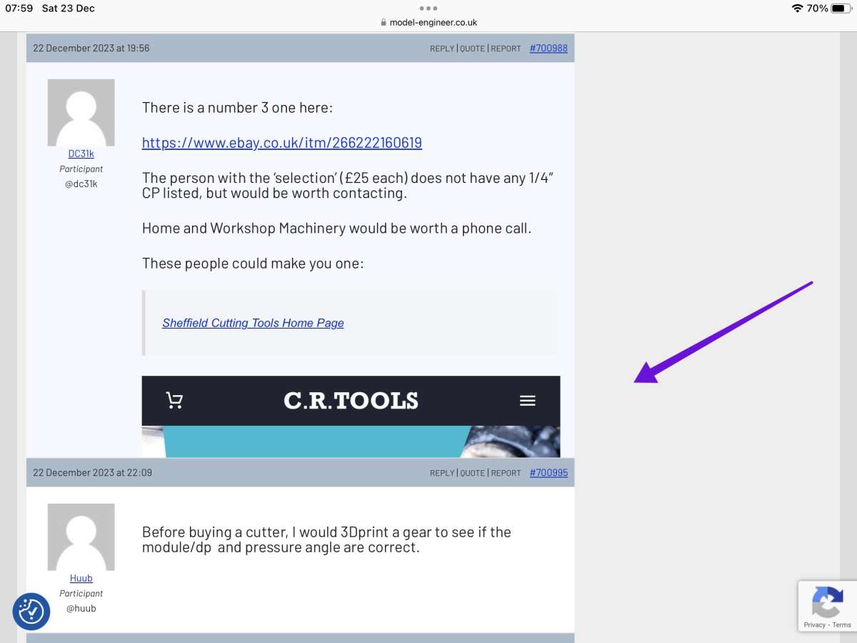

                        May I just mention an “off-topic” issue, which might deserve investigation by the forum developers ?
                        The C. R.Tools video in DC31k’s post is covering the text which follows
                        … I glimpsed it as the page was loading
                        #701024
                          Michael, having looked at what is in both of DC31k’s posts I can’t see a video, there is a url link for CR Tools website but all the text in the reply box is what is also being displayed
                          #701027
                            Must be Apple doing it’s cleverness then: rendering the hyperlink.
                            It’s probably just a ‘slideshow’ … but it certainly obscures some text.
                            IMG_9168
                            Edit: __ perhaps the ‘fix’ would be to dis-allow such rendering ?
