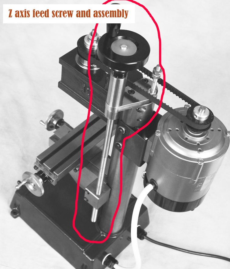

      Hi Folks
      Greetings to all
      I'm building a small table top mill with some thoughts from Cowells mill. I like the z axis feed screw vertically with a top handle rather the conventional position at the base with bevel gears. My mill has little room below the mill table. Hence, Cowells design is best to apply.
      Wonder anyone here can share photos of the assembly drawing or explain type of bushing and attachment design to the mill body and the table?
      Much appreciates ahead.

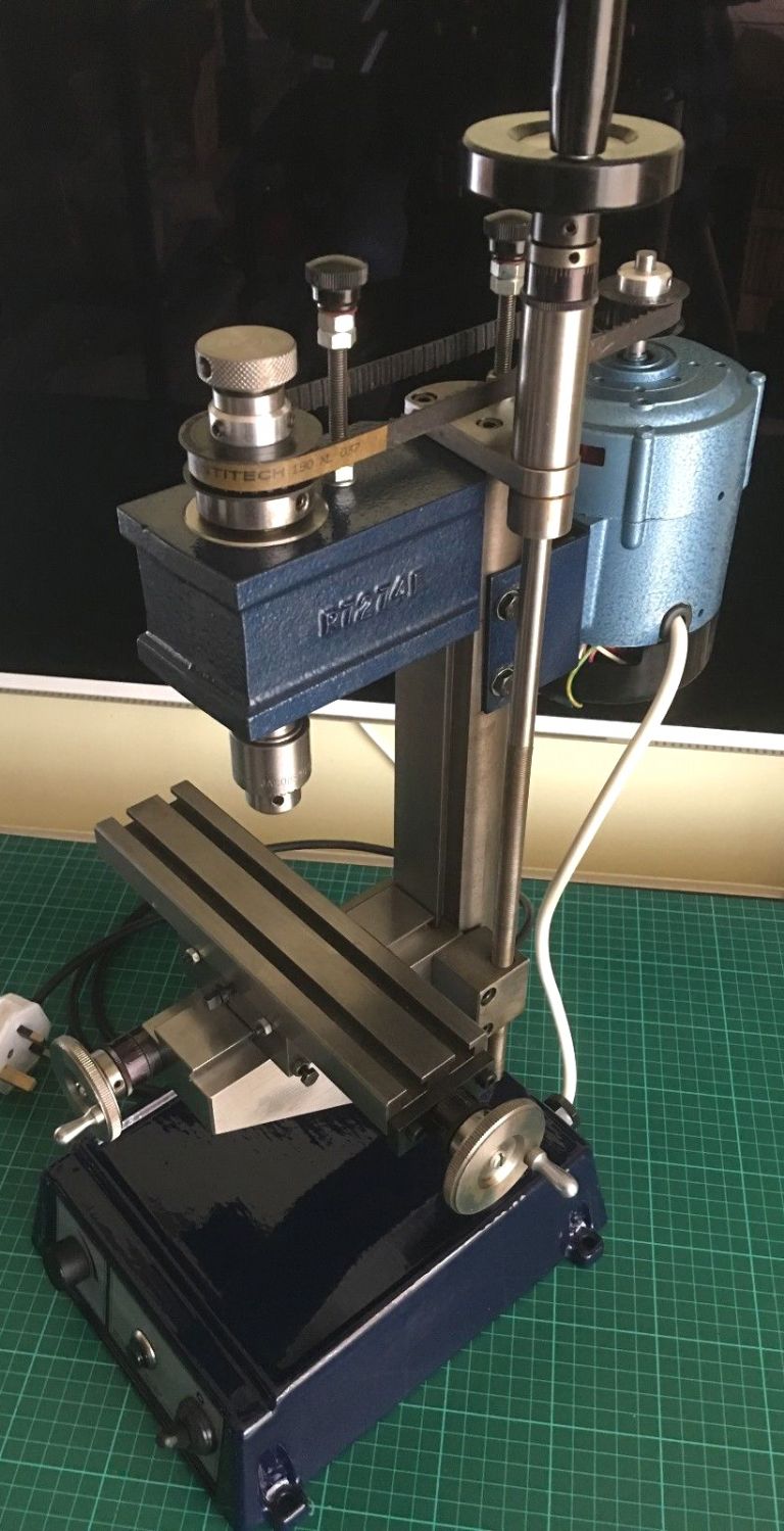

                    Posted by Steve Wan 1 on 15/05/2022 16:43:58:
                    … But I need to know parts here to join altogether.
                    I’m afraid you’ve lost me, Steve … this photo seems to illustrate it all rather well:
                    [Credit : http://www.lathes.co.uk/cowells-miller/ ]
                    Unless you actually want full drawings of the Cowells components, I would have thought there was plenty of information there ^^^ to show the design principle.

                    #598361
                      Another useful detail photo: **LINK**
                      http://www.cowells.com/Gallery/Vm16.jpg
                      #598409

                        Thanks, all the parts here are crystal clear just that I'm figuring out where's the best place to put the compression bearings? Below the hand wheel or the plate joining the pillar?
                        Of course if anyone would scan me the assembly drawing would the great!
                        BTW Bernard I have mistaken your word for Shoreline with Sherline I have both Sherline mill and lathe for years, Yes, I could copy the design.
                        Steve W.

                        Baz
                          @baz89810
                          What are compression bearings? I will take a wild guess that you mean thrust race, and that would go under the assembly that rotates.
                          #598448
                          Steve Wan 1
                            @stevewan1
                            Hi Baz, Yes thrust bearing. Any thoughts where's the best place to put?
                            Below the handwheel or nearer the feed screws? You own a Cowells Mill?
                            Steve W.

                            John Haine
                              @johnhaine32865
                              Steve, the clue is in the name, thrust bearing. What direction do the forces act when you operate the screw?

                                Have a look at this, Steve : **LINK**
                                https://www.arceurotrade.co.uk/projects/MYF001/myford-cstb-mod.html
                                Now … use your imagination, and visualise it operating in the Z-axis
                                That would surely be a good basis for your design.
                                Note: I have never seen the actual Cowells unit dismantled.

                                Phil H1
                                  @philh196021
                                  Is a ball race strictly necessary? I would have thought that a plain, bronze washer would have been adequate?

                                    Hi John, Michael and Phil, thanks for the feedbacks
                                    Yes, I think the best spot for thrust bearing is next to the handle where the turning load is at most. Yes, also a bronze washer can be used. Infact, one of my washer is a thick PVC and has been in use for years.
