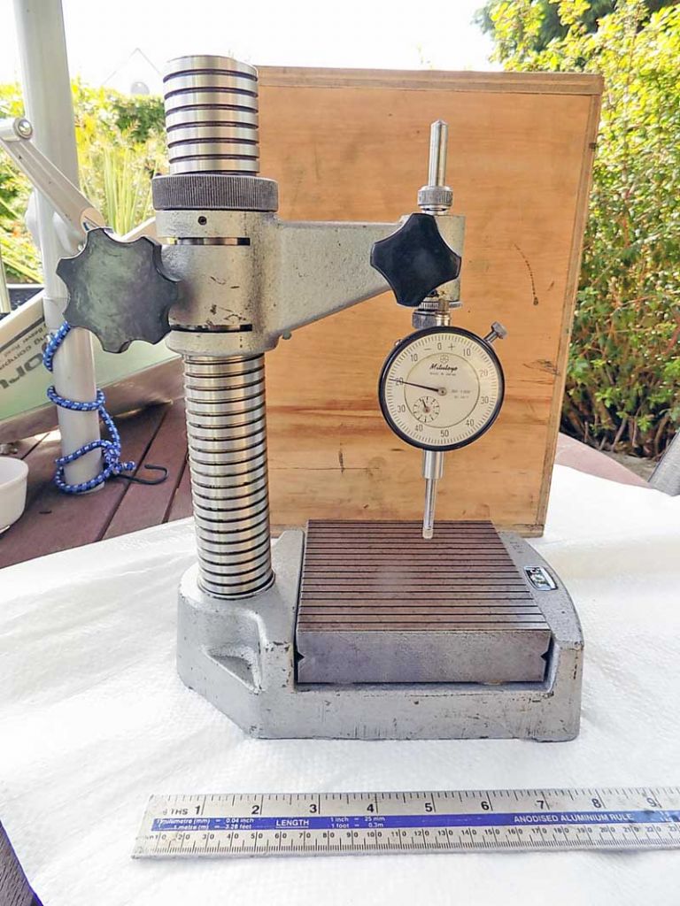

      Hi All, Got this today at my local car boot along with a lot of other instrumentation.
      To avoid mis describing it when I list it could someone please tell me the correct name for this nice item. I THINK it is a Comparator Table for checking heights etc but do not want to get it wrong.
      Regards, Martin

        #368050
        Brian Wood
          @brianwood45127
          Yes Martin, quite correct, and very nice too.
          Regards
          Brian
          #368077
          Howard Lewis
            @howardlewis46836
            Yes, a Comparator.
            Presumably the clock reads in tenths of a thou, or an equivalent metric increment?
            Unless it has been abused, or is worn, it looks to be a good bargain. Lots of envy from us watchers, no doubt.
            Now you need to find a set of slips (Jo Blocks as some call them) to be able to set it up to whatever dimension you want to check. Unless horribly worn/abused, even if they no longer "Wring" together, they were made to a level of accuracy greater than almost every one of can measure, let alone match, (millionths of an inch).

              Brian & Howard, Thanks so very much! Of no use to me so onto that auction site!

                Have you considered that it could be converted to a hand tapping machine ?

                  We sold a couple to a local cannery in the 50's, used to check height of bottles and tins against a master copy. Sadly the cannery has long gone, and now is a housing estate, like so much of our industry.

                    Sacrilege to turn a precision instrument into a drilling machine derivative. You can make a Tapping Machine from some pipe fittings (Tee pieces)
                    Would you use a Rolls Royce Silver Cloud for ploughing?
                    Martin,
                    Are you sure that you will have no use for it in the future?
                    If NO, make sure that it goes to someone who will respect it and use it for its intended purpose!

                      Howard,
                      Whilst I admire your attitude of respect … The sacrilege might be very small, and entirely harmless; depending on the size of tapping involved. … How much harm would a watchmaker or scientific instrument maker actually do to this stand ?
                      Just for design inspiration [should anyone be so inclined]:
                      https://www.hswalsh.com/product/bergeon-16200-bushing-tool-swiss-made-clocks-and-alarm-clocks-hb72
                      http://www.nielsmachines.com/en/bergeon-6200-clock-bushing-tool-set-35411651.html
                      Edited By Michael Gilligan on 19/08/2018 21:20:37

                        Whatever you choose to do I think the knurled ring should be below the DTI mount, used as an aid to lower the assembly, with the knob released the weight will allow the assembly to fall.
                        + 1 for a tapping device.

                              I do admire the way the design separates the pillar guidance from the clamping action.
