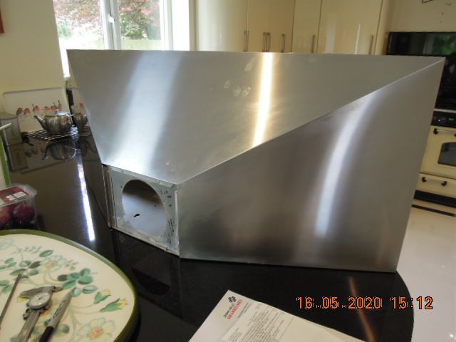

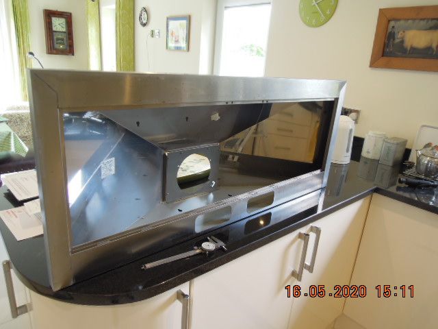

        I'm continuing to make improvements to my horrible 'Luxair' cooker hood. I have already moved the fan unit outside along with hopefully most of the noise and vibration. Now I want to reduce the structural vibrations of the oil-drum-of-a-hood. You can see it in the pics below:-
        I was thinking of gluing some 3/16" plywood in to the insides to stiffen up the large surfaces. But I also like to try to absorb some of the higher frequencies coming through the airstream from the external fan. I suppose I could try drilling a million holes in the plywood but if I can buy some stick-on material that has a proven effectiveness I think I'd prefer to go this route to save time. (I'm already being warned that this job is taking too long )
        So, does any one have any experience of a stick-on material that will stop panel vibration, acoustically absorb and is obtainable in a 'domestic' quantity please ? mmmm …as I write I'm thinking such a thing might quickly get clogged with grease….

          Just stick on some hefty metal disks, they should drop the resonance enough to stop the drumming.

            Maybe something like this Ebay
            You can get similar from motor factors too

              You could use anti drum stick on panels like the ones found inside car doors not foam, but that would depend on how they withstand the heat.

                  Thanks for your comments chaps ! I have some lead sheet so I will place some of this in the centre of each panel and will cover over with some Adrian's acoustic sheeting. Perfect !

                            There shouldn't be much direct vibration coming into the hood as the fan unit is now reasonably isolated on the outside wall. But the hood is a shockingly flimsy thing and it wouldn't take much to set it off, so the lumps of lead should take care of that. At the very least the lead will stop it sounding so 'cheap and narsty' when you press the buttons to switch it on, set the speed or turn the lights on.
                            But there is plenty of airborne white noise coming down the pipe and when that gets into the hood it will just bounce around and be focussed down to the cooker methinks. I'm hoping that the acoustic layer will take care of some of that. I probably need a to put a horizontal baffle in front of the exhaust port too, thinking about it.
                            This project is very much suck-it-and-see and with hindsight I should have perhaps gone for an even bigger fan but as they say, experience is all about mistakes. I could still come back to that later when I run out of things to do!
                            Adrians acoustic sheeting is 'said' to be suitable for engine bays so hopefully it will have sufficient temperature resistance and the aluminised coating will make it cleanable to a degree. If not, I can rip it all out and think of something else.

                                          Gerry, you may find that adding more localised mass isn't particularly effective with sheet metal, the best construction is to sandwich a dampening material between two sheets, though you may well find that dampening material on its own is adequate for your needs.
                                          The mastic used for sticking car body kits on, such as sikaflex, spread over a panel at 1-2mm thickness is a low cost and resilient method of reducing sheet metal noise.
