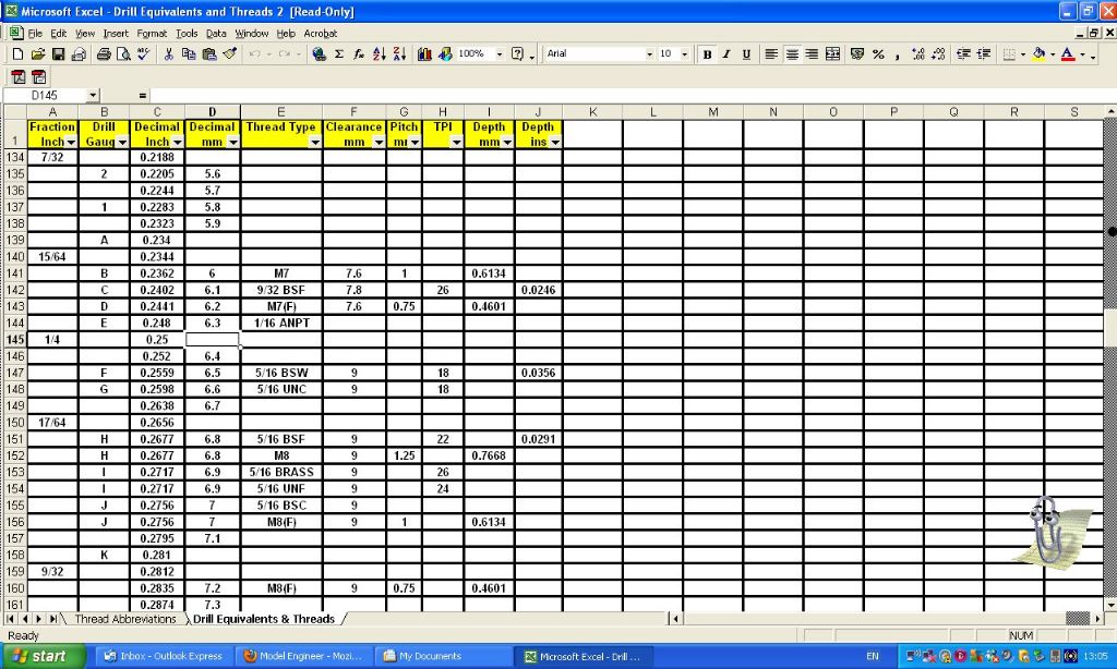

                    I use a spread sheet, it is a bit of a work in progress as I add new threads as I come across them. I printed it out on A4 sheets as a wall chart before realising it was bigger than the available wall space so I just leave it on the lap top in the workshop now.
                    Regards, Roger

                                  Thanks for making your chart available Gary. Interesting presentation.
                                  I think it demonstrates the advantage of the old printed charrts over a spreadsheet or photocopy – namely some colour. (no I don't have a colour printer or copier, even at work)
