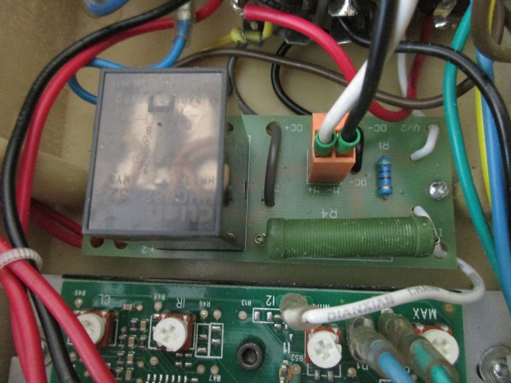

                What baffles me is that there is no sign of any damage; no scorch marks or evidence of over-heating and so nothing to go on. The only component I have reason to suspect is the speed-control pot . This has for some time mis-behaved. On occasions the chuck would idle round very slowly until I took a cut whereupon the speed would pick-up to an expected rate. With this in mind I fitted a new pot. (ref. LAT/MIL-VS-POT) No difference! The machine is still inert. The motor is ok and runs well on 12volts from a battery-charger (as suggested by a contributor to the site) but it's not getting voltage from the control-box.
                One question, please, before I lash out on a new PCB – (A57481). What is the other smaller board adjacent to the main board? Could that be the cause of the problem? Because the motor is connected to this board I wonder if it's the transformer.

                    Hi Graham Read 1, if the board is the same as the one shown below, this is a relay that is powered by the forward/reverse switch when the E-stop is released, this will supply the power to the rest of the circuit. You would normally hear it clicking when releasing or pressing the E-stop button or switching from forward to reverse or visa versa. The other two items are resistors, but I don't know exactly what part they play in the circuit.
                    I suspect your problem is most likely the main board and the semiconductors on the ally heat sink don't often show any outward sign of failure.
                    Regards Nick.

                      Thanks for that Nick. That takes me a few steps closer to the decision to renew the main board. I just have a reluctance to fork out £100 to solve a problem caused by a £2 component.
