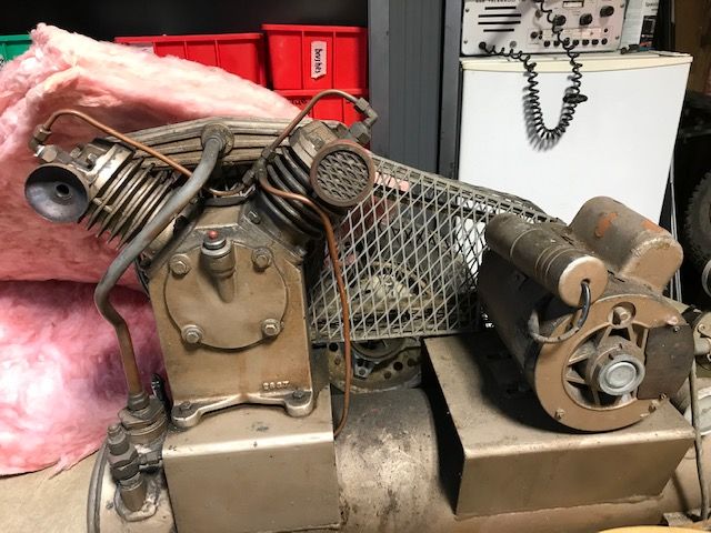

      Hi all,
      I recently got an old belt drive air compressor.
      It woks well, reasonably quiet, but when it hits maximum pressure the motor does not shut off.
      It sounds like the compressor stops pumping and the motor isn’t working as hard, but motor keeps running.
      There’s no pressure switch to shut down, just a valve to adjust output pressure.
      Is it just a matter of fitting a pressure switch in the line somewhere?
      My knowledge of air compressors is very limited and I previously thought the motors always switched off when maximum pressure was reached.
      ThanksCompressor

          Sounds like it has some sort of unloader valve.
              Sadly no, it's not designed for it. You would need to insert a modern unloader in the large copper pipe and the pressure switch will need a new oulet from the tank + the old system may interfear.

                  Hi Grotto, I agree with Bernard Towers about an unloader valve, these were often used in industry where they could/would be running 24 hours a day all week, where a plant would require a high demand of compressed air, the idea means that a fairly stable air pressure could be maintained, with the continuous time of use.

                    this looks like a commercial machine that hardley ever switches off….old style……
                    not sure about the electric side of things but the big fitting on the bottom of the copper pipe looks like a non return valve…….
                    a standard on/off pressure switch, the hiss u hear when it shuts the motor down is unloading the pressure from the comp down to the non return valve…..
                    that way the motor will start without pressure in the system……
                    personally I'd try a new type switch…..less tha £20…..
                    just have to get a couple of new fittings so that u can use the switch and the saftey valve from one tank fitting / port….
                    the small pipe are the unloader valves…..won't be needed with the new switch…….

                        Just a guess but I notice the heads have an air intake at the front, and connect to a shared outlet manifold at the back, which then connects via a big pipe to what could be a non-return valve on the receiver. In addition both heads have thin pipes leading to the top: I suggest these move a valve that directs air back to atmosphere rather than compressing it into the tank. The higher the pressure in the tank, the more air is escapes back out the inlet, greatly reducing the load on the motor.
                        Not an efficient set-up, but it allows the motor to run continuously which is good for reliability because frequent restarts are bad for single-phase motors. I think the compressor is either designed for continuous operation or it predates electrical motor control. Another system uses a clutch to disconnect the pump from a continuously running motor.
                        I wouldn't attempt to modernise it: if it works leave it be.

                            Small continuous run compressors fitted with unloader valves frequently use relatively small motors that don't have sufficient power to start against a pressurised tank. Motor is fine running up to pressure but doesn't have the oomph to start it under load.
                            To convert it to  motor start – stop operation you will need a modern pressure controlled starter switch with an outlet vent in the off position.
                            Easy way to set up is to add an auxiliary tank / manifold to the outlet side connected to the tank via a non return valve and vented via the pressure switch. When the tank reaches the set pressure the motor turns off and the manifold vents down to atmospheric pressure so there is no back pressure when the motor restarts. Auxiliary tank / manifold doesn't have to be very large. From memory the outlet collection manifold on my Atlas Copco KE1 16 cfm rated Vee twin was around 3" diameter and a bit over 1 ft long. Plenty big enough. Your compressor looks smaller so maybe your manifold is large enough as is.
                            Swanky way is to add an electrically controlled valve between the tank and the unloader valves in place of the existing pressure controlled valve. Use a time delay relay to open the valve for a few seconds when the pressure controlled motor switch kicks in.
                            I have a PDF of the KE1 manual with the basic details on how continuous operation and starter pressure switch unloading is set up on commercial machines. PM me if you'd like a copy.
                            I simply vented the manifold and the KE1 worked fine. Far as I know it's still going strong 3 owners and 20 years down the line. I'd have heard if it broke!

                              What Clive says, but you really only need to "Tee" the normally open depressurising (unloading) valve into the large pipe between compressor and tank. The pressure switch can be connected to the tank port with the small pipe that currently feeds the pneumatic unloaders but you will have to remove the existing pressure regulator in that line.

                                  I initially got too clever with the KE1 and tried some over-engineered things to replicate the electrically controlled unloading valve system that didn't really work reliably. Probably 'cos I was too tight to buy proper parts and attempted to use "obtained" or "found" things that "ought have worked".
                                  Ended up reverting all the unloading valve and pressure control switch connections to standard and fitting a £5 from Machine Mart non return valve directly to the tank inlet.
                                  As bought the system was set-up for continuous run so had no non-return valve in the tank inlet.
                                  Started out by simply fitting a small bleed hole to the manifold which worked fine taking about 3 minutes to bleed the manifold down. But the hiss was annoying. Then a a compressor savvy friend told me that the £15 from Machine Mart pressure controlled starter had a suitable bleed port built in so 2 ft of tube and couple of compression fittings later the hiss was history.
