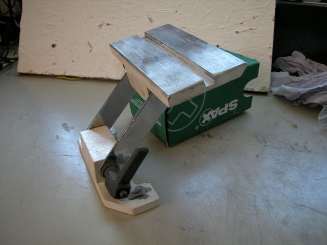

                    This is mine :-
                    Fundamentally the same as Jons but somewhat less sturdy. I fully expected that the side arms would need replacement with something rather more sturdy but under £20 for a finished casting kit complete with bristol handles was still pretty good value. In the event its fine for tool sharpening duties. Especially as I use the side of a white cup wheel which is rather less stressful than going in radially on the usual grey wheel. I'd want something a bit more engineered for roughing out but I do my roughing with a 1 mm cutting disk and angle grinder. Alloy top is a weakness as it abrades rather easily, mine is about due for re-skinning with something a little more robust.
                    Clive

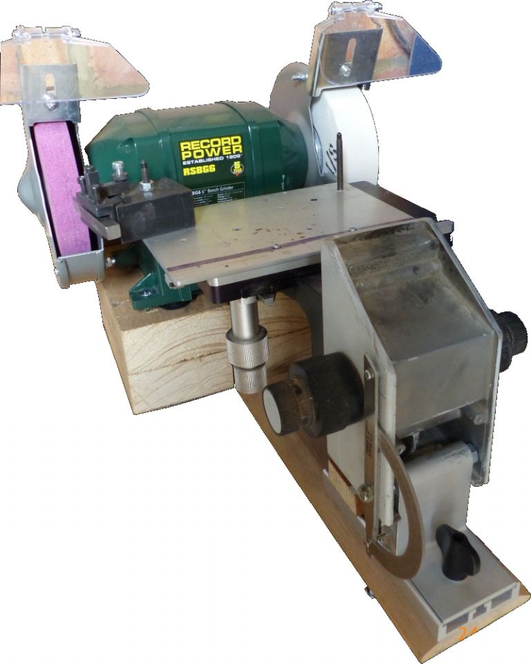

                            #323291
                            Colin LLoyd
                              @colinlloyd53450
                              As an update to this thread, I've made a grinding stand using one of 3 Leica Microscope stands I bought from a local scrap yard for £6. I've cut the upper microscope arm off. Even so it's still very heavy and provides me with vernier movement in all three orthogonal directions. The whole arm then tilts in the forward direction towards the grinding wheels (with protractor angle setting and sideways tilt is provided on the base with simple threaded jacks either side of a central knife-edge. The blank HSS tool is then held, on what was the specimen table, using my lathe quick-release toolpost. Seems to work OK and, although a little over the top for experienced machinists provides this grinding novice with fine control over the grinding process until I get more experienced. As this is a "proof-of-concept" build – there are various parts in this build that I will replace especially the wooden base to the grinding rest.grinder_rest-small.jpg

                                  Posted by Neil Wyatt on 24/10/2017 18:06:42:
                                  I bet Clive and Michael G. are having kittens at teh thought of someone butchering a Leica scope base, whatever it cost!
                                  The other two2 are fine – one is set up as the stand for a digital microscope and the other I've adapted to copy 35mm slides using my DSLR positioned on the Leica table.
