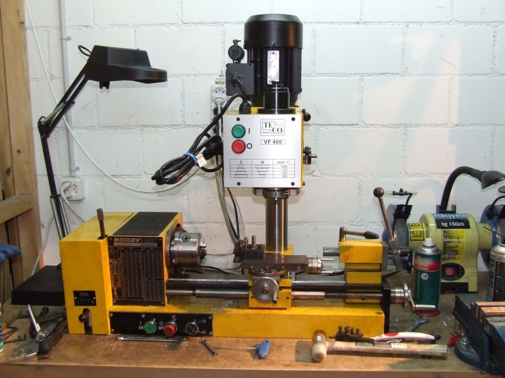

                                          I started out milling with a vertical slide on the lathe. This worked but travel was limited and setting up was not aided by gravity. Like you I do not have space for a separate mill so I added a milling head. This is certainly a compromise and is not as rigid as a true milling machine, but by removing the lathe chuck and tailstock it has quite reasonable travel for my use. An up to date Hobbymat and TECO mill are available from Pro Machine Tools.
                                          Best regards
                                          Roger
