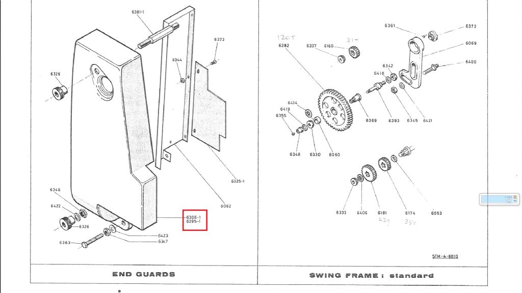

        I have a Colchester Student Mk2 lathe that will need a full tear down and rebuild along with sourcing several parts that are missing.

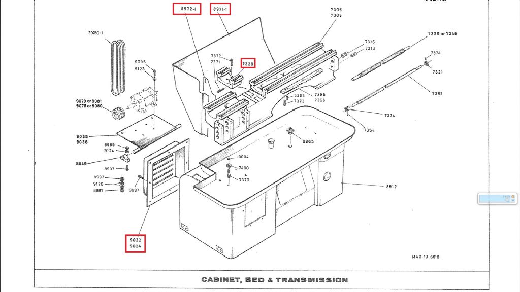

        From everything I have read the serial number should be stamped on the tail stock end of the bed where I have circled red in the photo, however even after scraping the paint there is no number here. I am guessing I am looking in the wrong place. Could somebody tell me where I should be looking please?

        in the attached image you will see the cover is missing from the left hand side. What is this cover called please and can you please recommend some different places I might be able to source one.

          Thanks to a private message from Mark I found the serial number under a thick layer of grime.
          FC2/72536
          So from **LINK** it looks like its a 1970 model.

            Hi Gareth, my machine is no. FC2/76259, so probably one of the very last Mk. 2s to be made. The manual refers to the guard as being a Belt & Change Gear Guard. Regards, Alain

                Millhill Supplies say the have lots of Colchester spares, the cover you are missing I am sure was made of fibreglass so if you can't find one it should be possible to make one especially if someone could loan you one to use as a pattern.

                  4mm mdf sheet, sme P38 body filler for the fillets, and a covering of 250gsm woven glass cloth and West 105 epoxy resin will make a good cover.

                              I’m looking also for the cover from the left hand side that Gareth is missing too.
                              Any news or helps ?

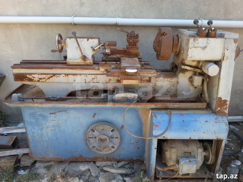

                                old colchester .jpgGood afternoon to all participants of this forum. I'm glad there is such a forum. About three years ago I also acquired this miracle. I want to share photos.
