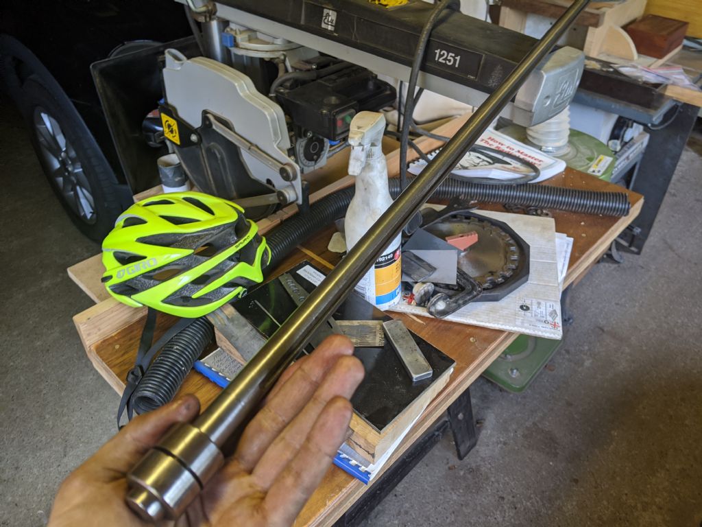

      You said: "The shaft is actually very tight in the hole, so a very good alignment is required."
      Look at how this guy uses the angle iron to align the two pieces and you will get the alignment. You can also add another piece of angle iron on the top if you like and make four holes in the angle to allow you access to the shaft where you can do the initial four brazing spot joints.
      **LINK**
      Do not look at how he smooth it out. Use your lathe to do that!
      Yes, blinging wants a smooth surface to start from…. So I use the single cut file to remove all the dings, then onto the 180 grit up to 800 grit wet sanding paper. Or you can use a non-woven abrasive wheel on a pencil grinder for the very hard cast iron of the hand wheels.

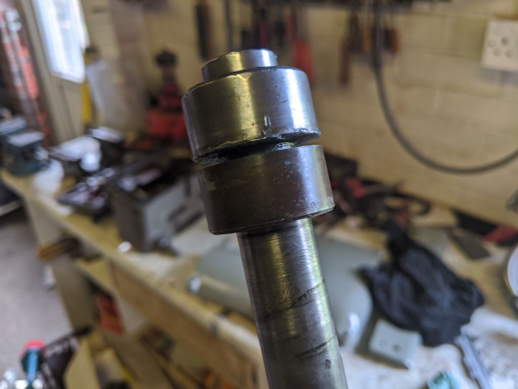

        Blinging complete for the apron. Not immaculate, but more than good enough bling for me
        I did an example brazing joint set up. This is how it will be clamped when it is being brazed. It still needs chamfering of course, but as you can see the break lines up very nicely and should provide good registration. But it depends how far I chamfer it. As if I chamfer it too far, I will lose some of the broken grain so it will not register as nicely.
        I'm not too sure what to do next. The pieces I have painted are good enough to put back on the machine, but not final finish quality. They need sanding down and spraying, but It could save time as they are useable now. Then I could spray more next summer when I do the rest. Then I have more time this summer. Only 4 weeks or less till uni now! So I need to get on with some actual production!

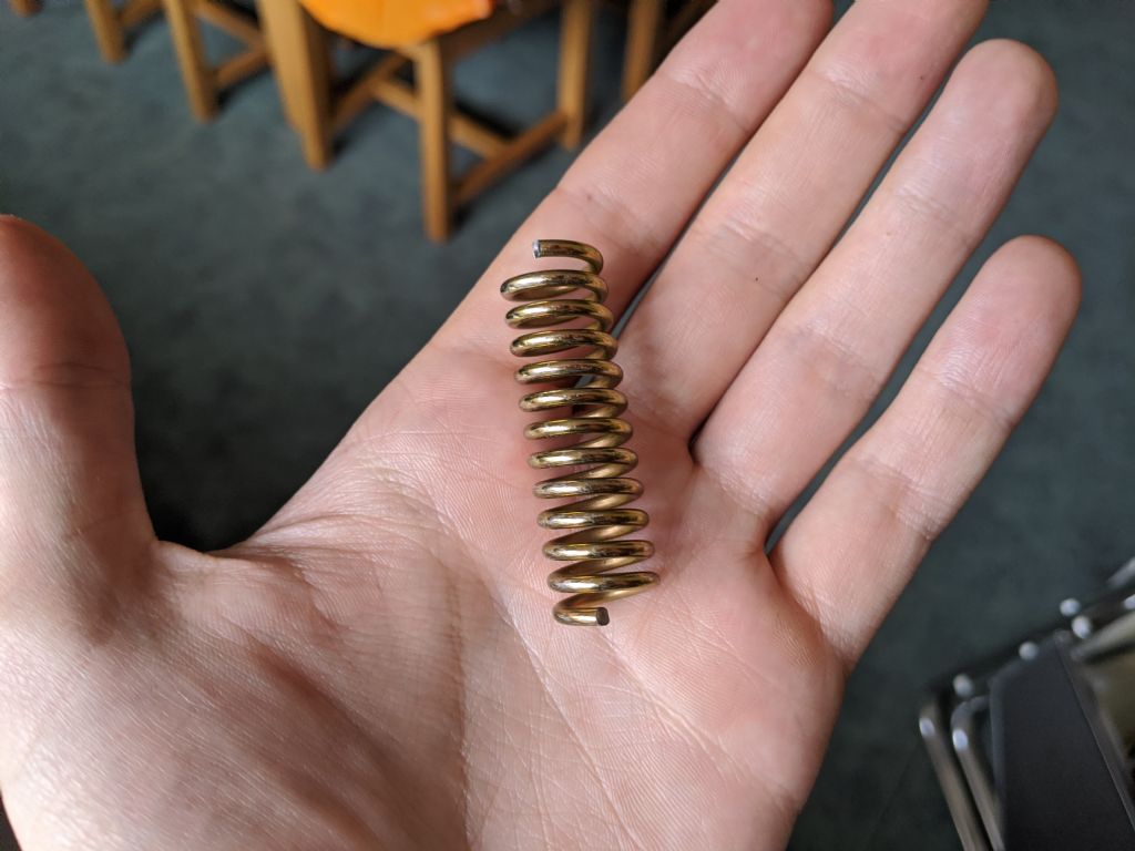

          Okay so I'm looking at spring and I'm really struggling to find any companies or anything that will send me just one spring, without a minimum spend of about £15 inc postage, which seems a bit much for one spring as I don't need any more.
          So I've resorted to finding one of a similar size on ebay, however, that's also very tricky for me.
          Looking at springs I've managed to find a listing for some compression die springs, which seem to be of a size that would fit. (i got my sizes from my current spring then used Hermans pictures for scale) So I know it needs to be around 15.5-16.5mm OD, and about 38mm long
          So, could I use one of these springs, and if so, what colour iso standard would be appropriate?
          I have a choice of light, medium, heavy or extra heavy. And I have no idea! Even Rs doesn't have what I need
          Spring link

            Posted by Richard Kirkman 1 on 11/08/2020 13:44:04:
            I spoke to Brian today when I collected the new bolt assembly he made form me for the travelling steady. He said the only way to do the brazing is with the angle iron. He can guarantee you that your idea with a central rod will not work.
            You will need to add an extra clamp between the two smaller G-clamps pulling in the opposite direction.
            Brian also said the sequence of brazing is as follows:
            1. Chamfer down to maximim. Do not worry about the ends registering on the broken bit as this does not matter. Your alignment is on the external face of the rod(s). Make sure these are super clean and the inner face of the angle iron as well.
            2. Heat all pieces up till it is red hot. Not cherry hot.
            3. Tack in four places.
            4. Heat and tack, rotate
            5. Heat and tack, rotate
            6. Do so until your level of brazing is at least 1/4" above the surface and a constant smooth equal width brazing.
            7. Heat till red.
            8. Let it cool down slowly. You should wrap it in a welding blanket if you can and leave till it is cold. If you do not have a fire or welding blanket you can cover the hot part in ash or fine warm sand. Warm the sand in an oven till about 180C before using. A steel drum or bucket with a layer of sand in the bottom, then the part and then more sand. You will need about 300mm all round the part.
            9. Turn the shaft to size.
            10. Drink a beer.

              I will measure my spring. I could not find it this morning.
              My gut feeling is that you can wind your own spring from piano wire. I will check what the K factor is of the one I have.

                      Anyway, I did the calculations, just like in first year A Level Physics. Bad memories. I'm having flashbacks
                      I was a little confused as I wasn't sure how to do this in imperial values such as pounds and inches, so just went for the metric I'm used to
                      Hooke’s Law
                      F=K*X
                      Pounds to kg
                      10/2.205=4.53592Kg
                      15/2.205=6.80389Kg
                      20/2.205=9.07185Kg
                      Kg to Newton
                      4.53592*9.81=44.4973752N
                      6.80389*9.81=66.7461609N
                      9.07185*9.81=88.9948485N
                      X values
                      38.44-30.1=8.34mm=0.00834m
                      38.44-28.02=10.42mm=0.01042m
                      38.44-26.02=12.42mm=0.01242m
                      K=F/X
                      K=44.4973752/0.00834=5335.41N/m
                      K=66.7461609/0.01042=6405.58N/m
                      K=88.9948485/0.01242=7165.45N/m
                      Average of 6302.14N/m
                      Now, my only thought is that it's meant to be a spring 'constant'. And if I have to make an average, then it definitely isn't constant. Thank you for the spring measurements Herman, even if I may have butchered the calculations. I did get a D in physics…

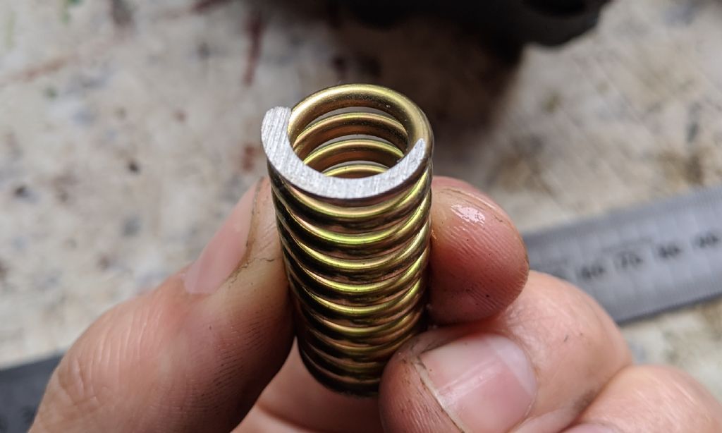

                                  It's pretty hard to make springs using a lathe when the lathe is in pieces. Meanwhile here's one I made earlier…
                                  It's currently at 50mm, so I will cut it to the correct length and bend the ends to be flat(ish) then grind some flats so it fits and mates nicely. No complaints from me, that's what I'm doing. It's only a spring.

                                        Successfully cut and ground to exactly 1.578125 inches, to the nearest 0.00001. It is absolutely imperative that this measurement is met perfectly. Otherwise, the lathe will refuse to turn on and you will be left with a pile of scrap
                                        I managed to fit this quite easily. It was much stronger than the old spring, so hopefully, the lever should engage with a stronger click and feel even more satisfying. Only time will tell, but from first impression it seems better

                                              I think the new spring is going to work well. It's thicker than the old one and actually the right length. I look forward to trying it out one day…

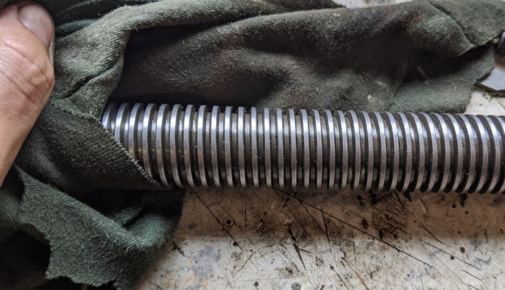

                                              I started by taking all of the parts off and filing down all of the burrs and knocked up edges, so all of the edges that have been abused look nicer. Then I went over everything with a very fine satin lap mop on a buffing machine, then used a rough buffing wheel. I didn't see any point buffing any of this to a mirror.
                                              The brown on the end was how it all started
                                              There are two threaded sections, and they both did not run smoothly, so I took a triangular file and knocked down any lumpy bits, then i just used my hands to turn the nut on back and forth until it ran smoothly once again. Should make reassembling and future disassebling much easier.
                                              The collars cleaned up nicely. Although they were quite banged up, filing took care of it and it blended very well. No more abuse for them, apart from my use
                                              The satin lap mop was fantastic for cleaning all of the gunk out of the leadscrew. It would have taken a long time with a toothbrush. I couldn't think of anything better, it made the job very easy. Hopefully this will help with wear
                                              Much shinier than before, but not quite bling

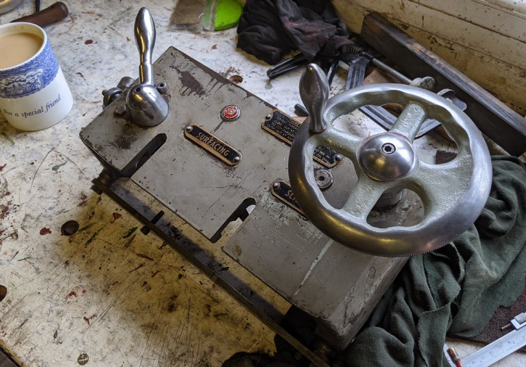

                                              I also put the hand wheel on, and it looks much more fitting than the old one.
                                              I'm pretty much ready to reassemble now, but I can't until I have the half nut repaired! Once that's done, it can all go back together

                                                Great job! Especially the cuppa .. Brain loves it. He thinks he is the special friend!
                                                #490581
                                                Richard Kirkman 1
                                                  @richardkirkman1
                                                  No coffee for me, only tea. Much better. Brain is picky
