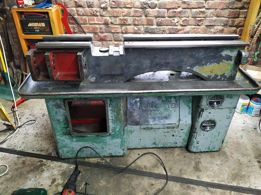

      Herman, I did use the Paragon paints colchester green, it is a bit pricy, but very good quality, it is thinned with naptha, not white spirit, and I believe this gives it better oil resistance. I used slightly less than one litre on my lathe, but I was spraying over a primed and denibbed surface, you use a lot less top coat that way, I also used the paragon thinners.

        Posted by Phil Whitley on 19/05/2020 12:29:14:
        Would you mind scanning the paint and get the code to me? You can use PointPaint if you have an iPhone or Color Grab for Android.
        @Phil what primer did you use? White or grey colour?

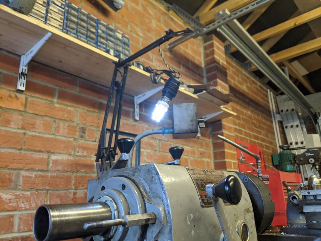

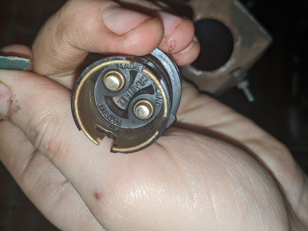

              We finally have light!!!!!!!!!!!
              It's taken a couple of months but we're finally there
              So, I started by taking the light out and checking continuity for everything
              Then I went in the cabinet and checked there. Everything had continuity and was working. Absolutely no idea what goes on or really how to check voltage.
              So, I put a plug onto the 240v to 12v transformer
              Then I plugged it in and nothing. Absolutely nothing. So, I put the multimeter to volts or something and started prodding things. It should have only been 12v so i wasn't too worried, but I was still careful.
              Then I was just playing around. I looked up and it was on. No idea what I did, if anything at all. It was running from the plug, which was great. Then I took the plug off and put everything back together. Low and behold, it still worked. Not a clue what I did or what happened, but it's now working.
              Light off
              Light on
              It just adds that bit extra lighting. Was it a lot of effort? Yes. Was it expensive for a light? Yes. But is it exactly what I wanted? Definitely as it fills the hole and remains contained in the lathe. The lamp seems to be very good and holds in place where I put it, unlike the lamp I have on my wood lathe.

                Good news. Most likely you screwed the screw of the termination block onto the sheathing of a wire and it did not touch the wire. When you did the plug thing and you screwed the wires back in, it then contacted the wire. Presto – current flows!

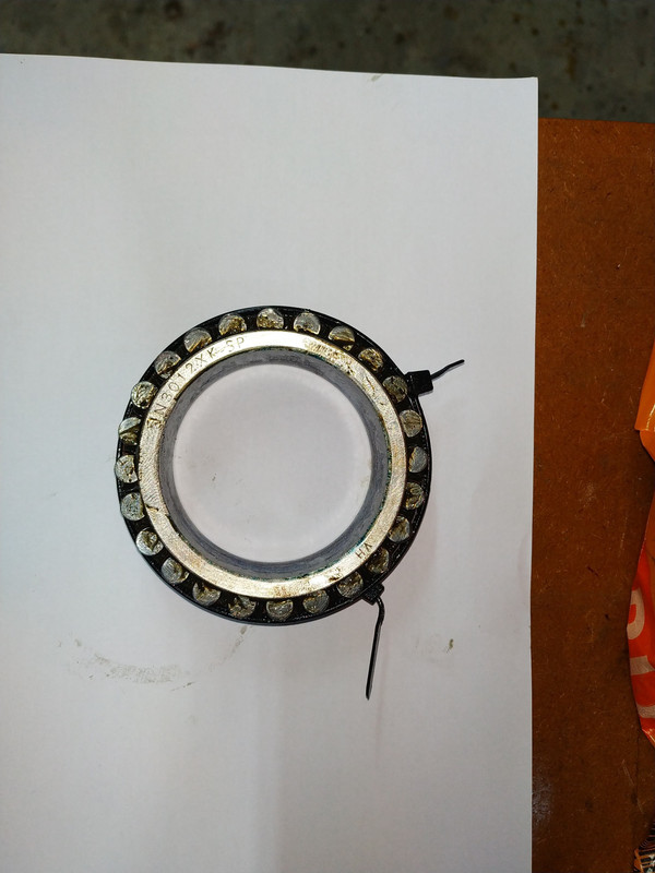

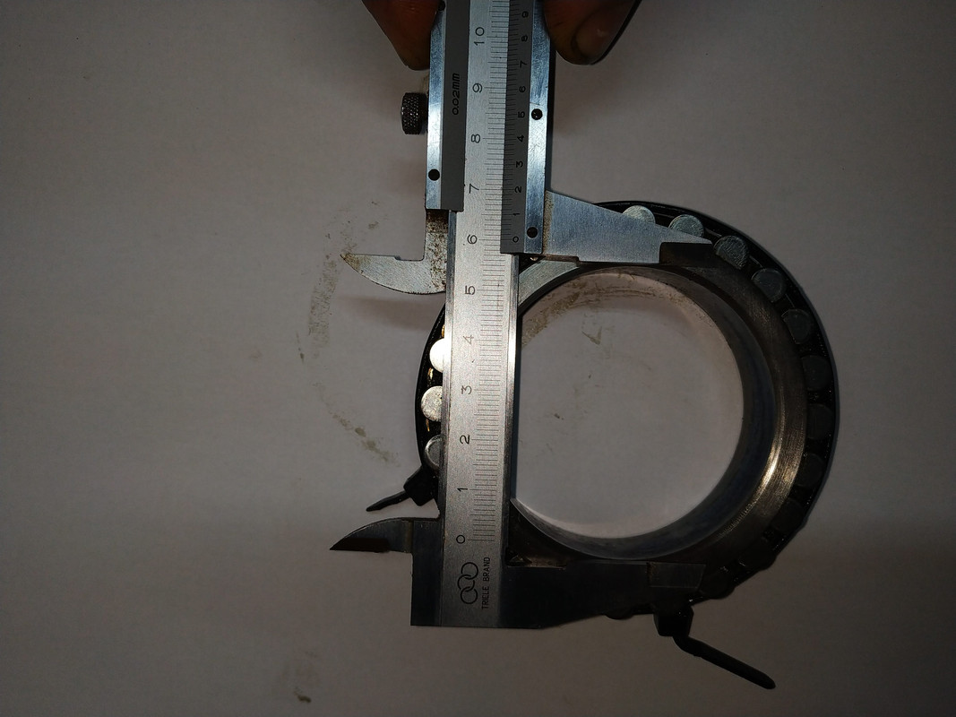

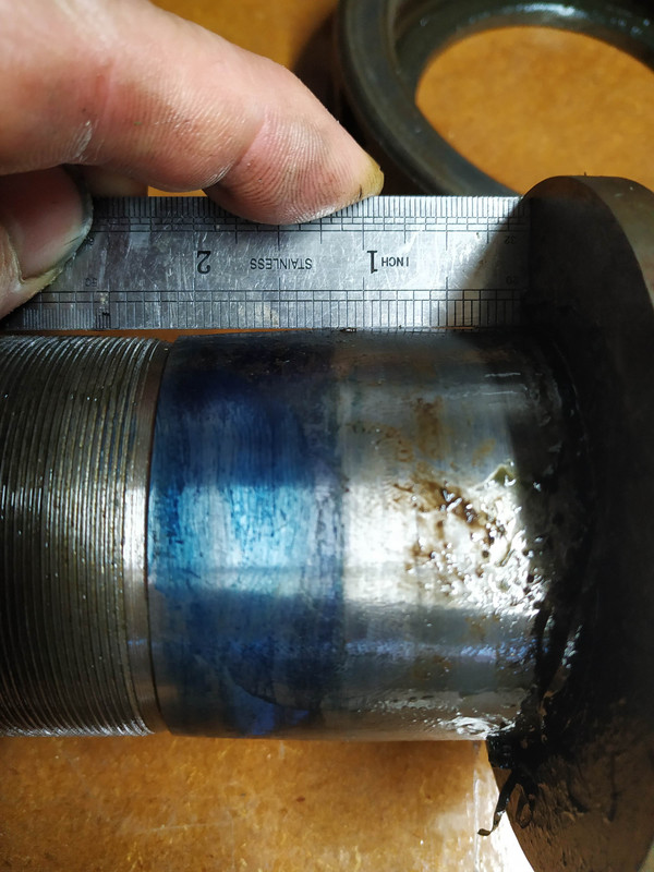

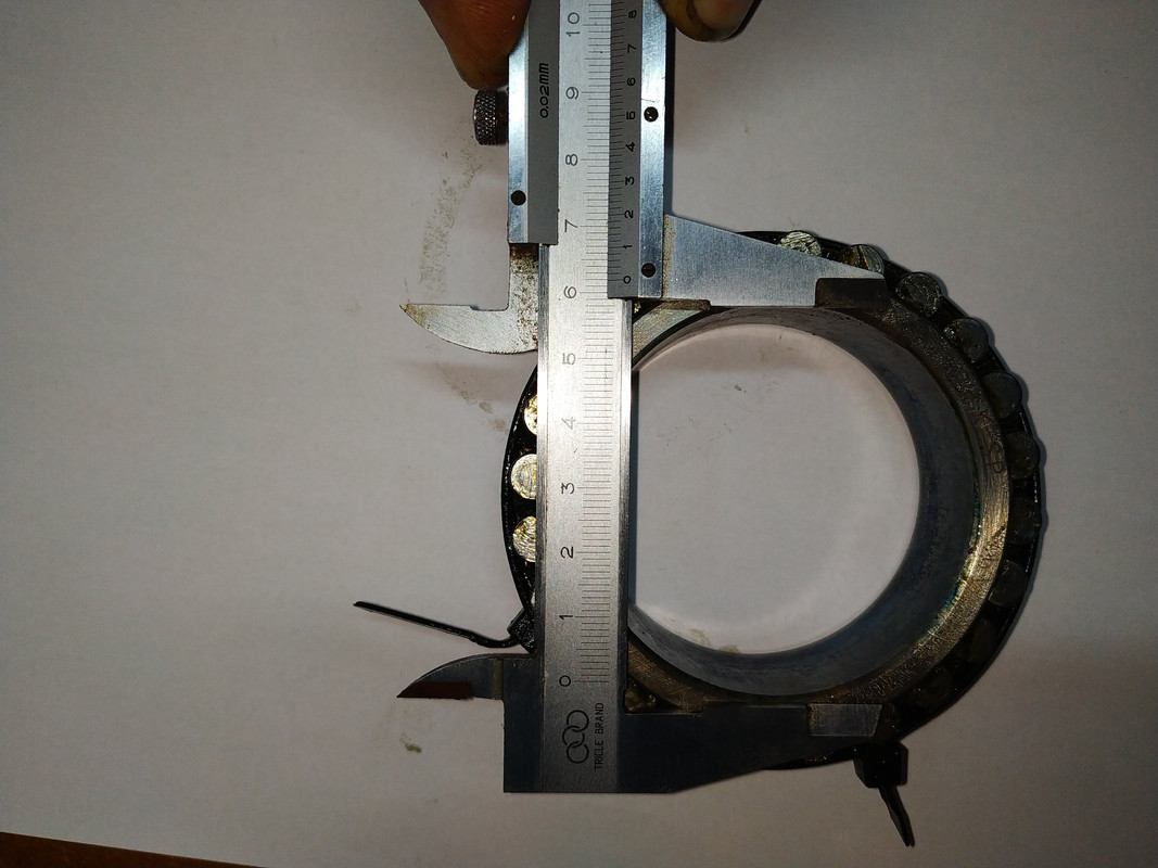

                  I also have good news. Went to a friend and we pressed the bearing off the spindle! A lot of engineering bluing on the shaft ….
                  Never seen a taper in the shaft under a bearing. Any ideas?

                    Dang, never fixate on a single thing in Engineering … the bearing is tapered on the inside as well! So that is why I could not get it loose. It locked in place under vacuum caused by the bluing or whatever it is.

                      It wasn't that. I didn't unscrew any wires apart from the 240 to 12 transformer, which was done perfectly fine.
                      I think it was more likely to be a bad contact somewhere. Most likely in the light socket. As that's the only thing that really had the most difference to it.

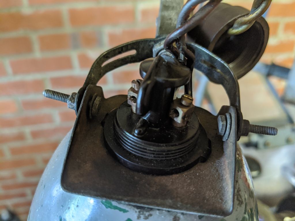

                                Yes, that is the second place I thought of. Did you sand the bulb holder's contact pins a bit to get a bright new surface? I use a nail file for this as it gives a nice bright surface.

                                  Yes, I think I'll clean the contacts tomorrow since thinking about it, they've been potentially covered in oil and things over the years. Who knows how long they've been exposed. I think that's most likely why it didn't work the first time.

                                    I think the blueing under the bearing is loctite bearing fit Herman, glad you got it off ok, the paint code for the colchester green is 135555. hope this helps, if not get back to me and I will have a go at getting that app!

                                    Herman van der Merwe
                                      @hermanvandermerwe76509
                                      Phil, what colour code would that be? BS, DIN, Pantone or one of the many others?
                                      I thought Loctite bearing fit is yellow in colour?

                                          OK, that makes sense. So yes, then it is the bearing fit Loctite. Good to know! You may have a pint on me for this info.

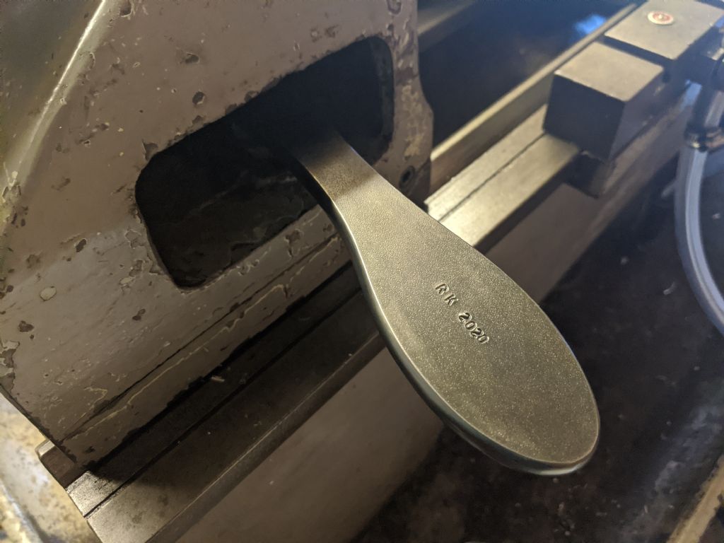

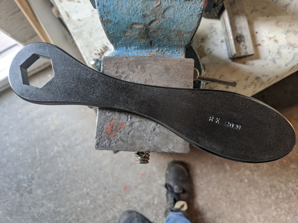

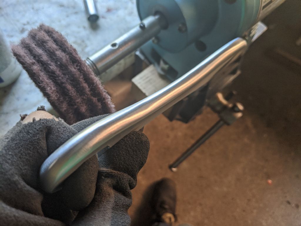

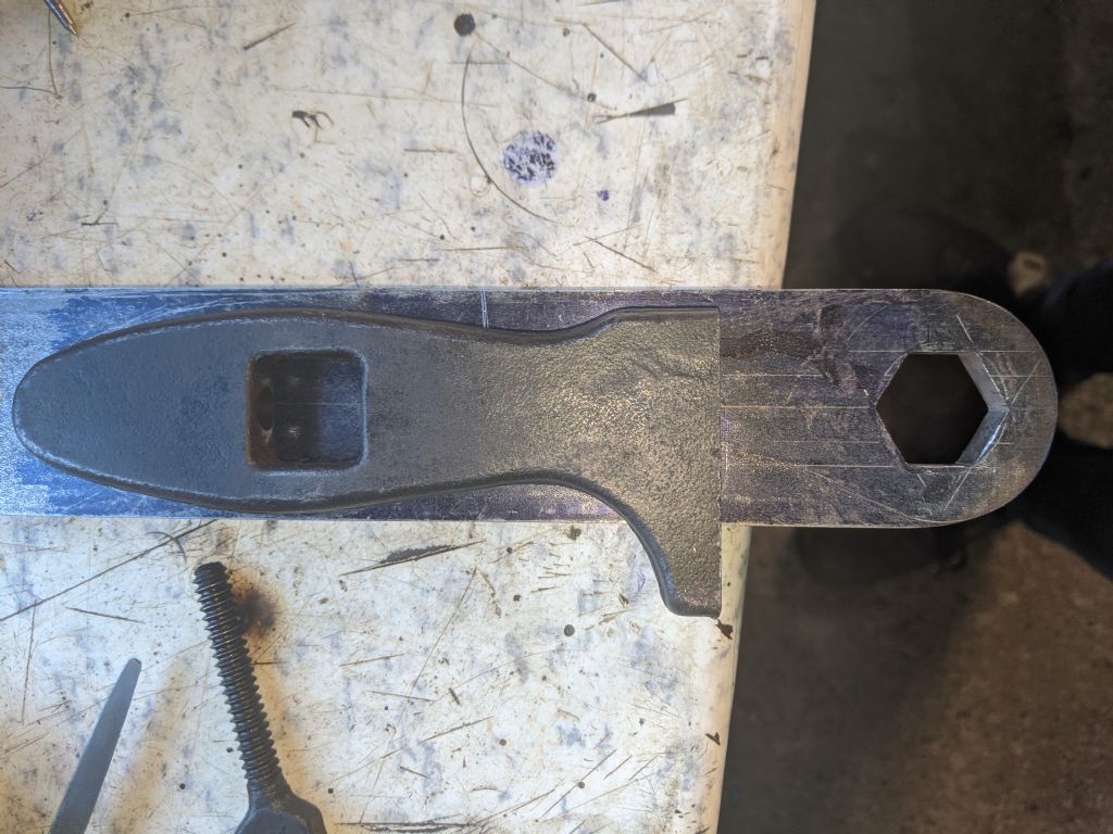

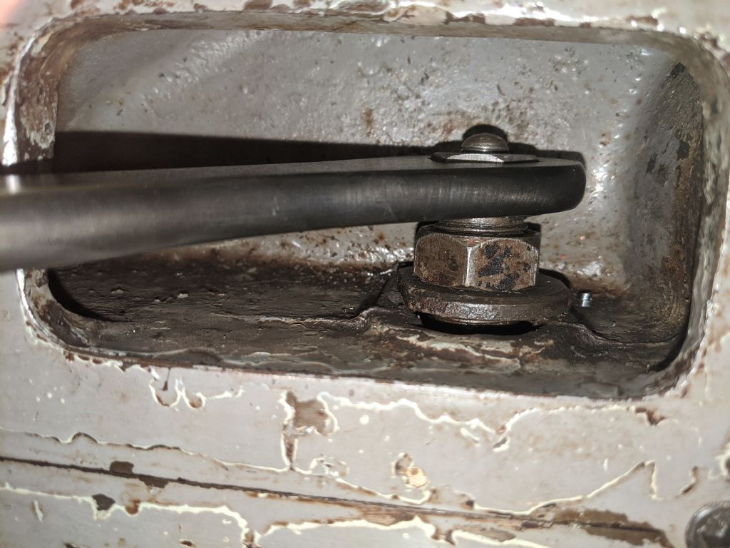

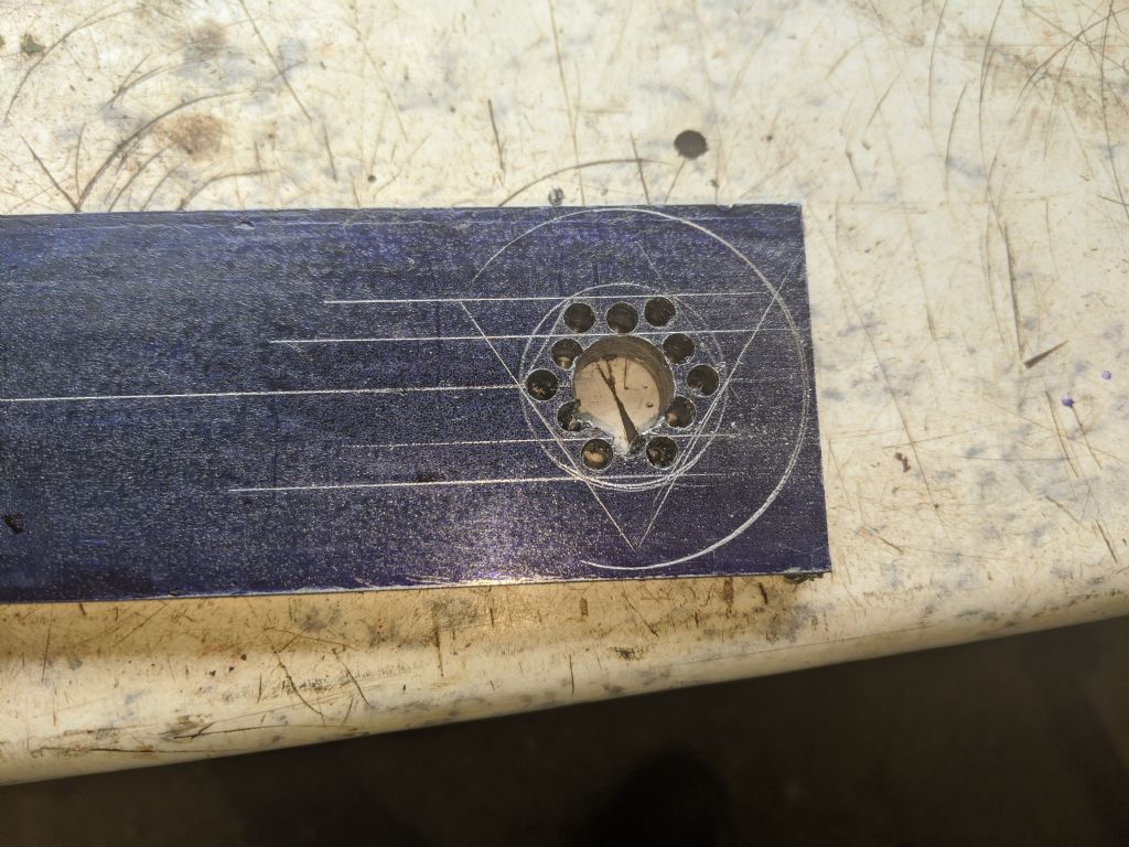

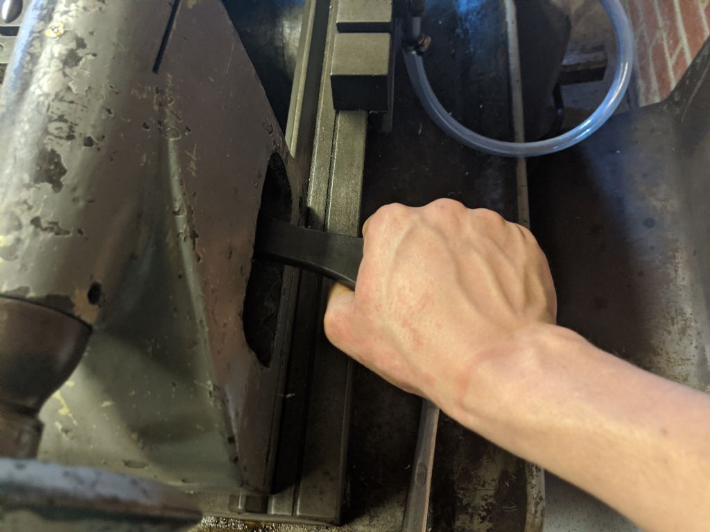

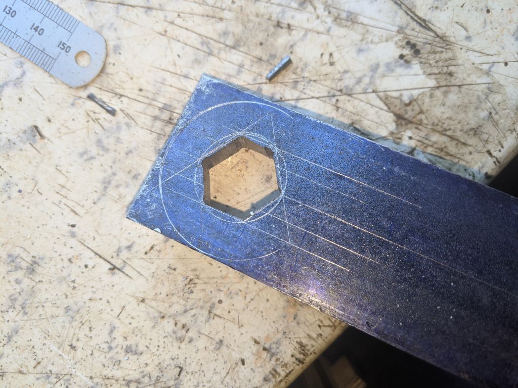

                                                I'm very impressed at your speed Herman, you seem to be getting things done very quickly. It feels like I've been working on my lathe forever(not in a bad way)

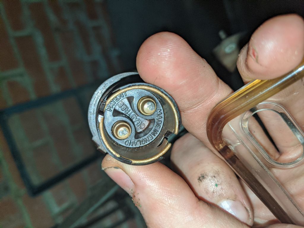

                                                Anyway, today I cleaned the light bulb contacts with a bit of 600 grit. They were definitely not clean, but now they are

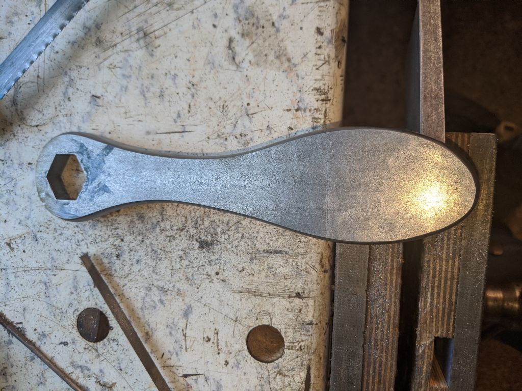

                                                Then I began work on a dedicated ring spanner for the tailstock. I wanted to make this a large spanner, bigger than the original which I have seen pictures of. So, I'm using a piece of 10x50x220mm steel I started by laying out the nut, then chain drilling and filing till I had the fit I was looking for
                                                I liked the size and shape of one of the spanners I had, so I made it a similar shape
                                                So I shaped it with an angle grinder, grinding disk, then flap wheel, then I moved to the belt grinder which I used to get to final shape then round all the edges
                                                Then I used a surface conditioning wheel to get a consistent surface finish all over, which I then cold blued
                                                Initials and year stamped in to show when this has all been done.
                                                I think its very comfortable. Not hard to find, and its not symetrical, so you get more clearance instead of it hitting the tailstock casting
                                                Finally, I added a washer to spread the load a bit better since the nut was getting marks in it.
                                                This also raised the nut so the spanner fit in a better position for locking. Not too sure how to explain that properly, but it works very well now!

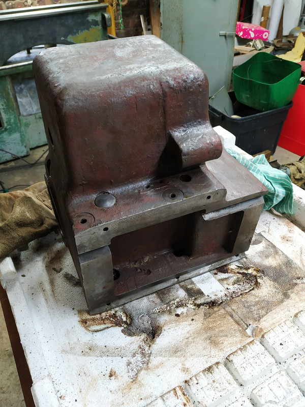

                                                Was the Headstock very heavy once emptied Herman? Were you able to lift it by yourself?

                                                    Excellent spanner Richard, really good craftsmanship, and not a CNC in sight!

                                                      I did not know how heavy the headstock would be, so I used a block and tackle to lift it. It is heavy, but I can lift it by myself with effort which I have no need to do.
                                                      Yes I got the two cap screws out. I just decided stuff this and put a very long ring spanner on the end of the Allen key and pulled. It came loose with a very load clap and the Allen key is still OK. Normally I would use a hex drive 1/2" socket, but because these are AF, I did not have the size. So an Allen key it was.
                                                      Would you mind scanning your spanner so that I can make one also? It looks impressive! You might want to harden the area where the hex hole is and drill a small hole on the other end to fit a small round chain through there to hang the spanner safely. That is the only fault I can find with it. Well done!

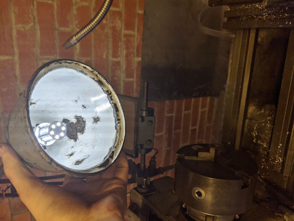

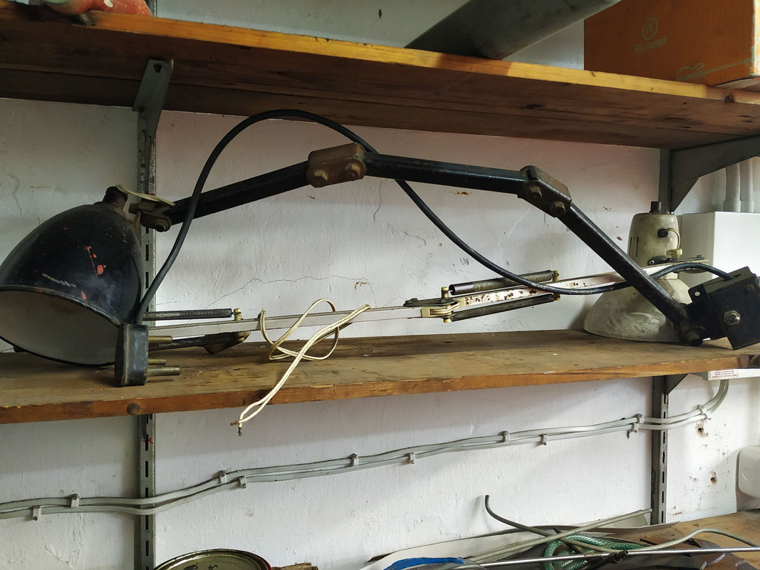

                                                      Your lamp working OK now?
                                                      I found this old lamp when I went tool hunting yesterday and thought of your lamp. Although not the correct Colchester lamp, it is from the same era and I think it will look good with the lathe!
