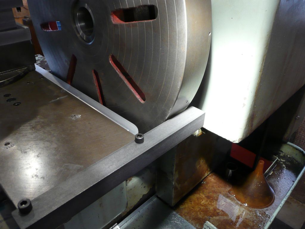

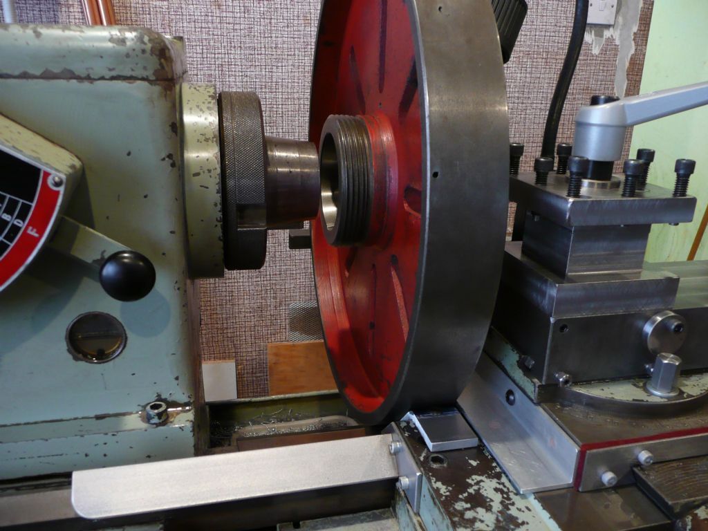

                          Large faceplates can be a challenge, too, particularly if they are being mounted in a gap bed. The Willson's slant bed allows its cumbersome 16" faceplate to be suspended between the edge of the saddle and a length of angle temporarily bolted across the back of the cross slide before being slid on or off the spindle:
