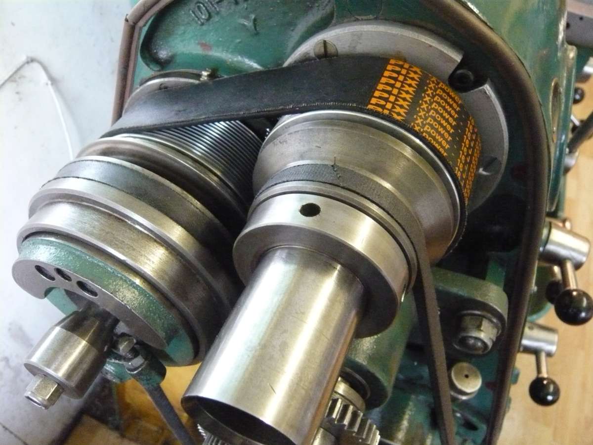

            I have just written out a long text only to find it disappeared. So here it a very short version.
            I finally found that if I tighten this nut on the end of the spindle fully tight the clacking noise I got when turning the spindle by hand or slowly disappeared. The rear bearing is spring loaded for expansion.
