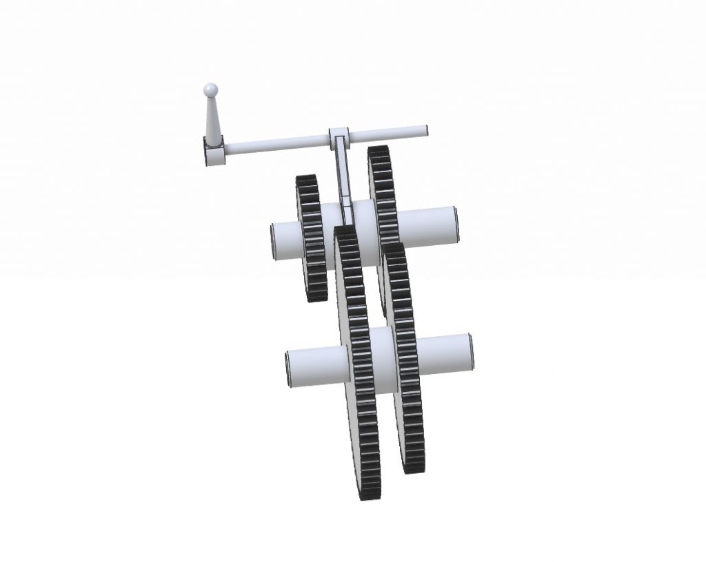

                  I'm not entirely sure what you are asking, but if I understand correctly, I have come up with the idea below:
                  hi-lo gear cluster.
                  Having nothing better to do while waiting for the new sofa and armchair to be delivered, I set about designing a Hi-Lo speed gear cluster, based on your dimensions in the OP. The Lo ratio gears are 32 and 72 tooth Mod 2 gears, 68mm and 148mm diameter respectively. For the Hi ratio pair, I selected 44 and 60 tooth Mod 2, to retain the same 104mm shaft spacing. This gives gear ratios of (Lo) 2.25:1 and (Hi), 1.36:1. The cluster shafts are 104mm apart. No allowance has been made for running clearances
                  The gears are selected by a simple fork arrangement running in a groove on the 32-44 tooth gear cluster.
                  To my my mind, those are big gears. I imagine your lorry will be a pretty substantial size when finished.
                  Make of it what you will, or ignore at your pleasure. Kept me occupied for an hour or so, anyway.

                    Thank you for that analysis! What you have there is pretty much as I'd designed although with the two driving pinions face-to-face and between the two driven gears. That is to fit the space available and to cope with the chain sprocket being between the two larger gears. The chain dictates the layout of the gears, with the driving pinions on the end of the crankshaft. My thought is to use a selector-fork bridging the larger pinion, acting on its faces.
                    The ratios you give are as I'd calculated in the optimistic hope of the engine managing 400rpm as the prototype did. My sums give road speeds of about 2-1/2 mph using the two gears "in stock" and slightly under 4 mph. In theory…

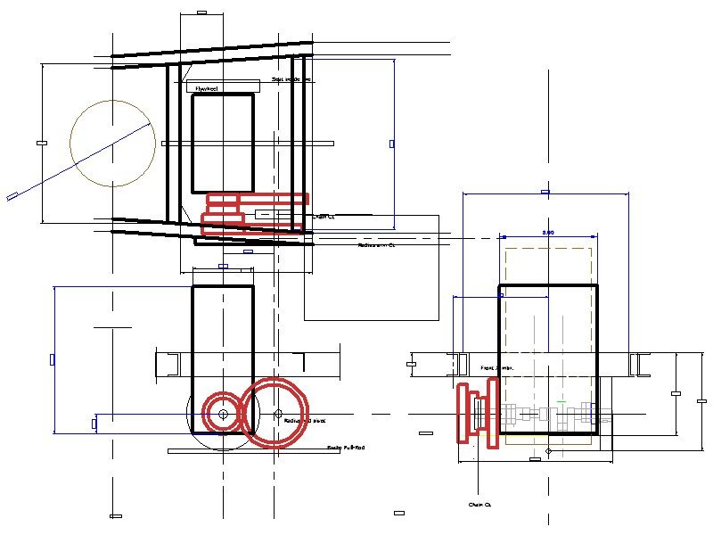

                      Not sure if this will work, or how legible it will be, but this is from the TurboCAD drawing in question…
                      The thick black outlines are the engine case and main chassis members. The thick red, the gears cited above.
                      The triangle apparent in plan but omitted from the elevations, is a part-made / provisional outer mounting-plate for the gear shafts. The chain-sprocket is between the two secondary gears, depicted by the rectangle of its basic envelope.
                      The faint brown outline is of the boiler, or parts of it.
                      Scale guide: the engine case, with the cylinders omitted here, is 8" wide by 5" front to back.
                      (The gears are shown by their pitch-circles: I cannot draw their teeth! Using just the PC plus the addendum and dedendum circles, is an old drawing convention anyway. It's in orthographic because I cannot draw anything even half as complicated as this, in 3D)
